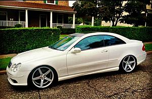

Originally Posted by mt amg
OH, btw, here's my girl and her current set-up.
Wheels: Monarch Euro 26 20x8.5 F 20x9.5 R
Tires: Falken 452 225/30/20 et32 F 245/35/20 et35 R
Suspension: H&R coilovers
Lowering: I've lowered so much here and there, I can't even remember anymore
Issues: A bit of rubbing in the rear over big dips, etc. but all avoidable with cautious driving. However, not preventable if I have a rather large passenger in front... OH, and forget putting anyone in the back seat. I've experimented SO much with this set-up and so far and this is the best yet.
Tips: Stick to 19's to maintain full functionality and save lots of $$$$ by NOT going through tires every 9-12k mi. Everyone told me not to go 20, but I'm stubborn! I love and hate it!
Car looks great!!! Reminds me alot of mine... loving the white!!
***Official Wheel/tire/stance Fitment Thread***-413204_880812602502_1372197508_o_zpsf98408dc.jpg
Originally Posted by discoduck
Damn Morgan that looks awesome.
245 up front is pretty wide, Especially at et30.
Rolling the fenders might help but I think its still too wide
He's running 245 out back... 225/30 up front.
