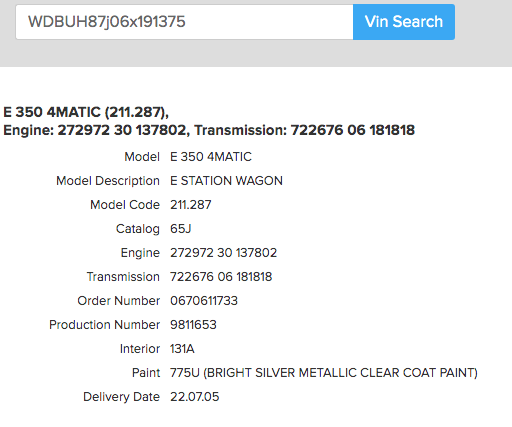

Seeking Advice on this VIN/engine number, thanks!
@Rudeney Thanks for helping everyone here Rodney and others: Just finding this thread.. years later, wonder if anyone's still active in the conversation, as I am considering a 2006 e350 wagon, yet need help to discern if the engine is potentially effected by the balance shaft issue. VIN WDBUH87J06X191375 and I just went to the site as directed, and this is the engine number: Engine 272972 30 137802 and also an image attached ... would greatly appreciate any replies!! Or fair warnings if this potential purchase is too risky. Thank you! also @xsever
Engine serial numbers up to 2729..30 468993 are affected so since your engine serial number is 137802, that means it is within the range.
