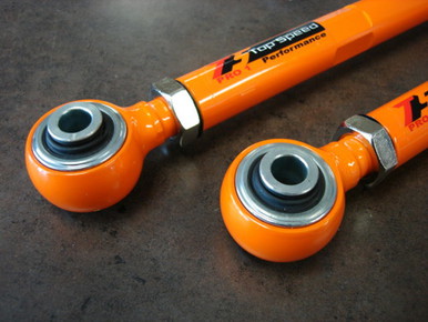

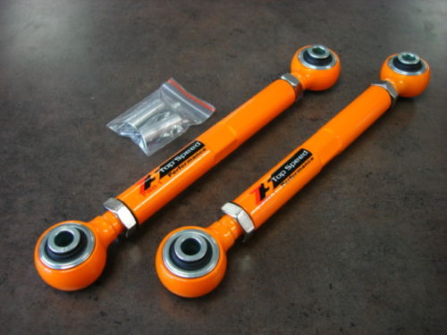

The toe is adjustable, We have the rear camber arms on sale for $198. They are solid unlike some cheaper arms that use a hollow tube.
I have them on our clk and i know other members here have these arms also
Attached Thumbnails Wheel alignment recommendations-camber-arm.jpg   Wheel alignment recommendations-camber-arm2.jpg
