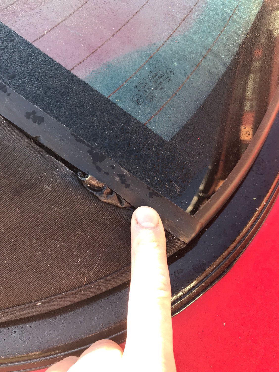

In need of some help if someone can,
ive purchased a clk convertible and when the roof retracts the material around the sides of the rear window bulges out, I’ve tried tucking it back in however soon as the roof is dropped it pops out again

That vinyl material is called the water bag. It is supposed to bulge out like that as the rear glass articulates when you open/lower the top. When you raise/close the top, it is supposed to get pulled in place behind the canvas. When it does not do that, it is due to one or more broken elastic straps on the back of the water bag that are attached to the roof frame. If you are well skilled in this sort of repair, you may be able to locate the loose straps and re-rivet them back into place. If not, it's best left to a good canvas shop.

Old May 6, 2018 | 02:45 AM
mcewan08's Avatar
Joined: Mar 2018
Posts: 9
CLK320
This is the problem I’m having, its the exterior of the rear window

Yes, it's a water bag.
Take a look at this
It's explains how to check and replace those water bag (there's a repair kit for them, I bought one for $50 it includes both water bags, in the video you will find all necessary part numbers)

OK, so that is the water bag. If it's not leaking, it does not need to be replaced. It is the issue in my post (#4) above.

yeah it’s not leaking just popping out. Do you know of there’s a guide to repairing it?

Not really. The problem is, it's almost impossible to even get a good photo of how the straps attach because there are several in a very tight place. Just for grins, take a look at this WI doc for replacing the canvas top (which includes the water bag and straps):
http://benzbits.com/w209/soft_top/Canvas.pdf
Around page 3 is where they talk about attaching the straps to the frame. If you will stop the top operation with the rear glass raised, you can then prop it up with something (I used a cardboard box) and then you can inspect the area. Look for a strap that attaches to the water bag but is hanging loose. It likely ripped off of it's rivet where it was attached to the frame.
