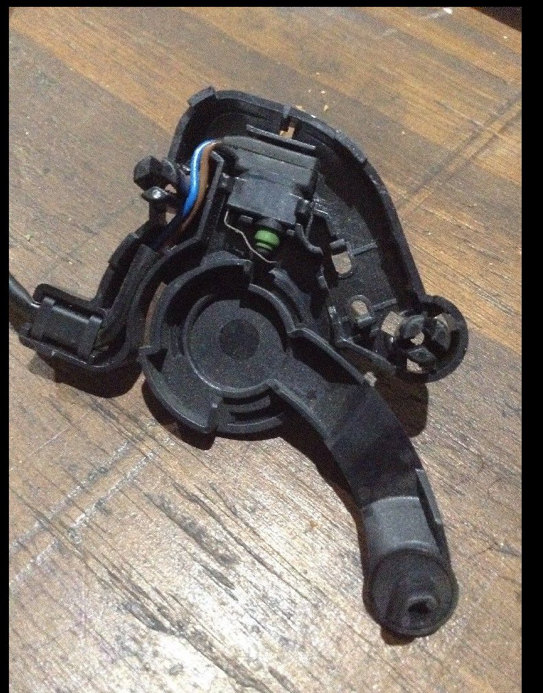

I still think it's the relays. My roof did the same as yours, it would half open, then I would close it and retry and it would open fully. A simple test for the switch S84/15. if you can disconnect the swing arm, it just pulls out off the metal bow, ( the one pointing down in the picture) and move it around by hand, you should be able to hear the switch click. Like most of the switches, if you can here them click they should be okay. Because your roof opening is intermittent, like mine was, it could be the relays still. And because it does work or did, the control electronics are probably Okay too.

Sorry, that last photo was I think S84/3, the one behind the back seat, which no one wants to test because you have to pull all the back seat out and the rear side panel. A real pain ! This photo is S84/15, on the bow arm. you have to open the roof manually, or half way and you can get to it, unclip that half open clip and rotate by hand and listen to the switches. S84/13 is doubtful too. but it's easy to take that part, but again, you can usually hear the switches clicking, unclip the plastic housing off the top of the ram and slide it up and down...I tested this too, mine was fine.
