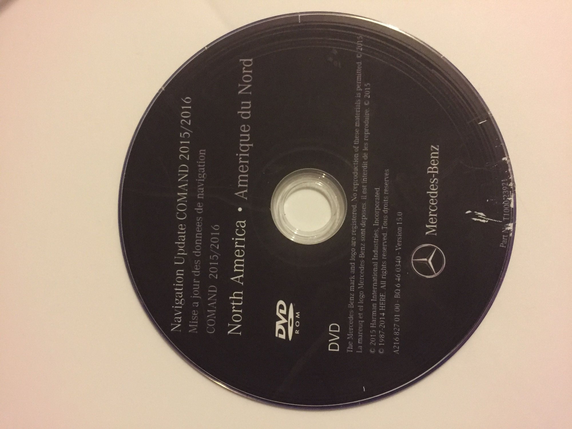

Thank you for your reply to my post. Yes the DVD I had put in the Command Head unit looked authentic i bought on Ebay-it was for vehicles built 2015-2016. My CLK350 is a 2006. Would it work if I tried to install the original DVD it came with? I attached Pictures of the DVD CD.

There are tons of fake 2015 discs on eBay. If you paid ~10-15 USD for it, then it's fake. In fact, looking at your picture, I can tell it is fake because there are typos in the French text.
Real ones cost ~100USD used. Flip the disc around. If you see the part number imprinted on the clear centre part of the disc (where you pick it up with your index finger), then it will be genuine.
Another problem, you have the wrong disc. Your disc is for CL and S classes.
The correct disc for CLK is BQ6460328. You will see T1000-22938 imprinted on the back.
To my knowledge, you cannot revert to a previous firmware.
