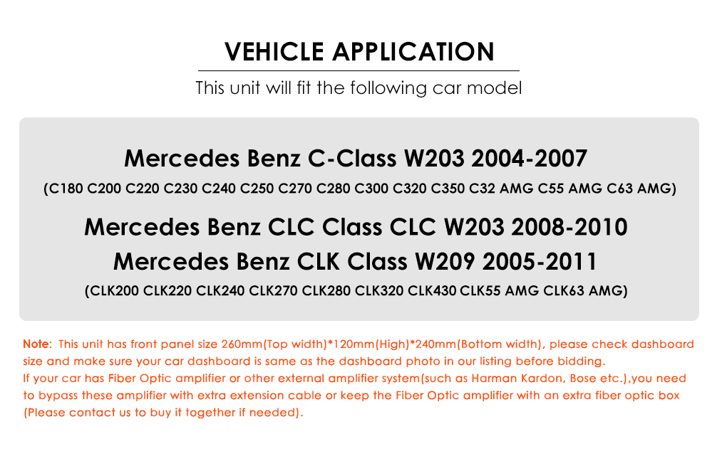

yeah I’m not sure if I wanna tackle it either it seems that the Harman Kardon system makes it difficult to work on for some reason I might call Crutchfield and see what they have to say.
i’ve done quite a few audio equipment swaps in many cars so I’m not afraid to tackle the difficult job but if I have to bypass a lot of stuff and tap into a lot of stuff and I find a different way to do it.
makes me wonder if this would work better
https://www.carnaviplayer.com/mercedes-benz-clkc209w209-aftermarket-radio-upgrade-p-1187

https://www.ebay.com/itm/40328365848...xoC6VUQAvD_BwE
Old Apr 17, 2022 | 01:30 PM
SkywardOne's Avatar
Joined: Jan 2020
Posts: 17
CLK500
Hope this helps

I personally dont like that head unit....its very limited (no wireless android auto or carplay) i just think if your going to spend THAT KIND OF MONEY you get at least a 9inch full touch screen because analog buttons? cmon. They also have way better units on DHGATE ALI-express (whatever made in china website you use or will use) with much more ram and faster 8 core cpu's and dash kits that you could vinyl wrap in carbon (if your into that sorta thing like i am )
yeah im sure the only good thing on that site is the Harmen Kardon Fiber optics adapter and i bet you could get a better one or the same one on the Chinese sites anyway
