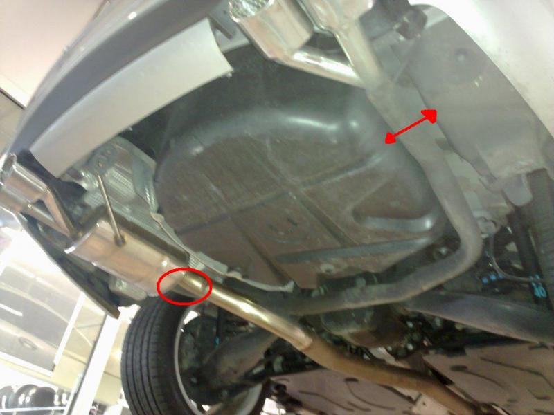

Well on a cab,
you're gonna have an issue, there is not enough room for the quad exhaust with two mufflers (AMG mufflers)...
You'll need the kind of installation I got.
You can change the rear bumper or only cut it...

Originally Posted by jauffret
Well on a cab,
You could make room for two mufflers with the method I mentioned in my preious post. The mufflers don't have to be AMG they could be any brand.
Old Aug 19, 2010 | 07:24 AM
jauffret's Avatar
Joined: Aug 2009
Posts: 9
From: Paris FRANCE
CLK 55 AMG
Swap of the old spare tire for the new version is going to cost a lot of $$$
Well on a cab,
Why would you change the rear bumper. They sell the black plastic piece that goes on the back of the bumpers with the two cut outs already. It's only $140, a lot cheaper than a whole bumper.
That's exactly what I did.
Cut the rear bumper and add the black plastic piece.
Result is quite nice for the price.
