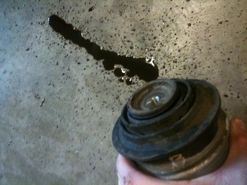

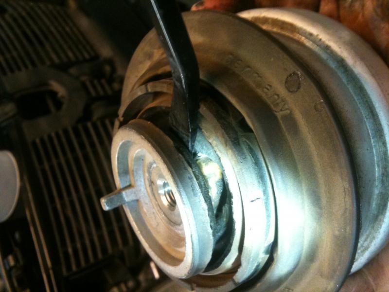

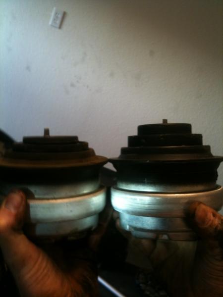

Looks like I'm nearing the end of this 100k tune up. Been at it for a few months. 90% has been DIY and I have saved THOUSANDS. I'll update the list once I'm done. Wanted to show you guys a few pics of the mounts I yanked out today. 91k miles and they were LONG overdue to be changed. I slapped the W209 mounts in there. From start to finish it took about 2.5 hours. Wasn't hard at all, but I had help. Tomorrow is my Transmission Service. I only got a few more things and then I should be good to go.... Then the headers and secondary delete... and then ... supercharger...

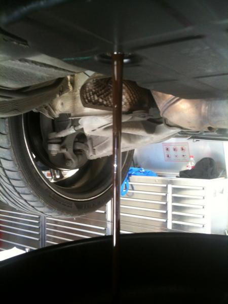

Look at what color my transmission fluid is. 90k miles...
