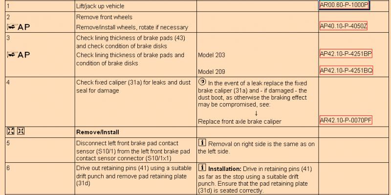

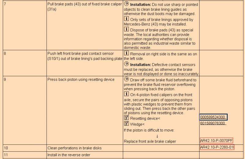

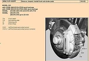

Aug 16, 2011 | 11:38 AM
Here are some screen shots from the WIS:
Hope this helps

Aug 16, 2011 | 08:45 PM
no bolts at all removed. knock out the pad retaing pins and remove the spring clip then simply push the pads out. new pads opposite for install
