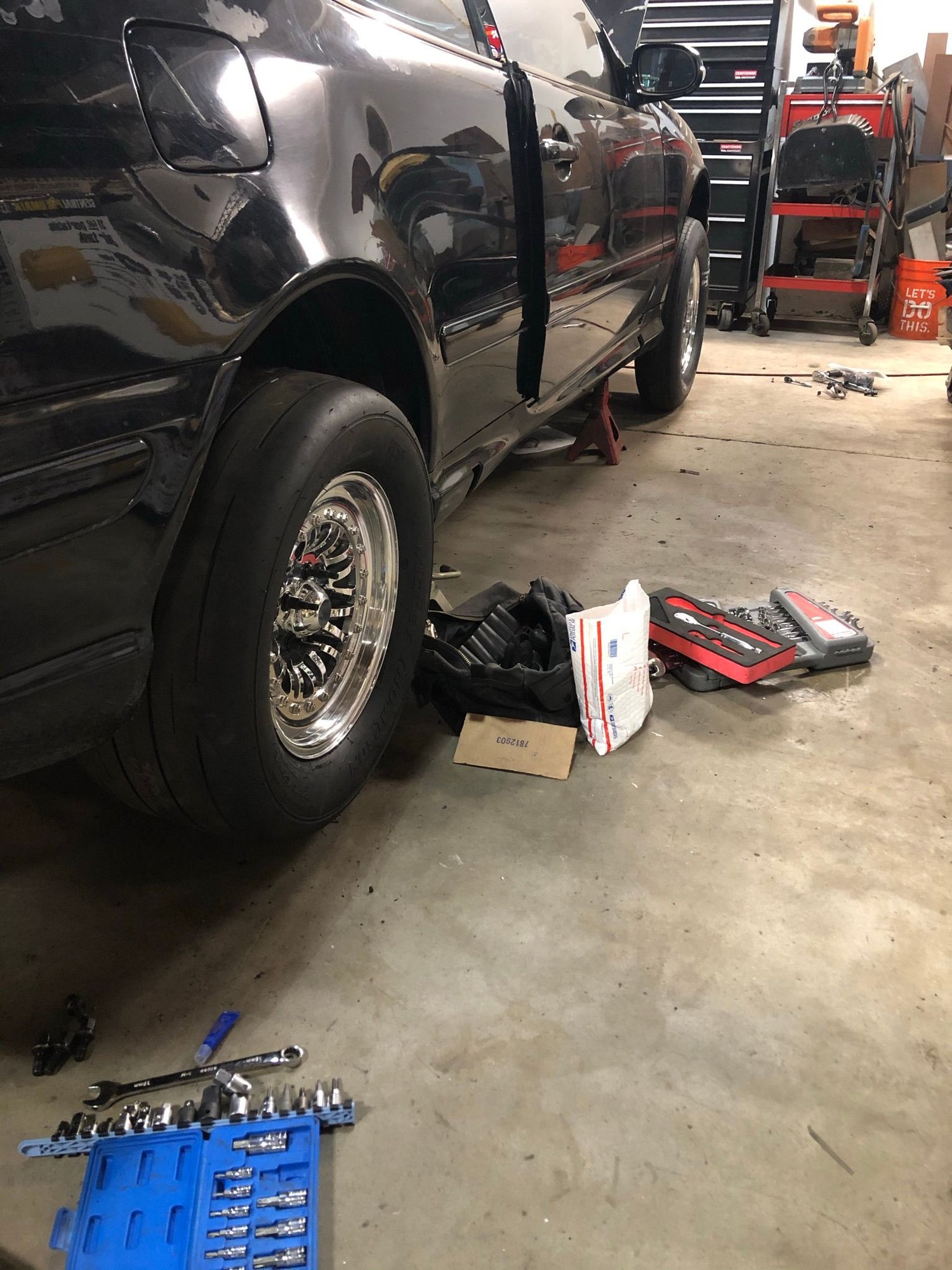

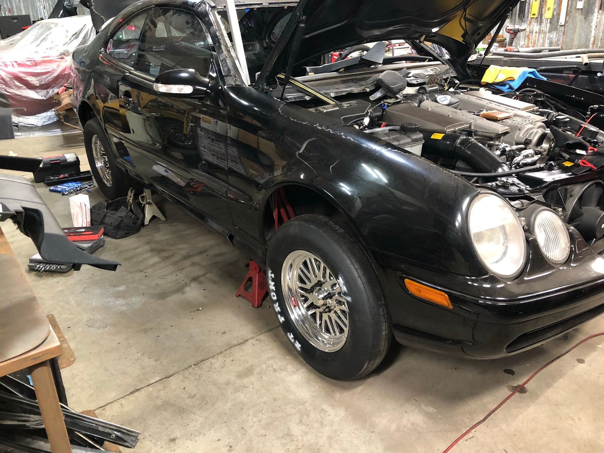

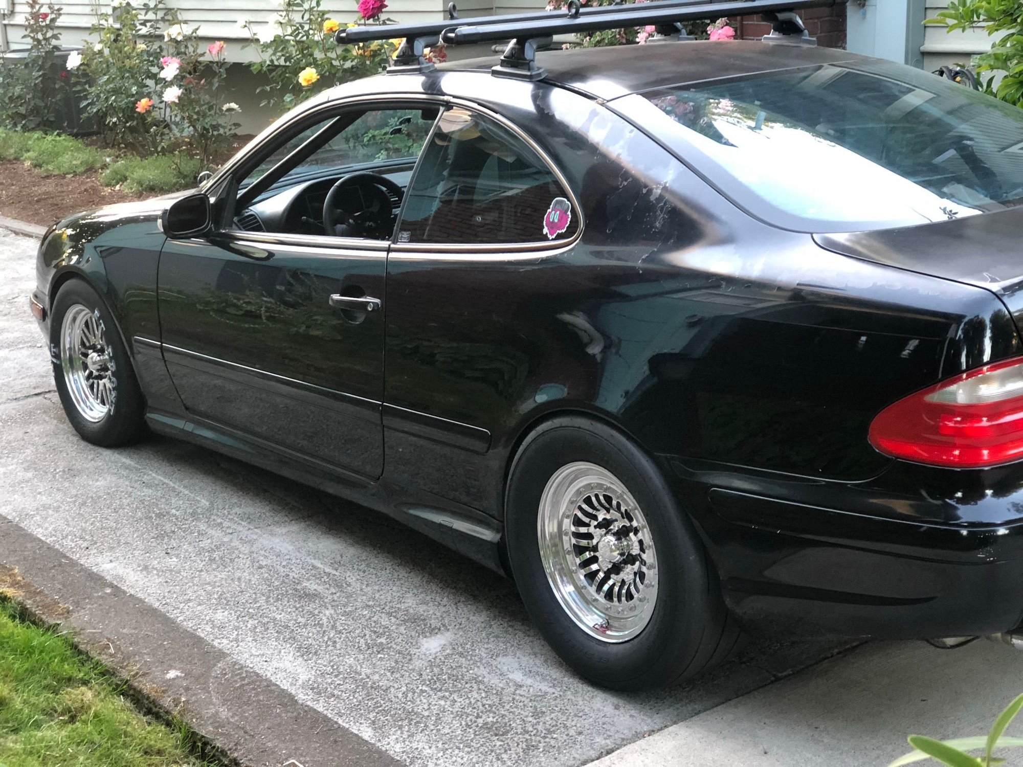

I got my custom Holeshot drag wheels with 15" Mickey Thompson skinnies up front and 275/50-15 Street R's on the rear. Looks like they will fit great once the car is back on the ground.

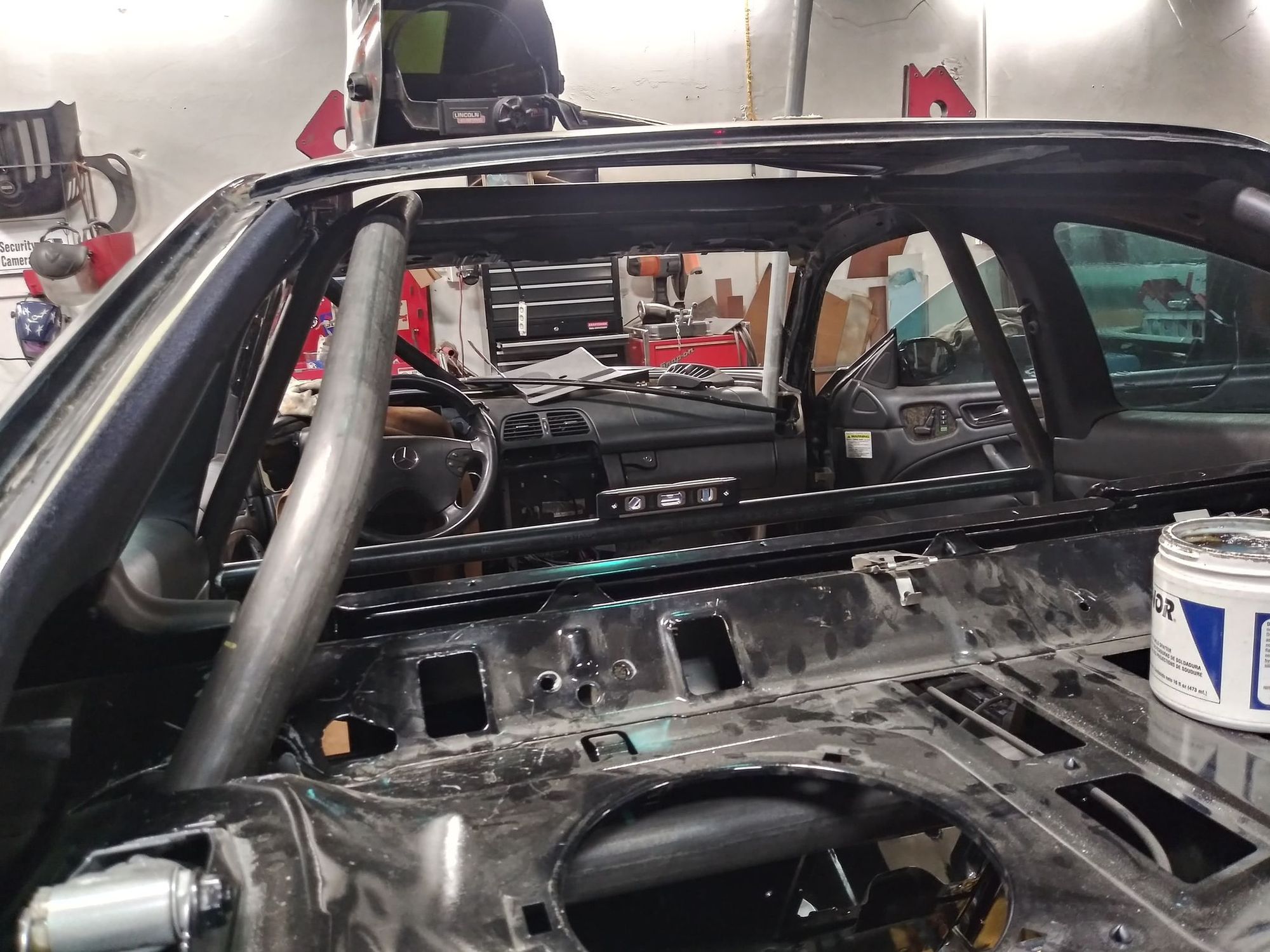

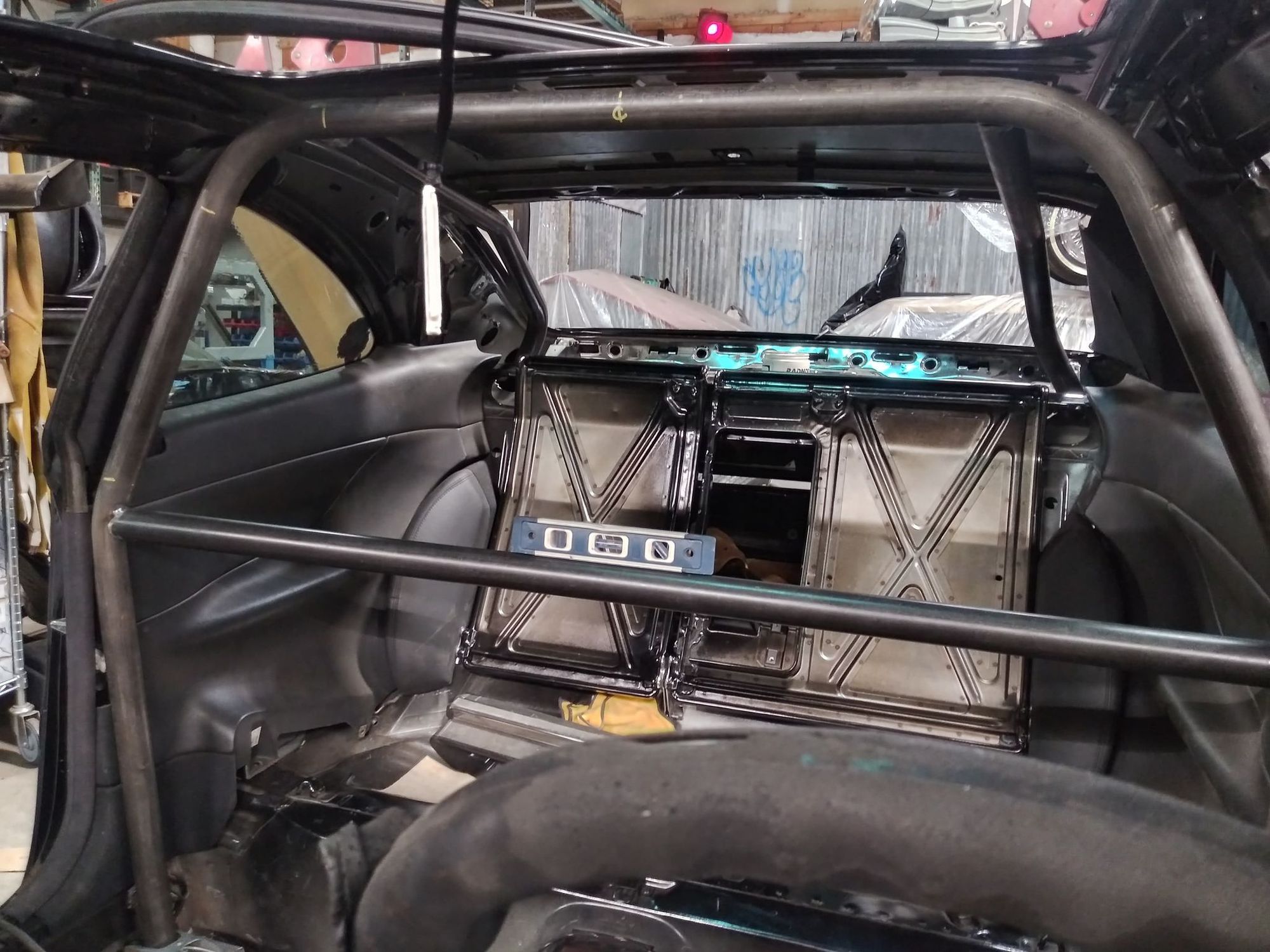

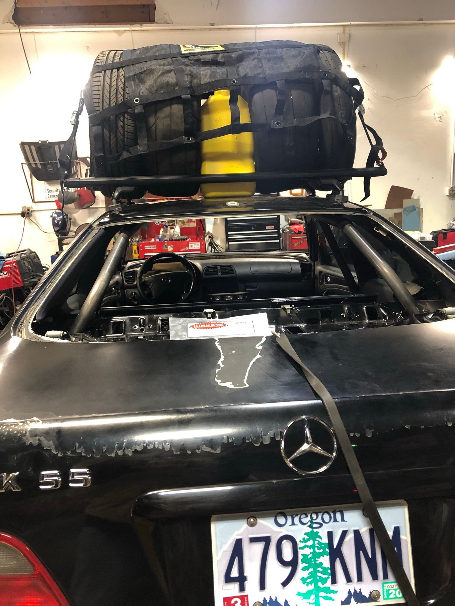

The car is also getting a roll cage that will certify to 8.50. Here are some in-progress shots

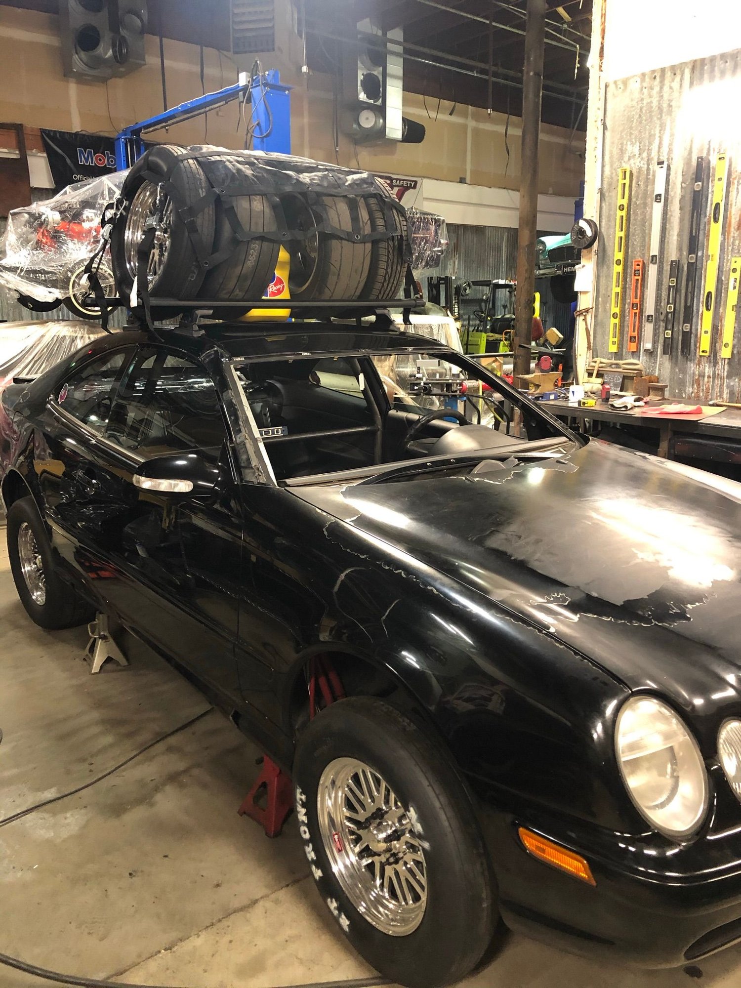

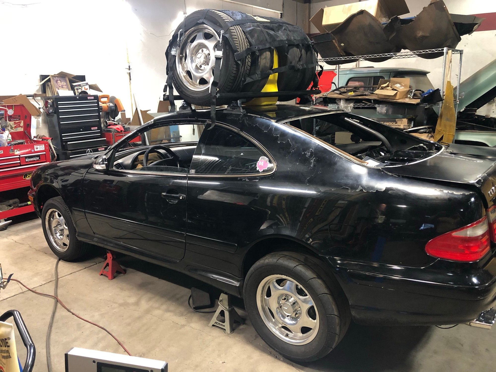

This weekend I'll be at the shop installing a roof rack to carry my tires and fuel jug on the road trip, and I should have the car back home next weekend so I can get a flexfuel tune done for the Holley so I can run pump gas, E85, or any blend of the two.

I got my roof rack installed. The cage and trunk paneling are supposed to be done this week. Hopefully I'll be road testing next weekend.

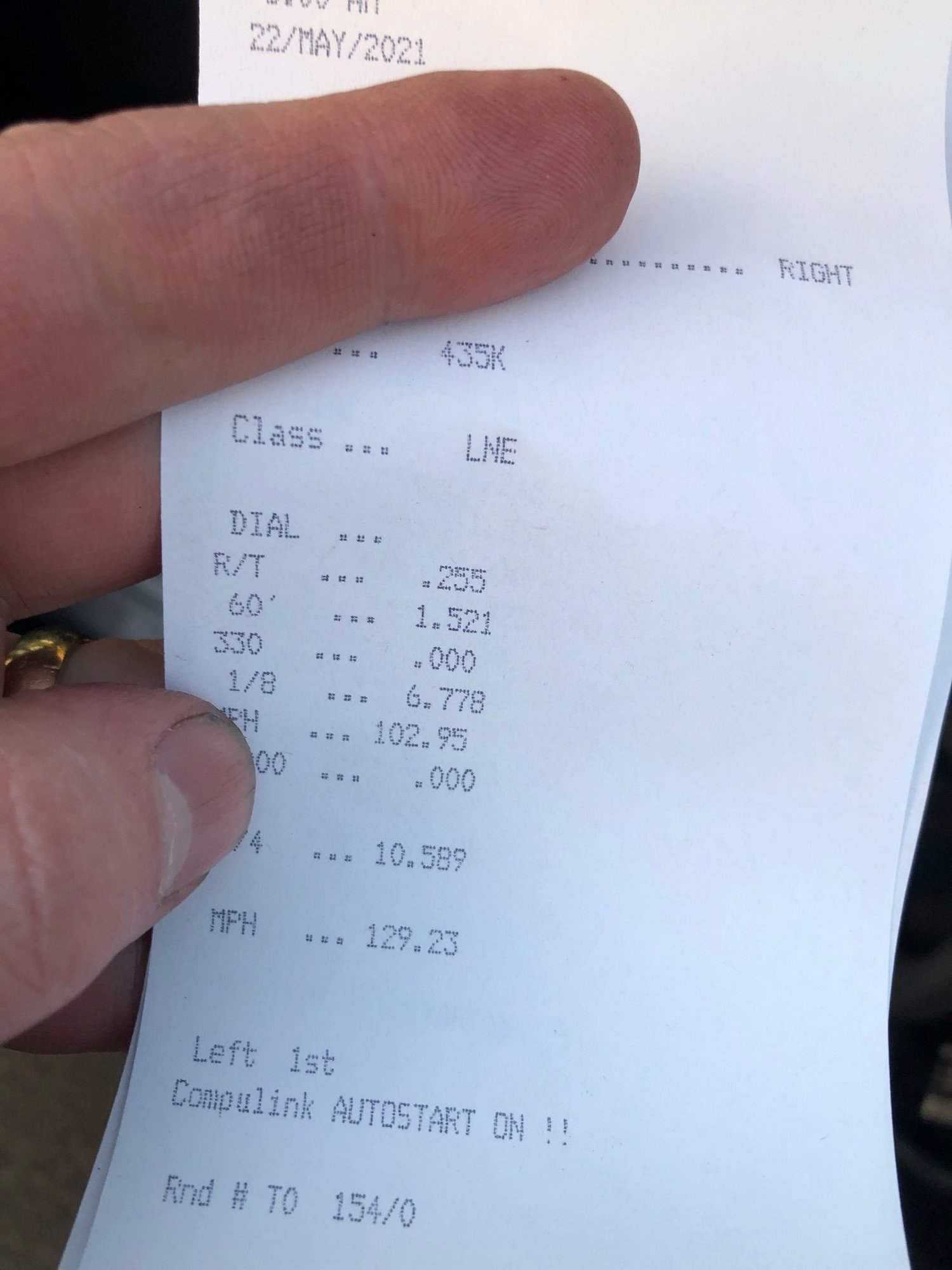

I did some testing last weekend. She's deep into the 10's, and very low 1.5x 60' times on these tires. I tuned it for E85 and a 77mm pulley this week, so it should be in the low 10's next time out.
I leave for Raceweek in two weeks. Pretty much everything is sorted out except a few wiring issues.

The cost of a cage is going to vary widely based on a lot of factors like experience/skill level of the fabricator, cost of materials (chromoly is about $20/ft right now!), and what level of fit-and-finish you want. I paid $4500 for this cage, but it could easily have been more if the car had a nice interior that I wanted to retain.
The sunroof has been removed and filled-in with sheet metal. It hasn't been bodyworked yet, so it still looks like crap, but it keeps the weather out!

Did they tig or mig weld the cage?

Have you considered using the glass from the sunroof as a mold and making a fiberglass or carbon fiber plug that you could epoxy into the hole? That was my original plan.
The fabricator tacked 1/4" bars across the opening and then welded a sheet of steel flush to the roof, using the bars as support. Unfortunately it warped the sheet metal and it's going to take some filler to smooth things out.

Oh, and the cage is 1-5/8" chromoly, which requires TIG welding.
