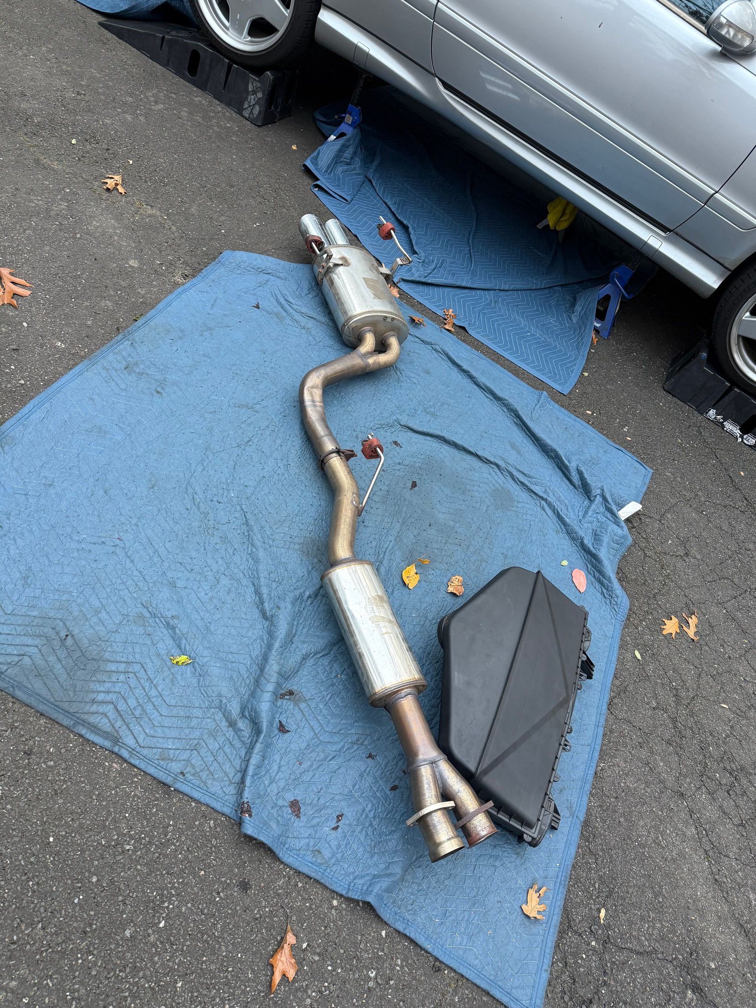

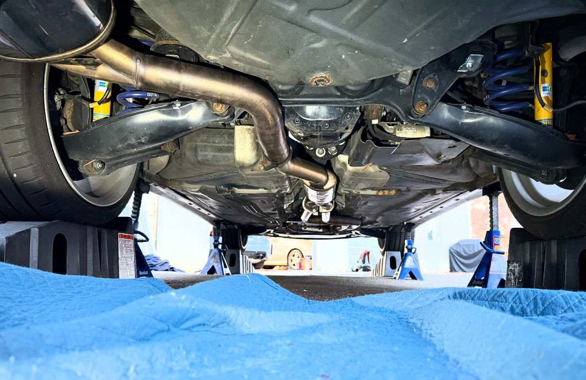

so the little vibration @19/38-45 isn’t entirely gone.. lmao… I sucked out/refilled trans fluid with valvoline max life atf probably atleast 12 quarts it made it better, but it’s right @ the 1-2 shift so maybe its TQ converter but who knows… Will drop it eventually and replace. May throw differential in just to see because maybe the messed up the lash on that which is causing it.. can also use original for quaife LSD. But it’s tolerable 😂😂😂

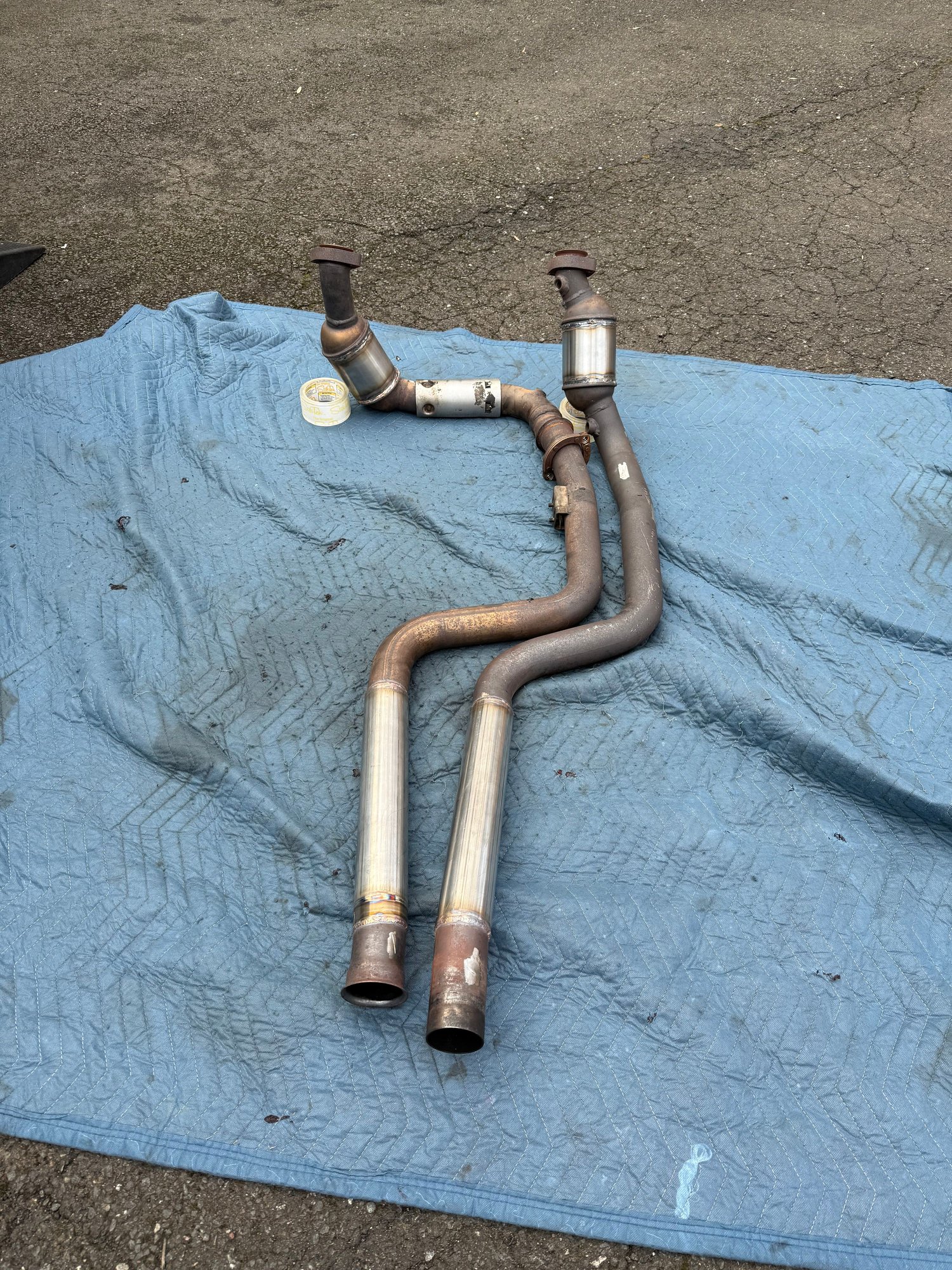

I ran car with all cats gutted (as they were loose and rattling) and tbh it felt fast as ****… like really fast lol but I had the primaries replaced with high flow cats and the secondaries straight piped to supersprint midpipe and muffler.
once installed it felt more like stock but with a great clean sound.

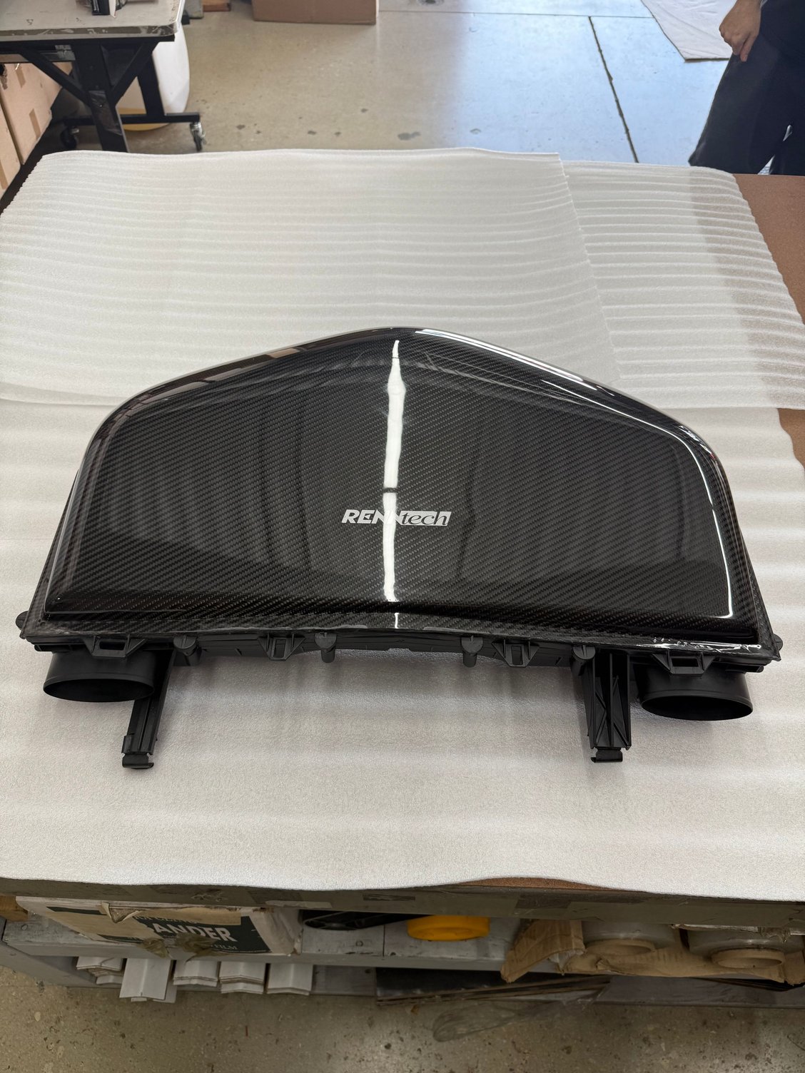

I had ordered the renntech Airbox and tune and due to delays it was not ready by the time it showed in the northeast. So I moved to Florida to be able to use and enjoy it lmao everyone at renntech is so cool and awesome I freakin love that place.
with the new exhaust setup/intake tune the car is awesome. **** ****in rips, sounds amazing and has been blowing cars the **** away 😂 got a bunch of compliments saying it sounded better than a burble tune c7 vette haha
rev up/torque and acceleration are good as ****!!
I may have to dyno it though and buy a stock one to compare the difference. Hard to say they didn’t get it perfect from factory and ****ing with it may have made it slower 😂 car performs up to 160 and maintains 160 no problems 🤘🏼

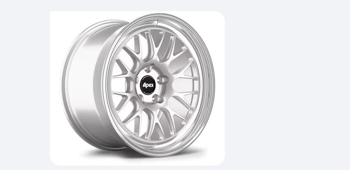

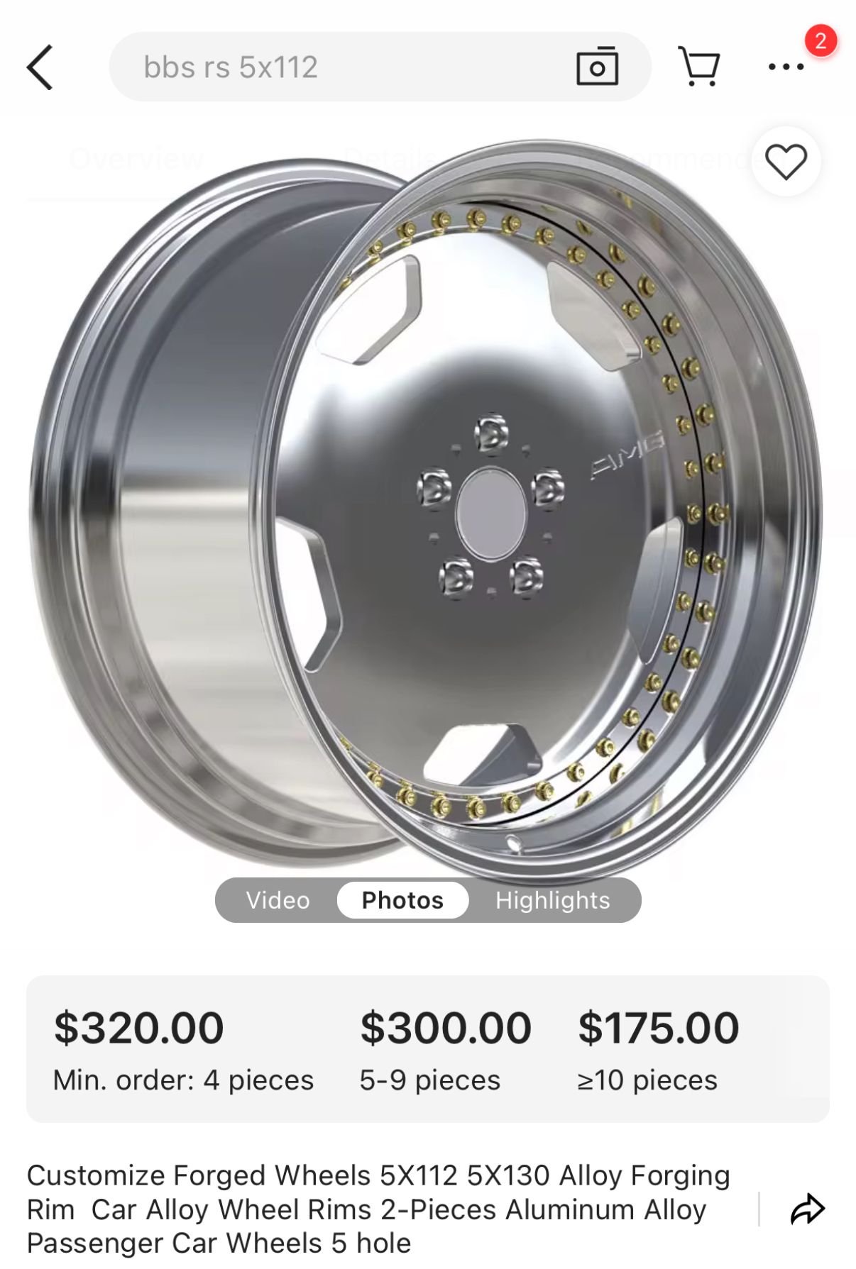

so I went to Alibaba and found the company that probably makes apex’s wheels for them.. lmao
went with a pretty aggressive setup but was able to customize every aspect of the wheel. You can get 3 piece performa reps fully customizable 19” for $2400 shipped.
I went with APEX ml10-rt “reps”
18x8.5 et30 front
19x10 et25 rear
I’ve been running 18x95 et 31 rear and the stock 17x7.5 et37 front and it’s been pretty good. They do it on the new M’s I’ve had and while if u look at it it can look funny but I think it will fill the wheel wells nicely and fitment should be great.
going to run 225/40/18 front and 265 maybe up to 305 in the rear. Will see what happens wheels should arrive in March.

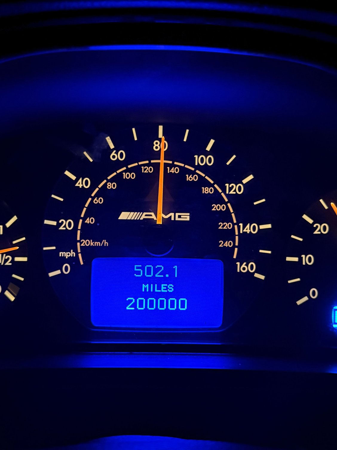

car drove from New York to Florida 0 issues. She hit 200k miles and is driving better than ever. It’s been an absolute blast and I think these cars have such great potential I plan to start scooping them up and doing high end restomods.

Exhaust looks great, good choice with the Supersprint set-up. Try and get a video clip, i'm curious how it sounds. I really need to get on my car, its been on the back burner for a while now.
Is that a brand new Renntech Intake directly through them? I was under the impression that they were no longer available, but if they are still taking orders and being made, thats awesome. They're pricey but they are a great company.

but yeah exhaust came out great! I’ve run the car just about every which way you can and this setup is great. I paid $3500 for the car and all into exhaust is about $3500 if you get what I mean. I know how the guy did it though so I could just get a welder and do it myself for anyone.
it’s definitely “refined” not too loud or annoying and compliments the car. Supersprint no longer made a non resonated center section but I’m thinking of adding one for sound, as well as maybe an x pipe where the rear cats were.

yea, renntech managed to make the box (after a couple months) haha I ended up moving to Florida to be close and annoy them but also to enjoy the car.
tbh idk if the box did anything but its candy. They require a core Airbox and I have a couple so I may buy some just to have
I think the tune did more than anything though, car feels great.
