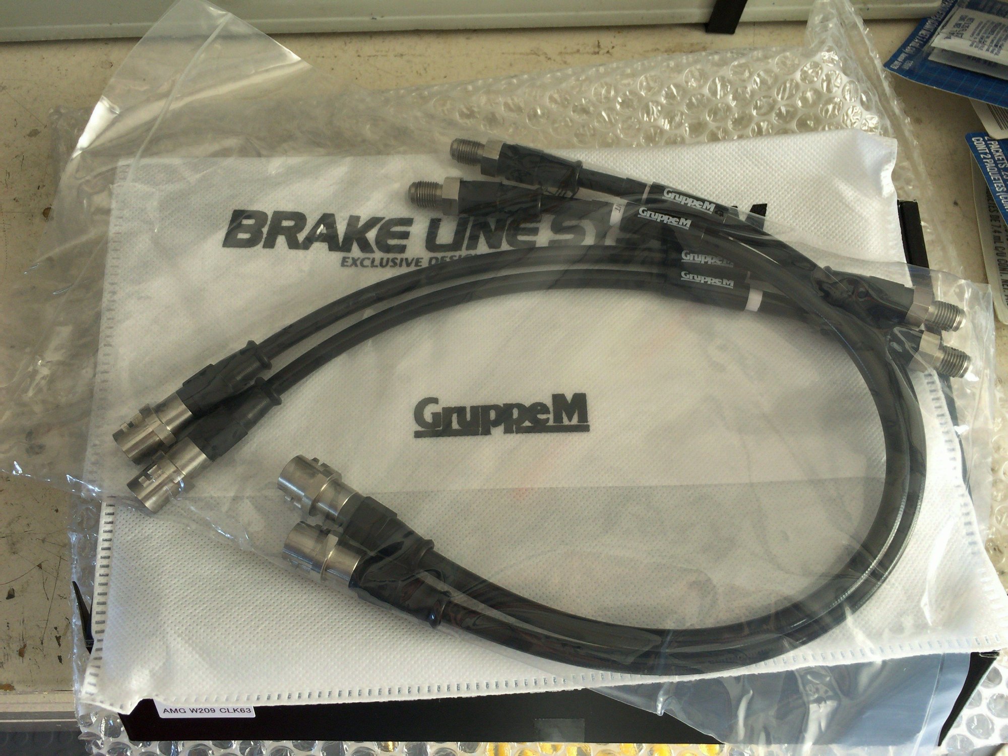

Hi,
Just saw this thread. Gruppe M of Japan makes a very nice set for the CLK 63 BS, they custom made a set for my car. They fit perfectly. They are custom made on a per order basis, as the BS is extremely rare in Japan. The owner is a very good friend of mine, so I am pretty sure I can get a set if there is any interest. As for cost, it has been a while since I got them so I will have to ask again.
Alex
Old Jun 6, 2020 | 03:36 AM
cm60k's Avatar
Joined: Aug 2006
Posts: 7,053
Likes: 398
From: A.D., U.A.E
Looks Awesome..
