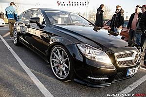

hello you can have like this: back:20tum/ 285/25/20
front:20 tum /245/30/20
with airmatic it is easy to lower it this is lovered 38 mm
nice shooting brake, we don't see many of those
