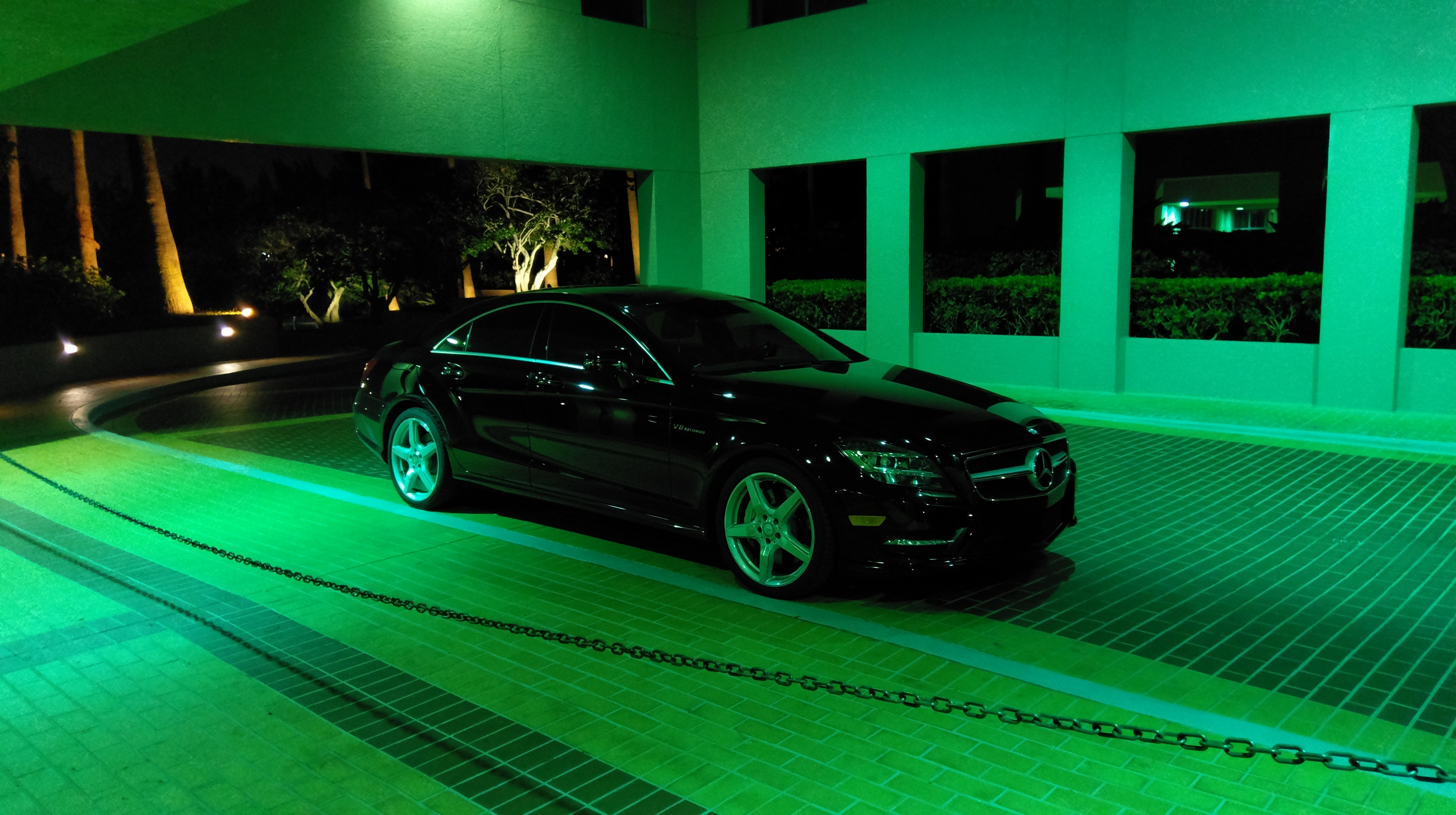

What size spacers for 2012 CLS550 stock 19" wheels.
Hello, I really think my car needs some spacers just don't know what size? I was thinking 15mm rear and 10mm front.
Attached Thumbnails What size spacers for 2012 CLS550 stock 19" wheels.-imag0092.jpg   What size spacers for 2012 CLS550 stock 19" wheels.-imag0093.jpg

For even more fender flush fitment with stock wheels, one can use 12 to 15mm front spacers and 20 to 22mm rear spacers.

You need these kind of spacers in the front
http://www.lpiracing.com/H-R-Wheel-S...59-p214680.htm
They make 15mm widths as well. If you can't find the lugbolts in a kit,just add 27mm (oem length) to the width of the spacers...so for 12mm spacers you need 39mm length bolts.
I wouldn't get the DRA style spacers in the rear, just get the spacers and then get longer bolts to secure.
Also make sure the bolts are "ball shaped" and not "conical shaped". The OEM wheels accepts a ball shape - some aftermarket wheels need conical shaped lugbolts.

The 20mm rear spacers (HR part number 40556654) above are designed to attach to your rear hub with special included bolts (not extended), then your wheels are attached to these spacers with your stock bolts. That's for the rear.
The best place/price for these spacers is https://www.ecstuning.com/ES12121/
For the front, if you want 12mm spacers, then: https://www.ecstuning.com/ES1831833/ and
https://www.ecstuning.com/ES8330/
or for 15mm front spacers and bolts:
https://www.ecstuning.com/ES1831838/ and
https://www.ecstuning.com/ES226/

2012 CLS63
love your pix with the green scheme
