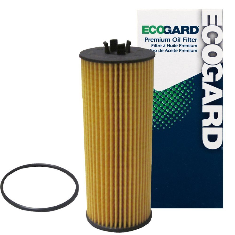

took a while for me to get the parts from Amazon, but they finally came in (MityVac, oil fiter, 5W-40 oil).
however, ive already run into a little snag.
I ordered oil filter A2761800009 (this was what was even listed on my invoice from dealer for service A). however that part does not fit my 2016 CLS550
Furthermore, when I removed the current filter I have an its actually a "Hengst AMG A2781840125"
So the dealership invoiced the wrong oil filter. Go figure!
I will now order a ECOGARD X10186 Cartridge Engine Oil Filter
what i ordered... OEM A2761800009
the oil filter that was currently in the CLS Hengst AMG A2781840125
what i will now order ECOGARD X10186 Cartridge Engine Oil Filter
