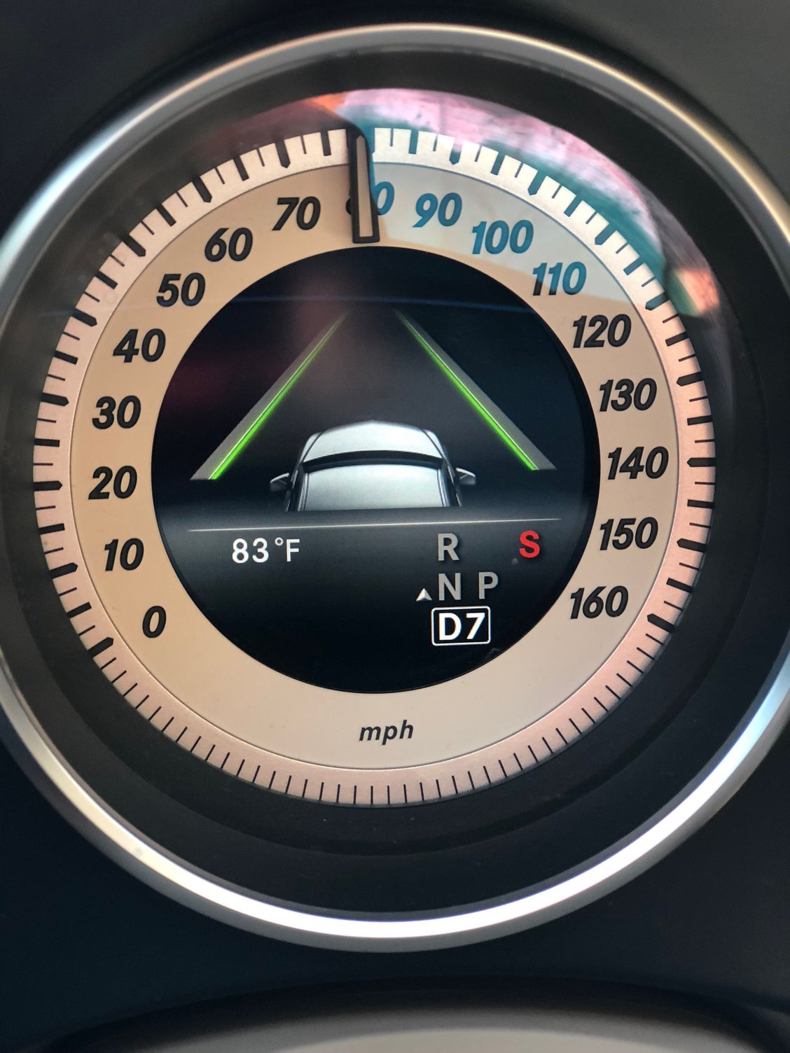

Now I would like to get your advice on the lane keeping assist, which doesn't look work properly.
When either standard or adaptive on Lane Keeping assist is chosen, the car warns me by vibrating the steering, but it doesn't correct the driving direction.
The green line appears on the graphics display when the velocity reaches the enough speed, however, at vibration the green line doesn't turn red, nor there is no correction of the steering.

The vibration is just a warning, if you continue to drift over the line it'll turn red on the dash and correct you. Apparently the system works up to 120mph! I'm not sure I'd want the brakes to be applied on one side of the car at that speed! lol.

2014 cls here. I just tried it and it does not correct, it simply vibrates Line is green then turns grey .. Is this something the dealership should be aware since my car is still under warranty .?

Keep in mind there are a few levels / packages out there and you may or may not have the active lane keeping assist package (I don't know what the package option code is, maybe someone else can post it). For example my CLS has options 22P-"Track Package" and 476 - "Automatic lane recognition". So basically mine will also knock the steering wheel when hitting the yellow line but it will NOT correct for you. Look up your VIN and see if you have the "Active Lane Assist". Again, someone else please post the option.

Check data card https://www.datamb.com/ to confirm if you have code 476 lane keeping assist (no correction just vibration) or 238 active lane keeping assist (correction).
