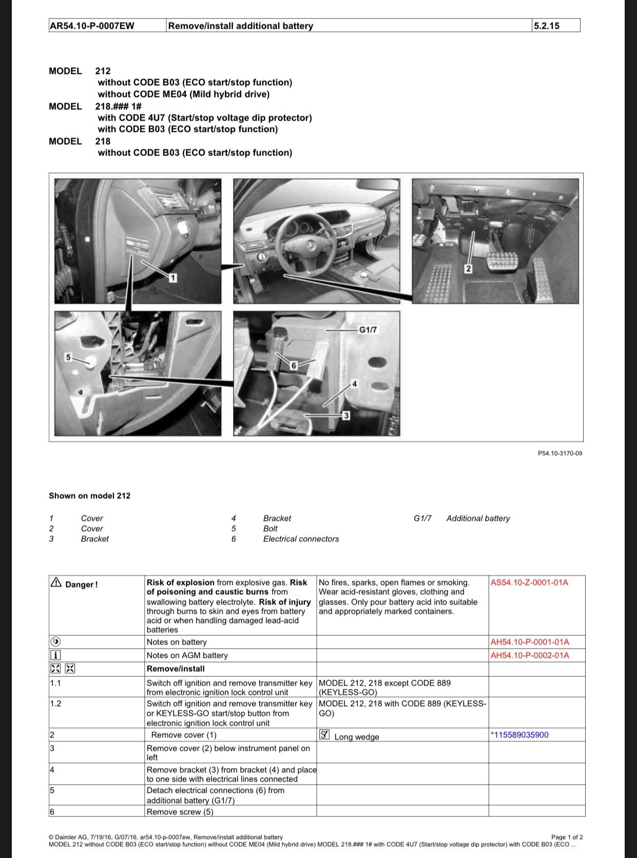

Hmm never thought about that I will have to take a look at that. Is it located under steering column and did you get any warning lights on dash?

Just checked under steering column and I can’t seem to see any battery in there also people saying in the trunk next to spear tire but there’s nothing their. Could anybody assists in finding aux battery

I have the same symptoms too, where is this auxiliary battery?

2013 CLS550
I finally found it using this diagram. It’s under the steering column

CLS550
thanks for sharing. That looks expensive.

2013 CLS550 4Matic OE Tuned
Actually quite cheap! Marv
Old Dec 7, 2019 | 12:27 AM
joe1655's Avatar
Posts: 11
2013 CLS550
yeah I got one brande new oem for $40 on ebay
