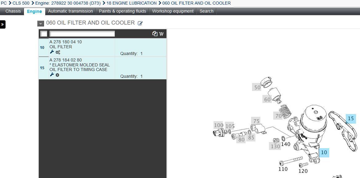

As suggested you can simply replace housing cover 0-ring and monitor it. However, if shop is reputable most likely housing seal needs replacement, housing ($84 or less) and/or seal ($10 or less) replacement should take minimum about 3 hours or so.
