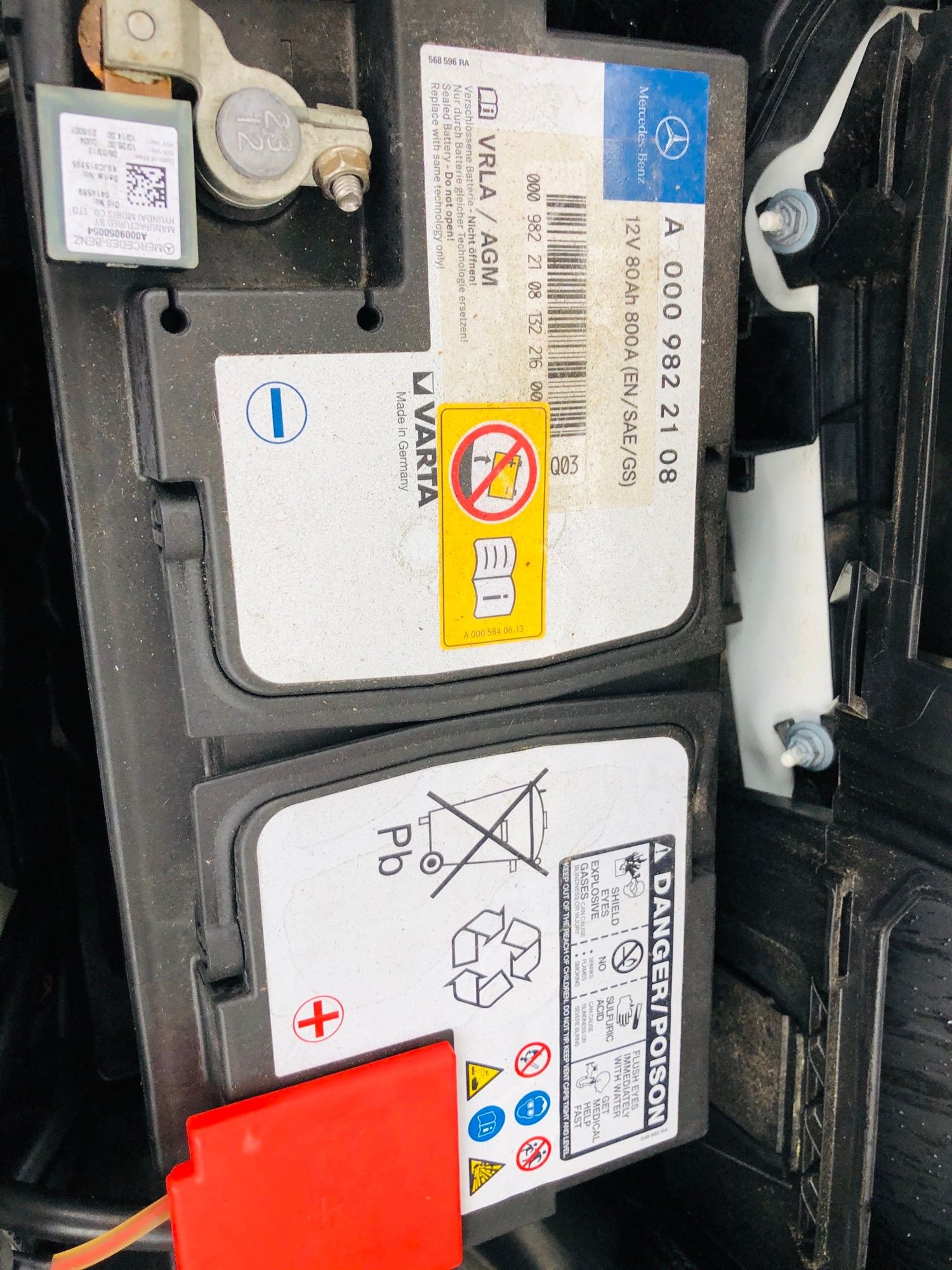

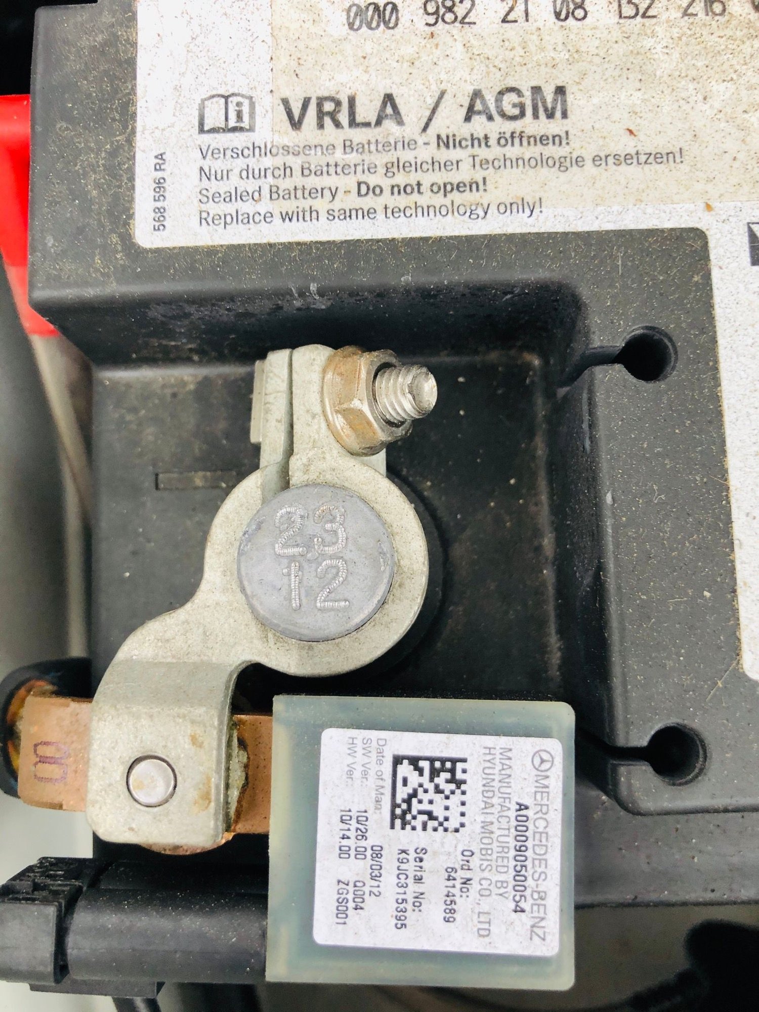

Old Jan 25, 2020 | 03:48 PM
therocket's Avatar
Joined: Jan 2020
Posts: 43
Likes: 10
2013 CLS550
Battery photo
I assume this is the original battery and the cause of the issue based on the date?
Old Jan 25, 2020 | 04:22 PM
Tbbt CLS's Avatar
Joined: Jan 2019
Posts: 335
Likes: 103
From: Saddlebrooke, AZ 85739
2013 CLS550 4Matic OE Tuned
The date code reads 23rd week of 2012. What is your build date (on the drivers' door post)? I'm betting it's the original battery. Have you had it load tested yet?
Marv
Old Jan 25, 2020 | 04:27 PM
therocket's Avatar
Joined: Jan 2020
Posts: 43
Likes: 10
2013 CLS550
06/12 so it must be the original one. Have not had it tested yet but doing that next. Appreciate your help
