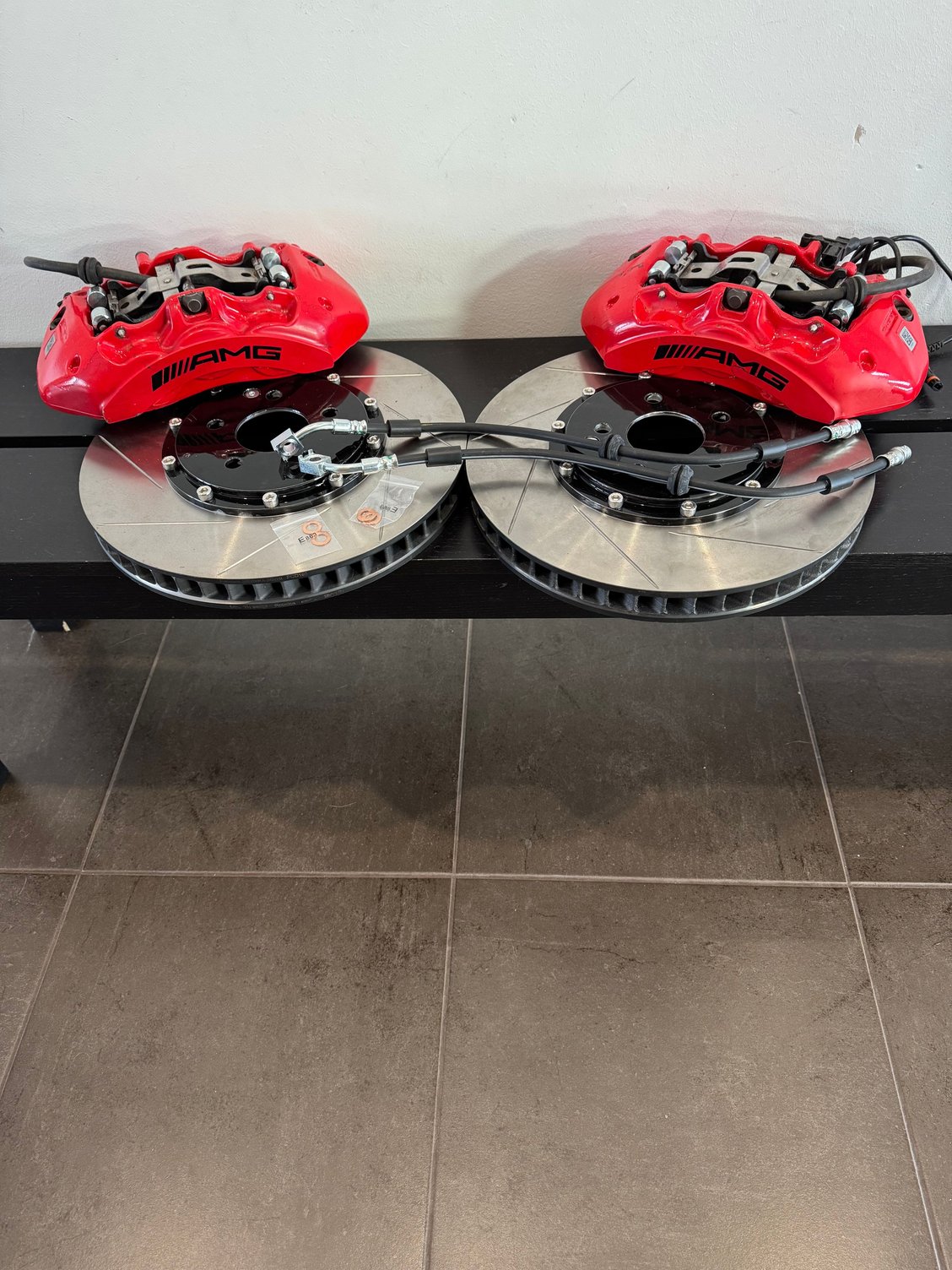

Quote: Front brakes are ready now. I will use CLS/E63 brake hoses. Should be much easier to install than my oem. I will update the dust shields also. CLS550 dust shield are smaller than 360mm front rotors and don't cover those so well. I will post the update version stuff later.
Nice progress.. I will get my calipers tomorrow from pouder coating. I will keep the dust shields and only cut the edges, to fit the bigger caliper.
Reply 1
Feb 20, 2026 | 07:22 AM
  #252

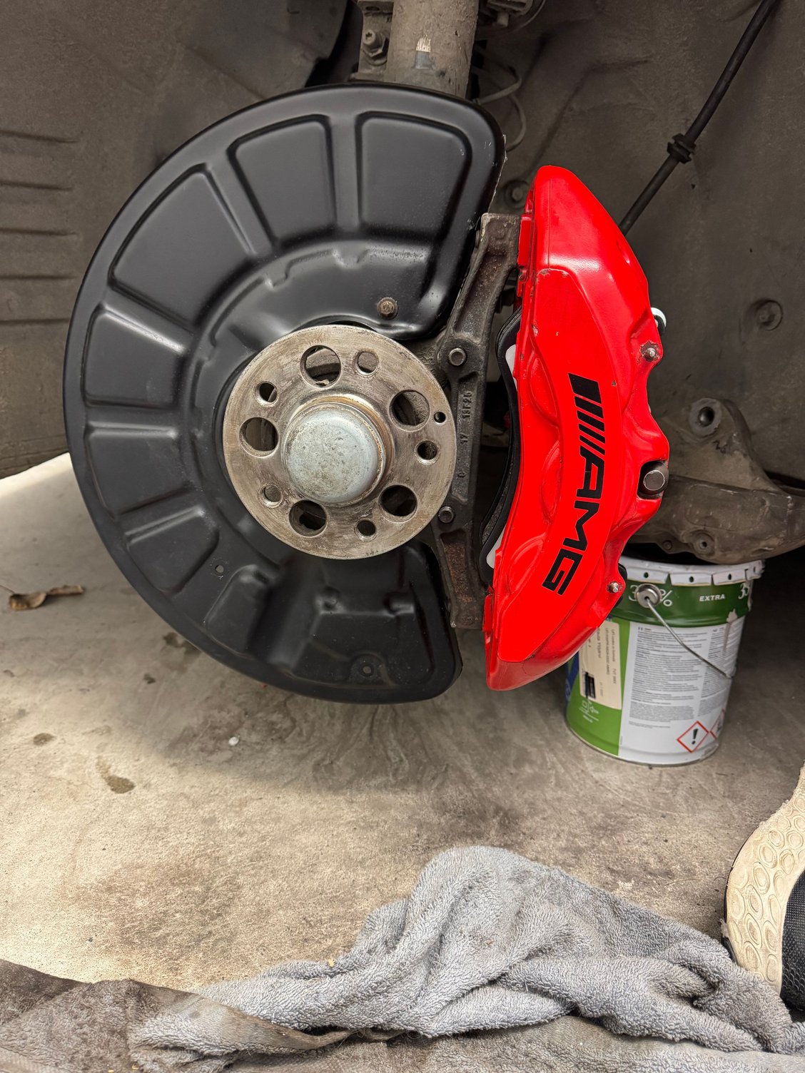

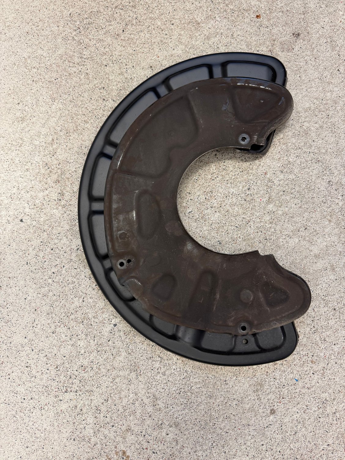

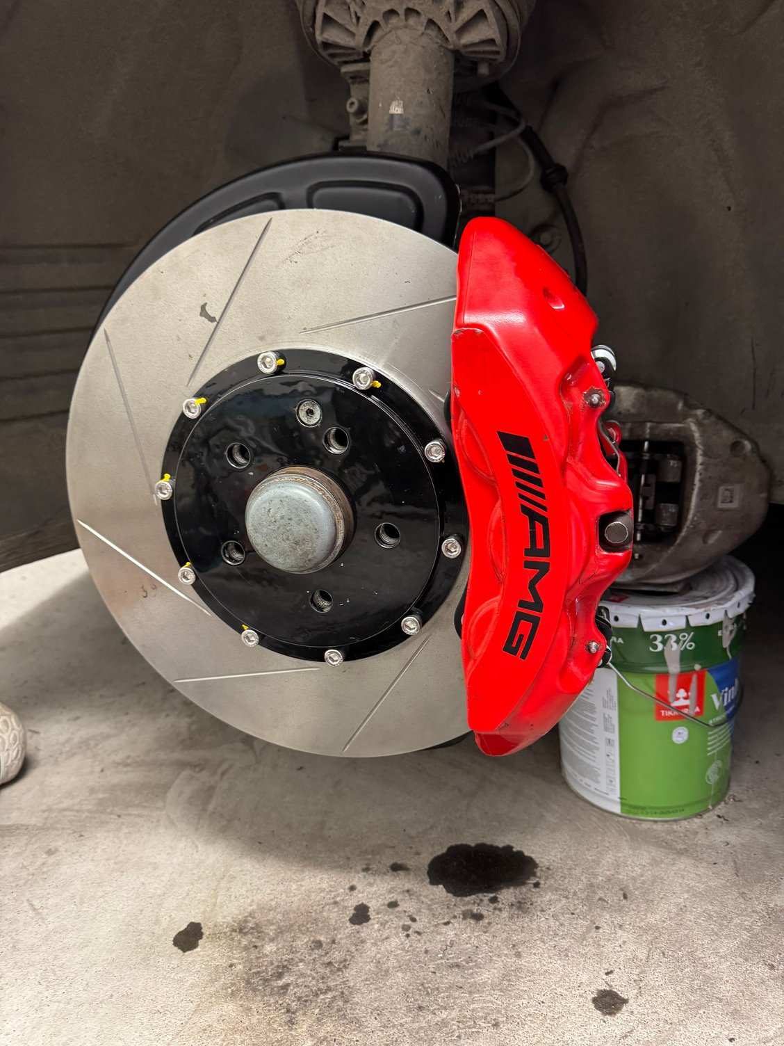

Driver side is now ready. That knucle material is really hard stuf.f. I did need a drill that have a lot power and after that I have problems with drill bits to last. Finally I did order Cobolt drill bits and lubricant to cool it down. Then I did make it.
I did bought CLS63 Carbon Ceramic dust shields and you can see how much bigger they are vs. Oem. Oem don't even cover well the rotor. Might also look a bit better. So yes now AMG caliber, brake hose, dust shield and Paragon rotor ring with custom fab. hat is installed. My friend did centered the hats in his shop and put a little yellow paint to see if bolts are gonna get loose for some reason.

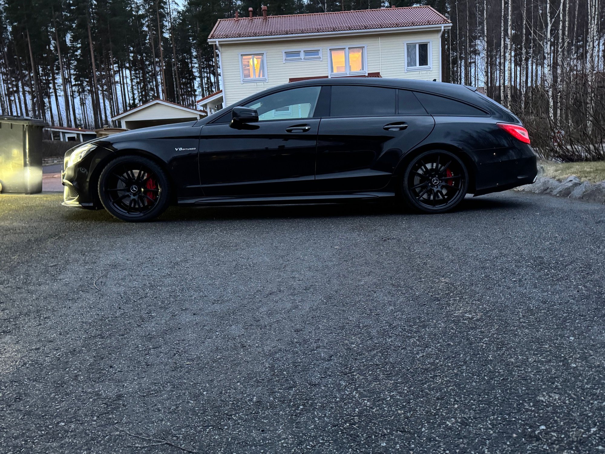

I did do my intake tubes again ja now they are about size 4,5". Also engine cover is modified to fit the BB boxes.
I did bump C63 AMG forged wheels so nice price that I have to bought those. I like the looks now.

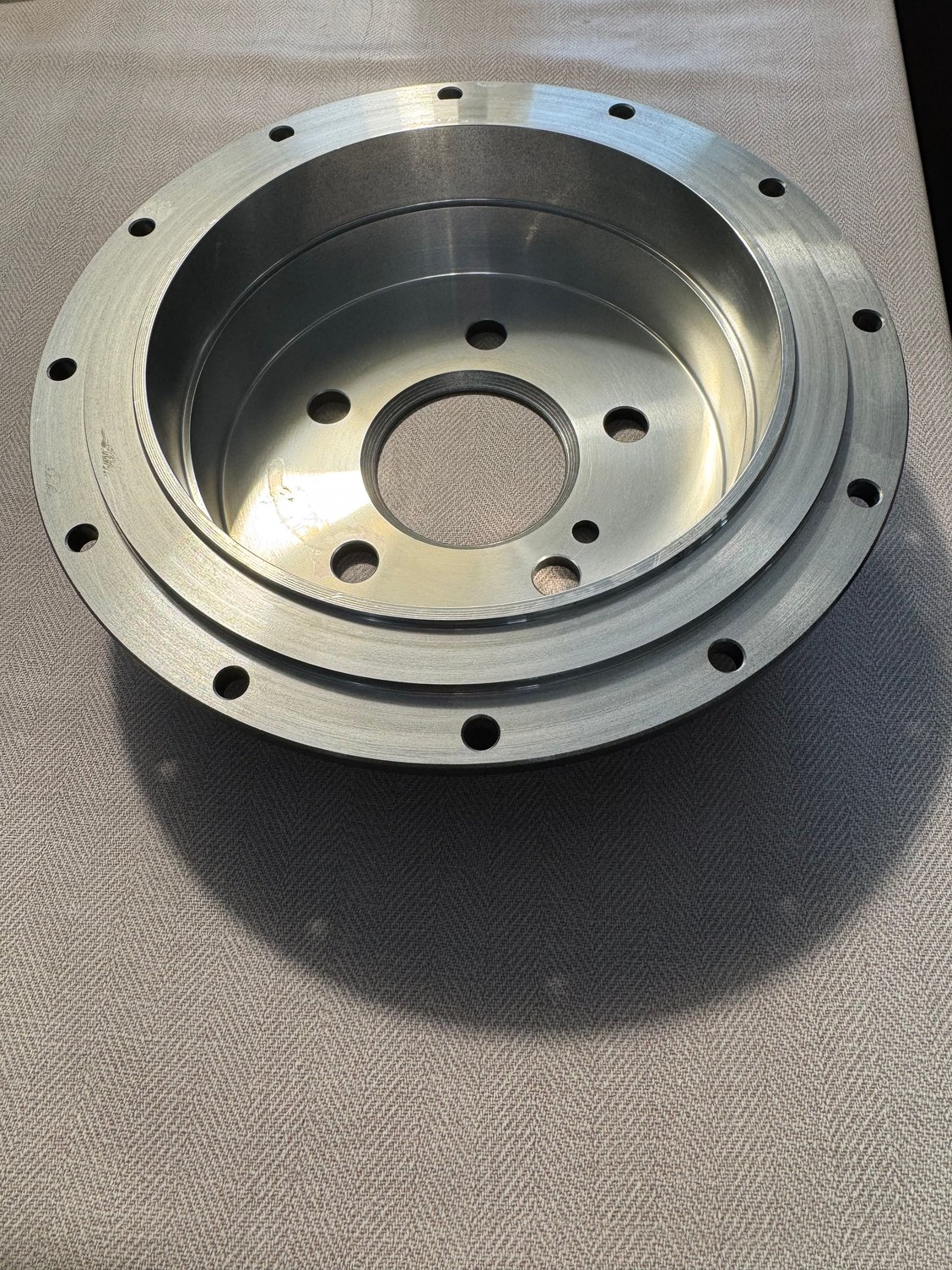

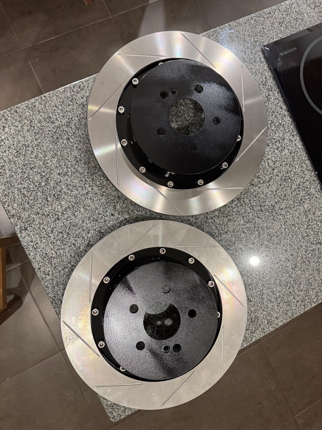

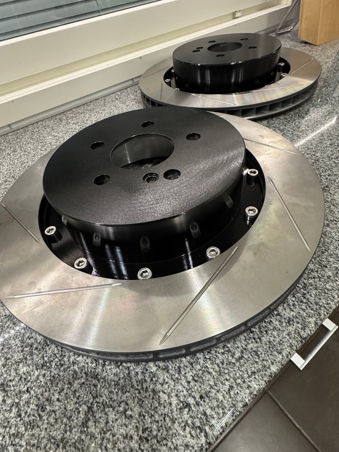

Few thing have happened. I did finally paint the rear hats that Finish metal work shop did for me. Rear hats were not easy to do for what I see. Paragon brakes didn't manage to do hats for me in over 10 months, just empty promises and finally they did stop answering me back. Nice job.... But hey, metal shop on Finland did those for me like in few weeks! As a side project for them. For me the hats look amazing work! Now my rear light weight brake set is ready.

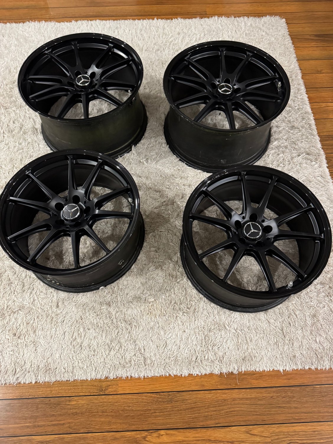

And the second thing that happened was I bought second set Mercedes C63 AMG wheels, that are the lightest that have done to these cars. Material is Magnesium aluminium. 19x9 wheel weight is 8,2kg / 18,07 lbs. Yes you read it right, just can't believe how light it is. I will might make a post for these later.
Those first C63 AMG wheels that are in my last car pics was made by Otto Fuchs. They manufactured these wheels on behalf of Mercedes-AMG. Since they exclusively manufacture forged wheels, these FUCHSFELGEN are forged,The wheel with the OTTO FUCHS marking 38095.011 weighs 11.05 kg and the wheel with the OTTO FUCHS marking 38096.011 weighs 10.78 kg. I like a lot these wheels. Looks great on cls.

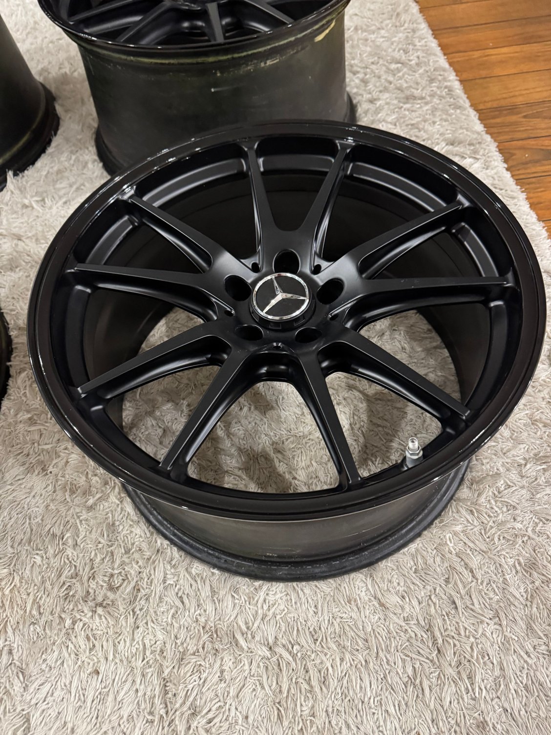

So here is more wheels for my collection. These are the lightest wheels I have ever touch in my life at this size. Magnesium aluminium. AMG Edition 1. Pretty rare. APP TECH Italy done those for Mercedes AMG.
Front: A2054017400 9 x 19 ET25 = 8,2kg
Rear:
A2054017500 10,5 x 20” ET57 = 9,3kg
For comparison my cars oem wheel weight was front 13,5kg and rear 15kg. Truly terrible. (Haven't ride those for years and sold those)
Due the fronts are 19" and rear 20" I need special tire combo to my 4-matic to work properly. Will see how the car will look with these. Weight reduce with these + light rotors will be amazing. I need to ceramic coat those wheels.

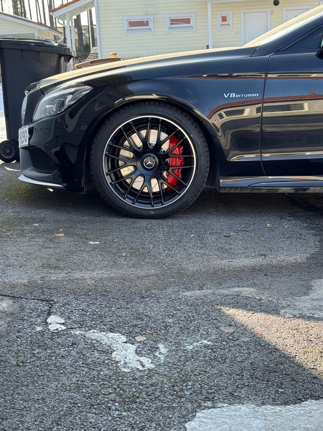

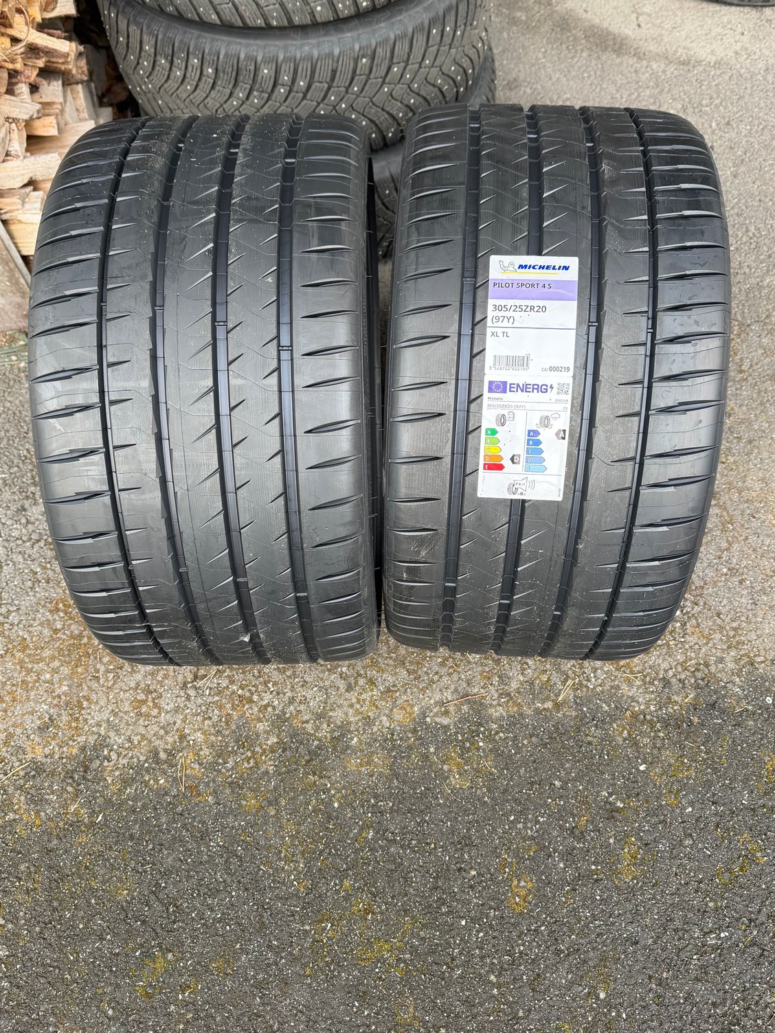

C63 AMG Edition1 Magnesium wheels and light weight rear rotors were in about a week now. Really good stopping power, light to drive and the grip is astounding with rear 305/25 Michelin ps4s.
305/25  20
305/25 20" Michelin PS4S
19
19" & 20" Magnesium wheels, by APP TECH Italy. C63 AMG OEM wheels.
Reply 3

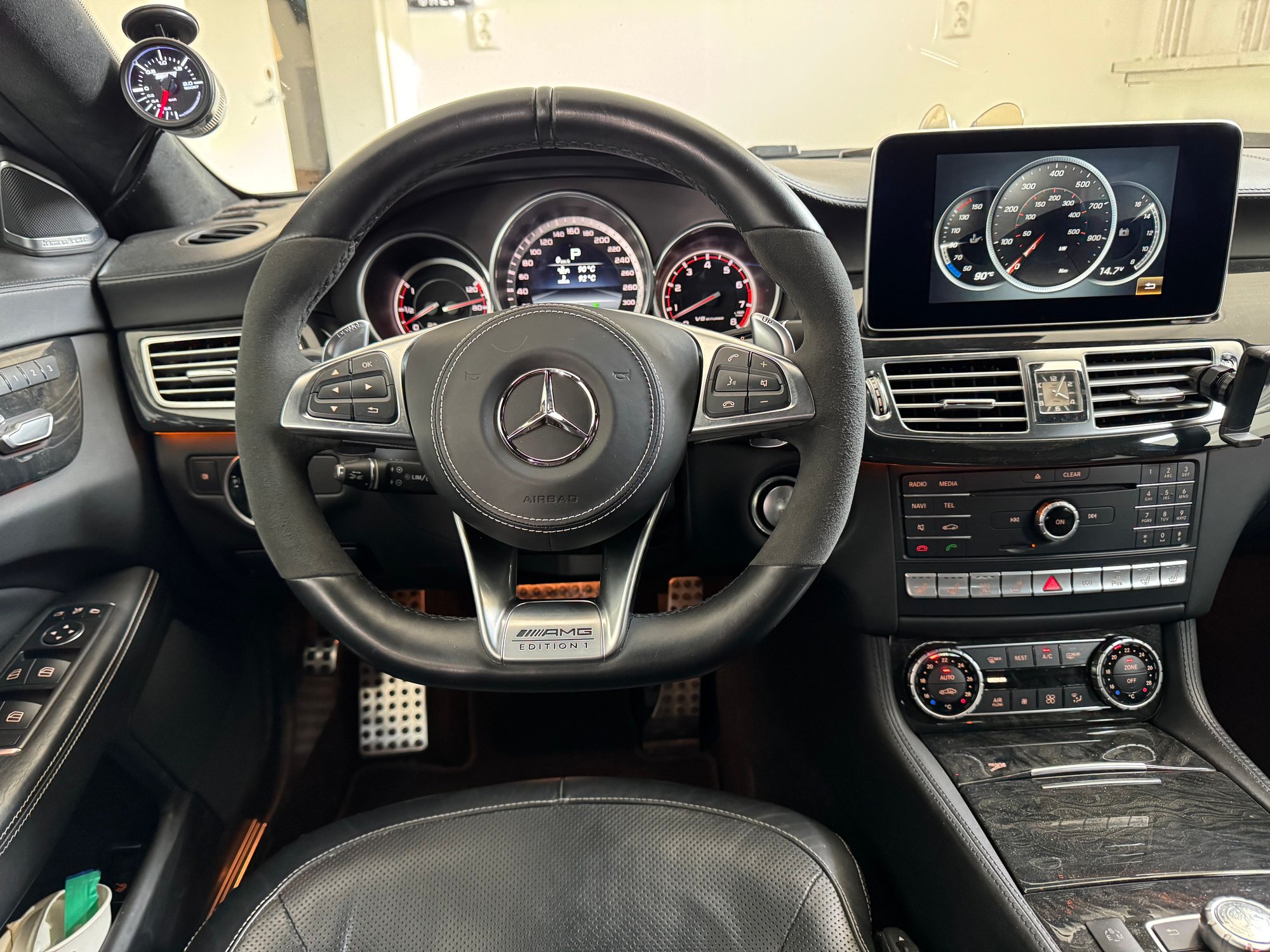

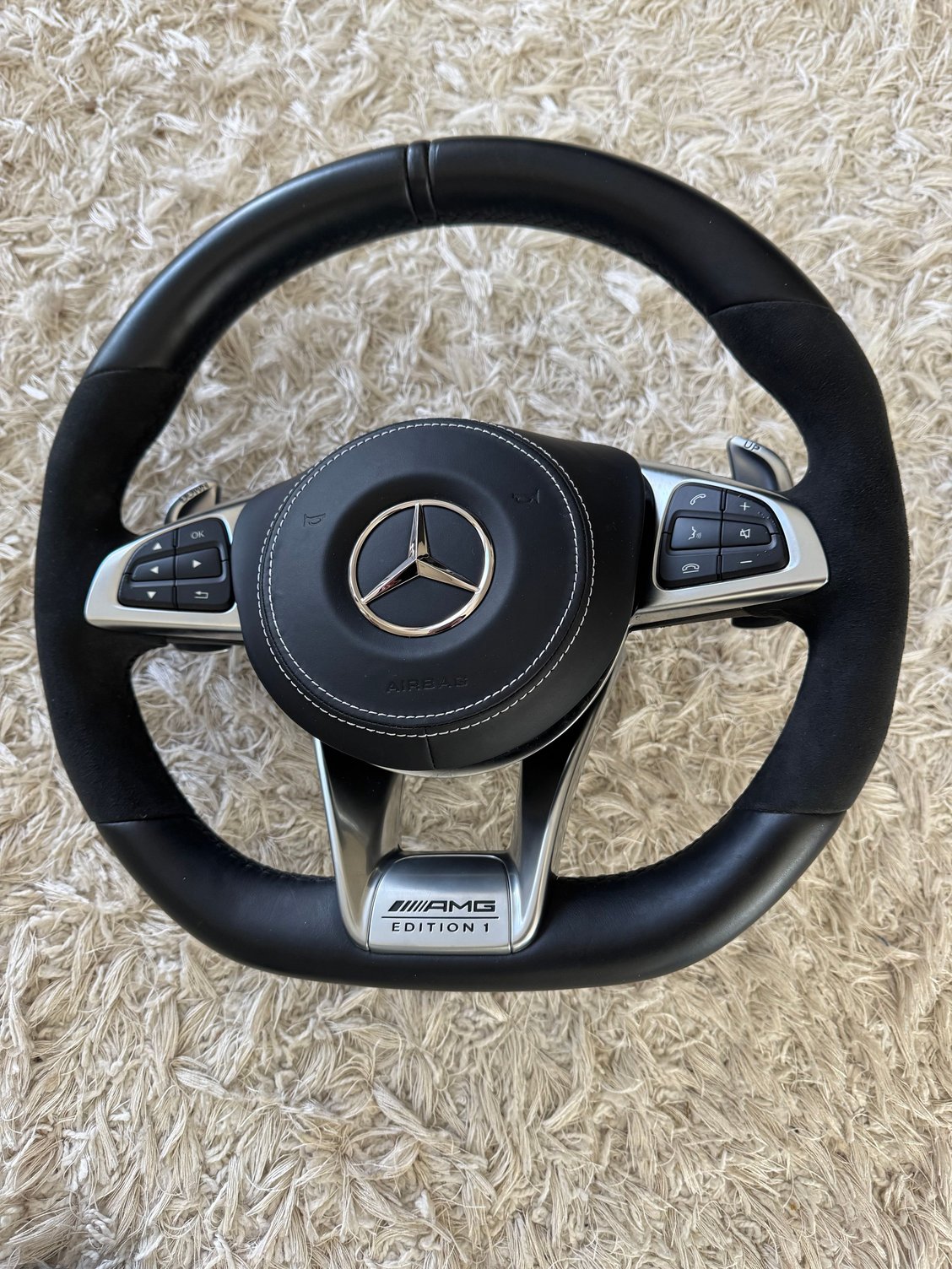

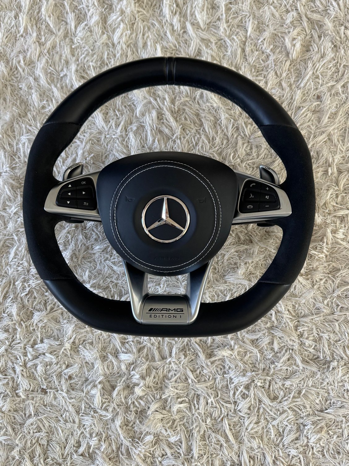

I did want to fresh up the interior a bit and bought steering wheel and airbag for it. Heh heh It's some kind weird tribute to my edition1 wheels.
Aluminium paddle shift extenders came along also, but I did take those away. Airbag is not fully its place in the pictures.

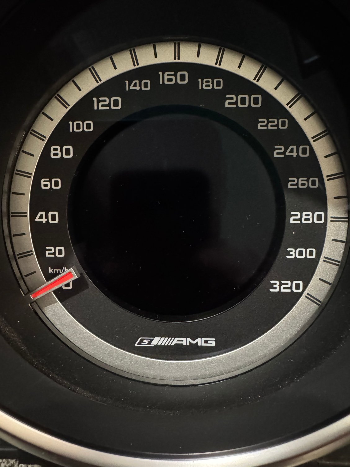

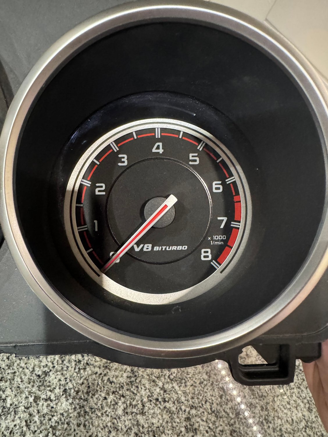

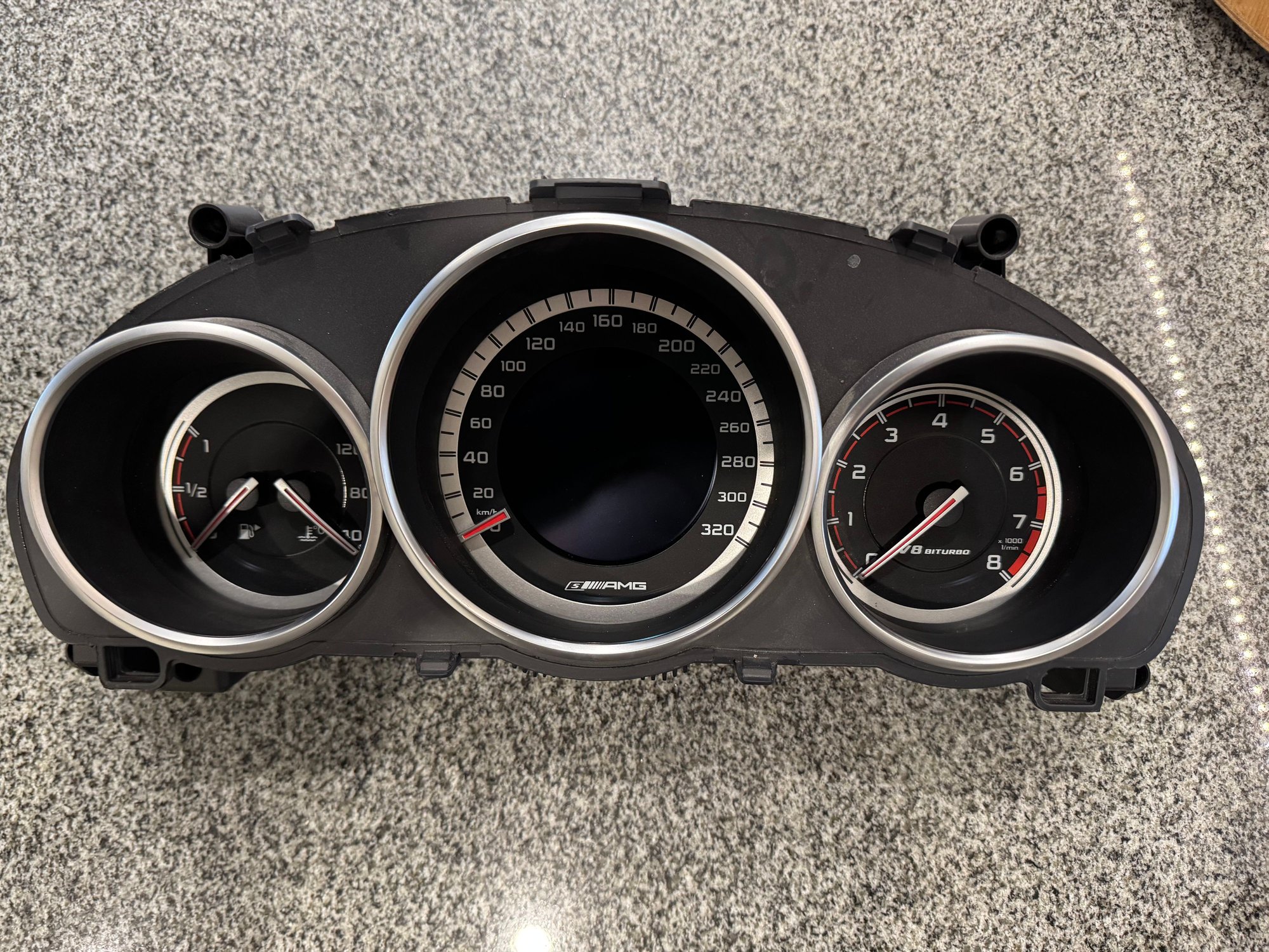

After the new steering wheel I thought that now the old white face speedometer won't look so good there anymore. So I did find E63 S model speedometer that will go in someday along with the steering wheel. Needs coding also.
Reply 0
May 9, 2026 | 09:32 AM
  #267
New steering wheel and AMG S models speedometer is installed. There are three different AMG speedometers. S model have the red light surrounding the little gauges etc.
Look is a bit fresher now, than it was.
AMG menus gauges are working also.
