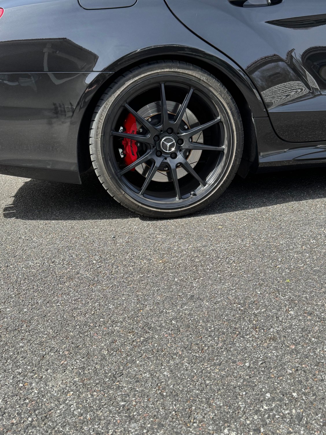

I have since found the answer to be 15mm wheel spacers (and new wheels courtesy of a pothole taking the old ones out)
buyers beware for these (and maybe a few other s class wheels too):
The fronts, though 8.5, don't have a shallow enough offset to clear the brakes without spacers. These wheels use 45mm lugbolts from mercedes, and so a spacer will require the lugnuts to be 45mm+spacer distance. I say this because the 15mm spacer i looked at all came with 45mm lugbolts, so I had to order 60mm lugnuts to get them to fit. I won't reccomend any specific brand since these haven't really had the chance to fail on me yet, but from what I understand most of the amazon ones will do. with the same setup but 9.5 in the rear it matches the body at the center of the wheel but tucks under when airmatic is all the way down (ie when it gets off the jack) so the tire isn't supporting that corner of the car.
Interestingly enough the 9.5 did fit on the pass side front, but hit the air strut on the drivers side. I think a 9 inch front is possible, but I'm not sure I'd go that far. These are 19in wheels.

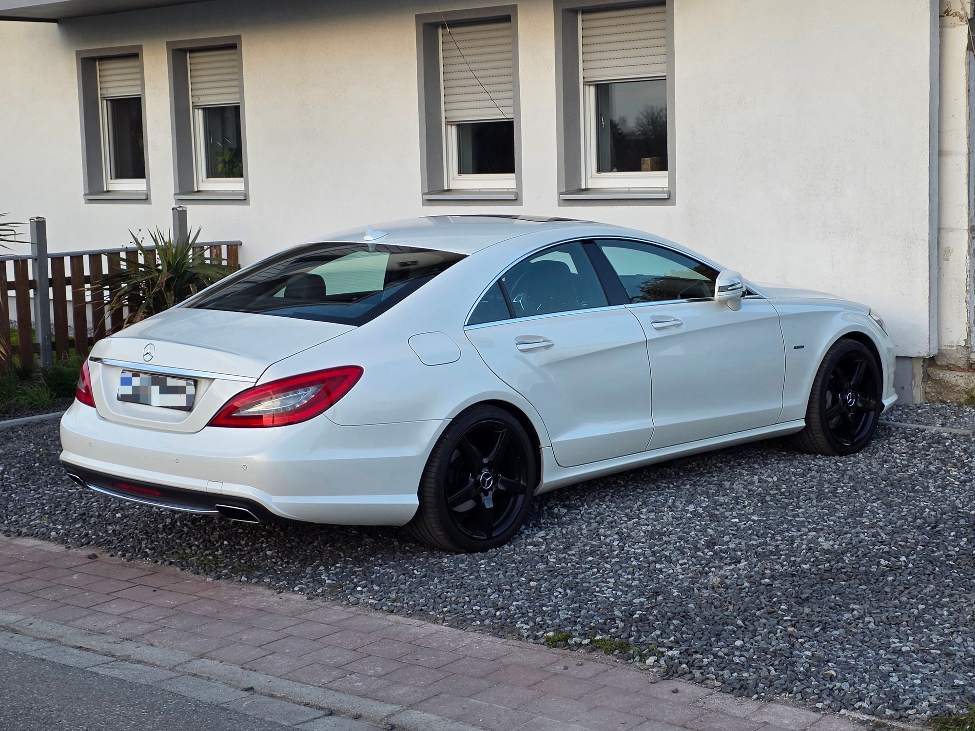

Hi Blazingrain,​To help you with the technical side: I’m running the original 19" AMG Line wheels on my W218.​Front: 8.5J x 19 ET34.5 (with 10mm spacers -> effective ET24.5)​Rear: 9.5J x 19 ET48 (with 20mm spacers -> effective ET28)​Regarding the bolts: I didn't want to guess either. I simply measured the original bolts and bought new ones that were exactly 10mm longer for the front and 20mm longer for the rear. It’s the safest way to ensure the correct thread engagement.​With this setup, I have zero issues with the air struts, and it was fully inspected and approved by the German TÜV. It sits perfectly flush and is 100% road legal and safe. Here is a photo of the result!

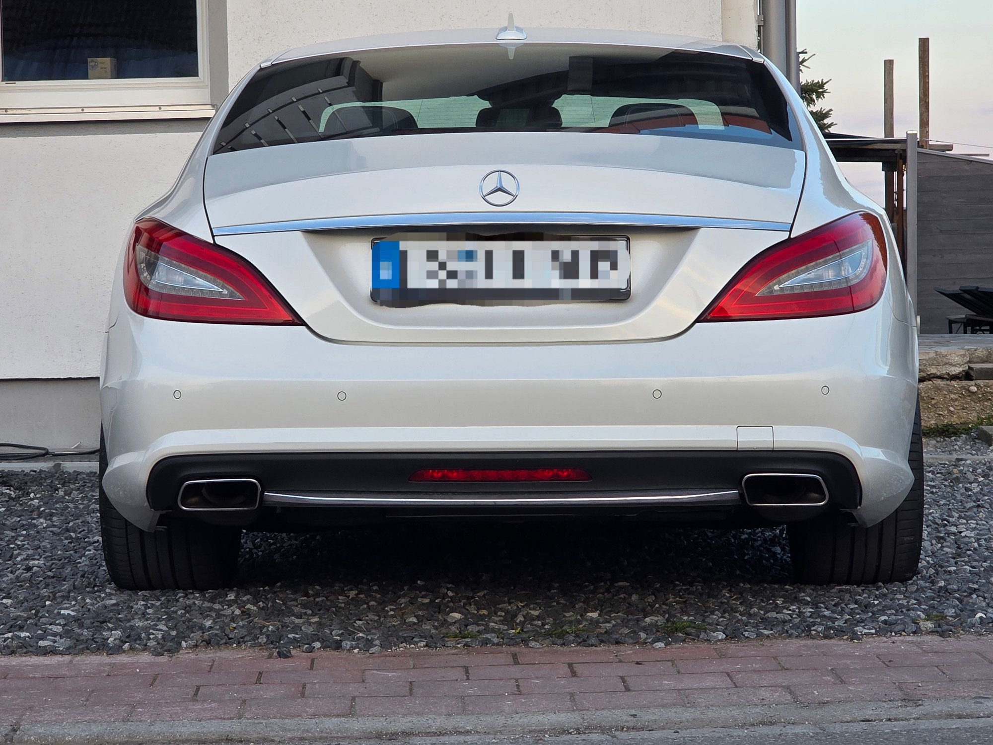

Woah, that looks awesome! I got my spacers in a set of 4 but now I'm wondering if 20mm on the rear is the way to go for my wheels. TUV approval is awesome; Texas doesn't even inspect for safety anymore (probably the only way I'm getting away with 60mm lugbolts). You've also made me realize I haven't taken it out for photos in a minute, but I found one from a local meet:
Sidenote- is the third brakelight being on the diffuser a European thing? I've never seen it like that on a CLS before but I love the look!

I was thinking about changing my rear diffuser, now I need to make sure it has the hole for that foglight! Theres even an adapter to hook it up with the rear taillights for the American cars. I am appreciative of how much freedom in modding we have here in Texas, although over here tuning a benz is 10% work 90% saving up for the tune (the plug in ones start at $1300 (1100 euros) without a dyno run!). It is nice not worrying about getting pulled over for a resonator delete though.

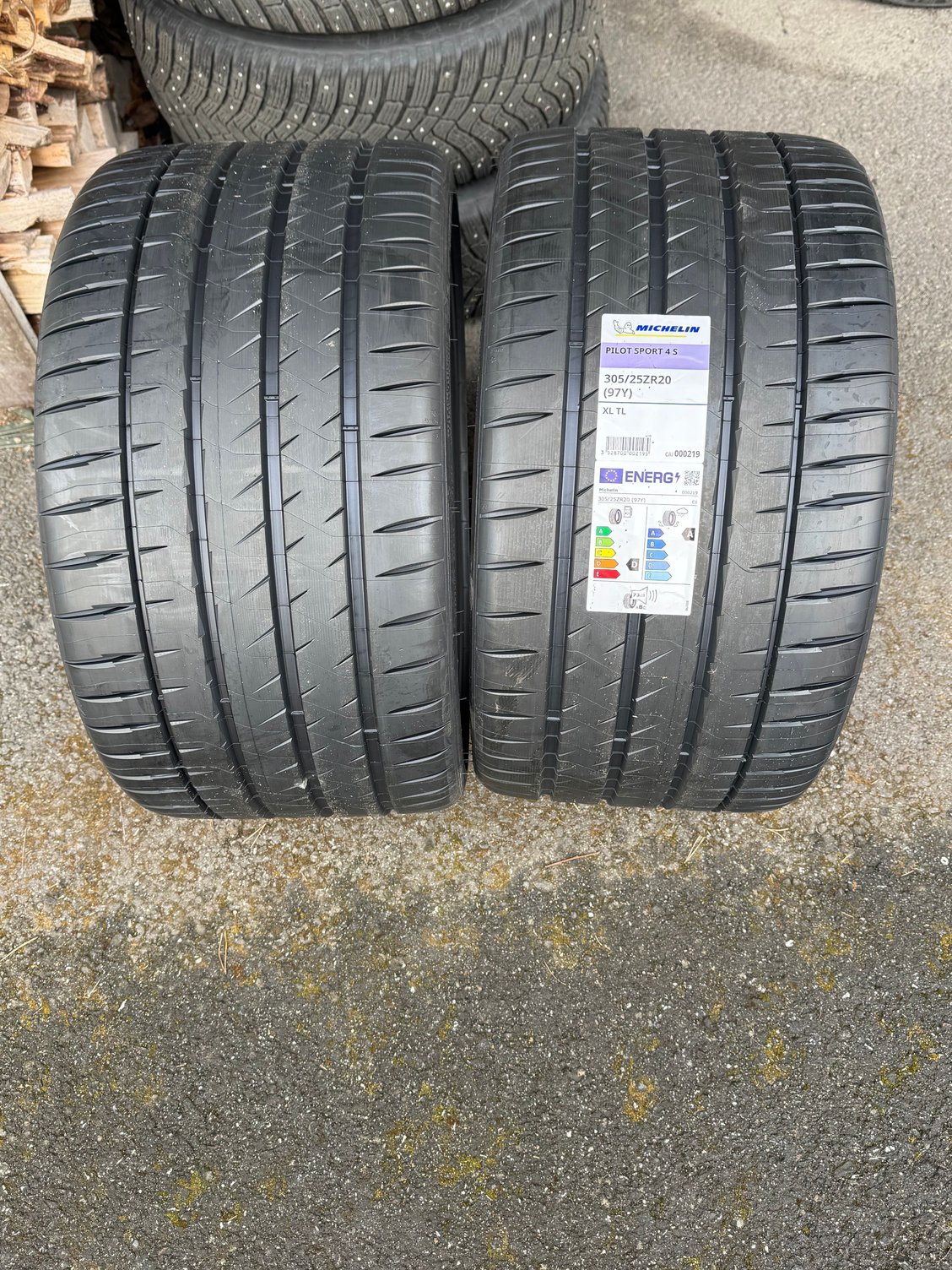

CLS can take pretty low ET wheels and wide tires. If ultimate grip is needed even 305 will fit in rear. I have now 20" x 10,5 ET52 + 15mm spacer in rear and fits nice.

Wow, that fitment looks absolutely spot on! 305s in the rear give it a ridiculously aggressive stance.​But honestly, with my 265 HP and 620 Nm of torque, my 4Matic and the stock tires are more than enough to handle the power! 😂

Okey, I haven't ever drive RWD CLS500 but can be hard to keep on the road when tuned lot. I have 4-matic and still need the 305 Michelin ps4s due about 1200nm torque that it will need to handle.
