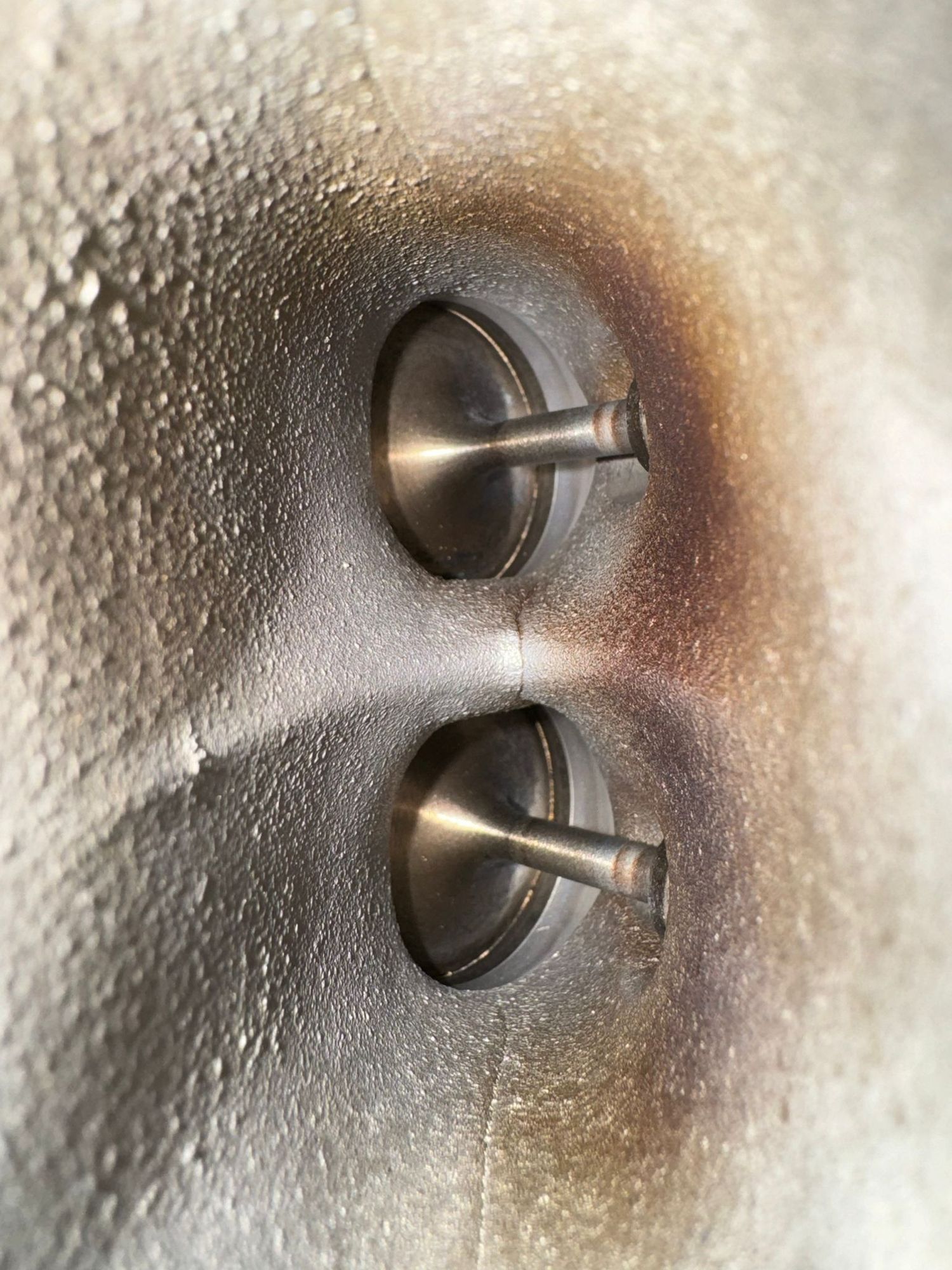

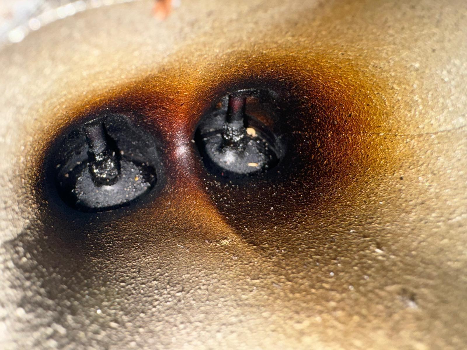

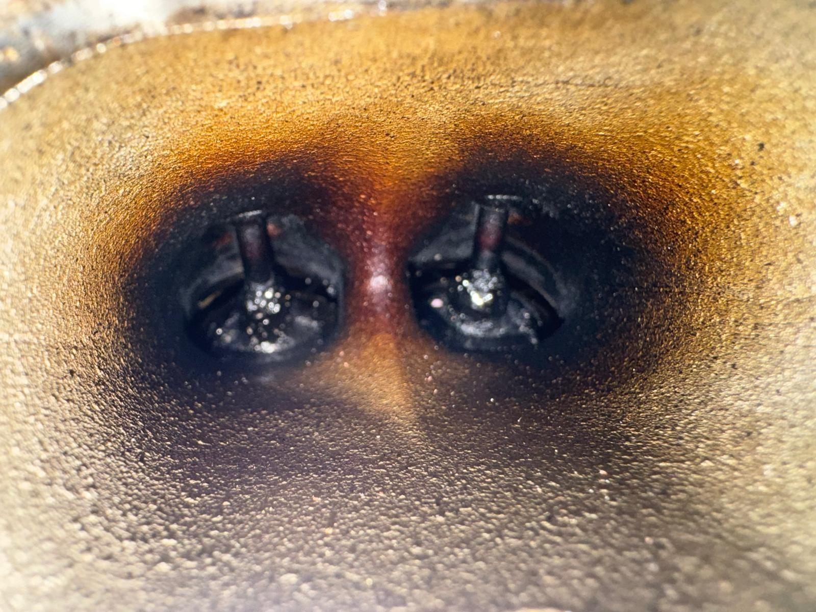

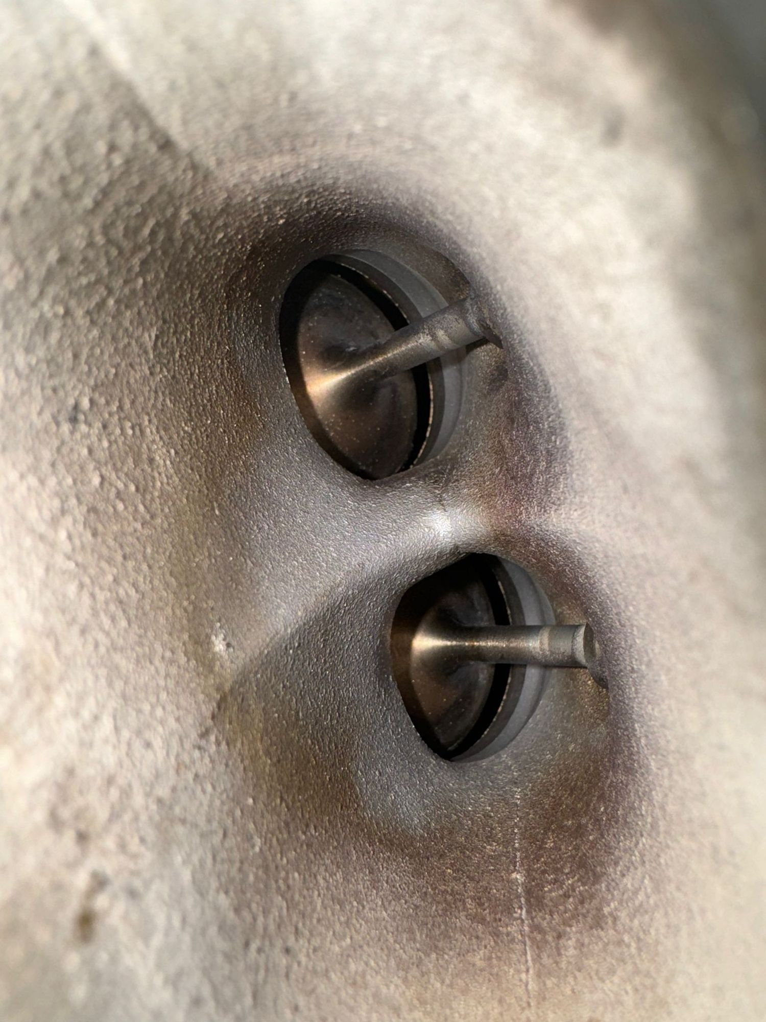

So the walnut blasting is now done. Here is some pictures before and after. Some intake valves were better some worse. But about looking like these. For my opinion it's quite a lot carbon built there.
And after walnut blasting

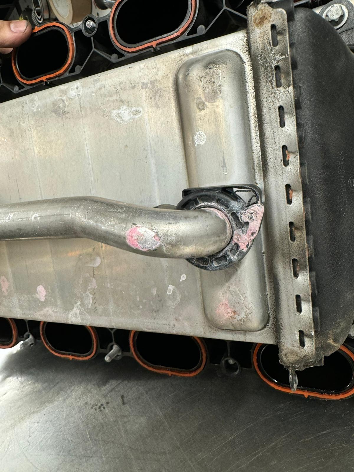

Also I did found out where my missing IC liquid have gone in past years. So I need one O ring from Germany to get the car back on the road.

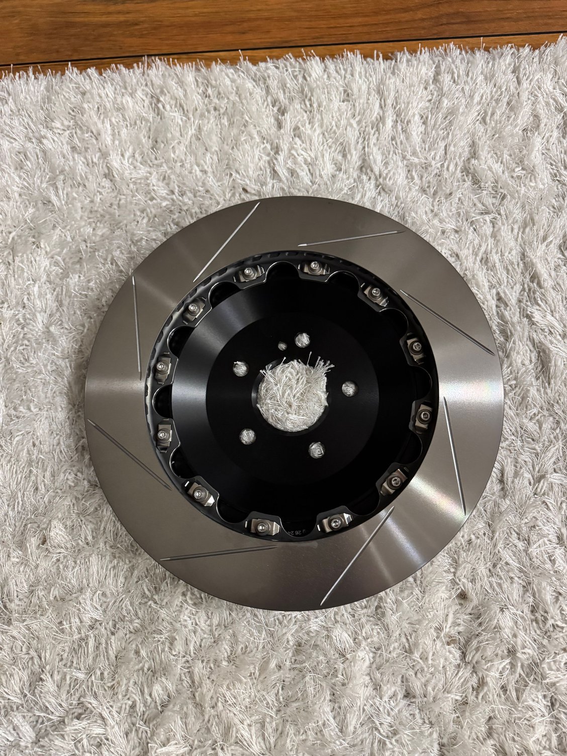

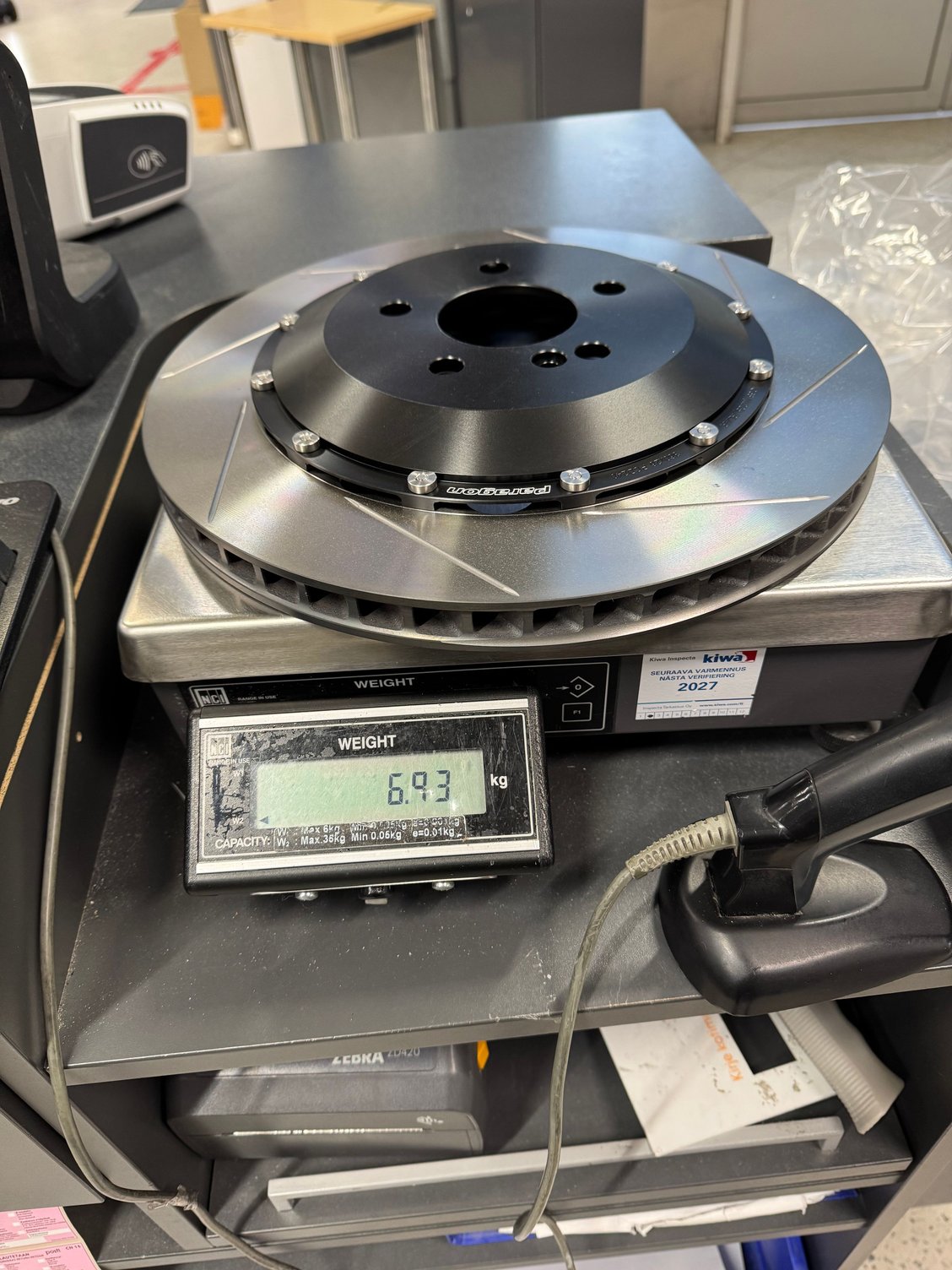

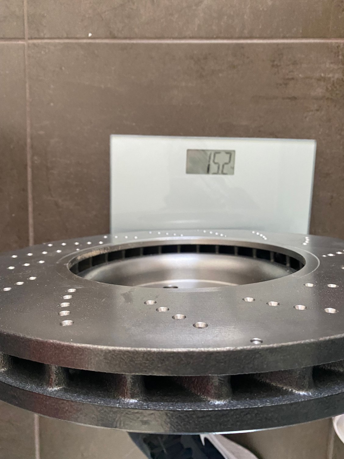

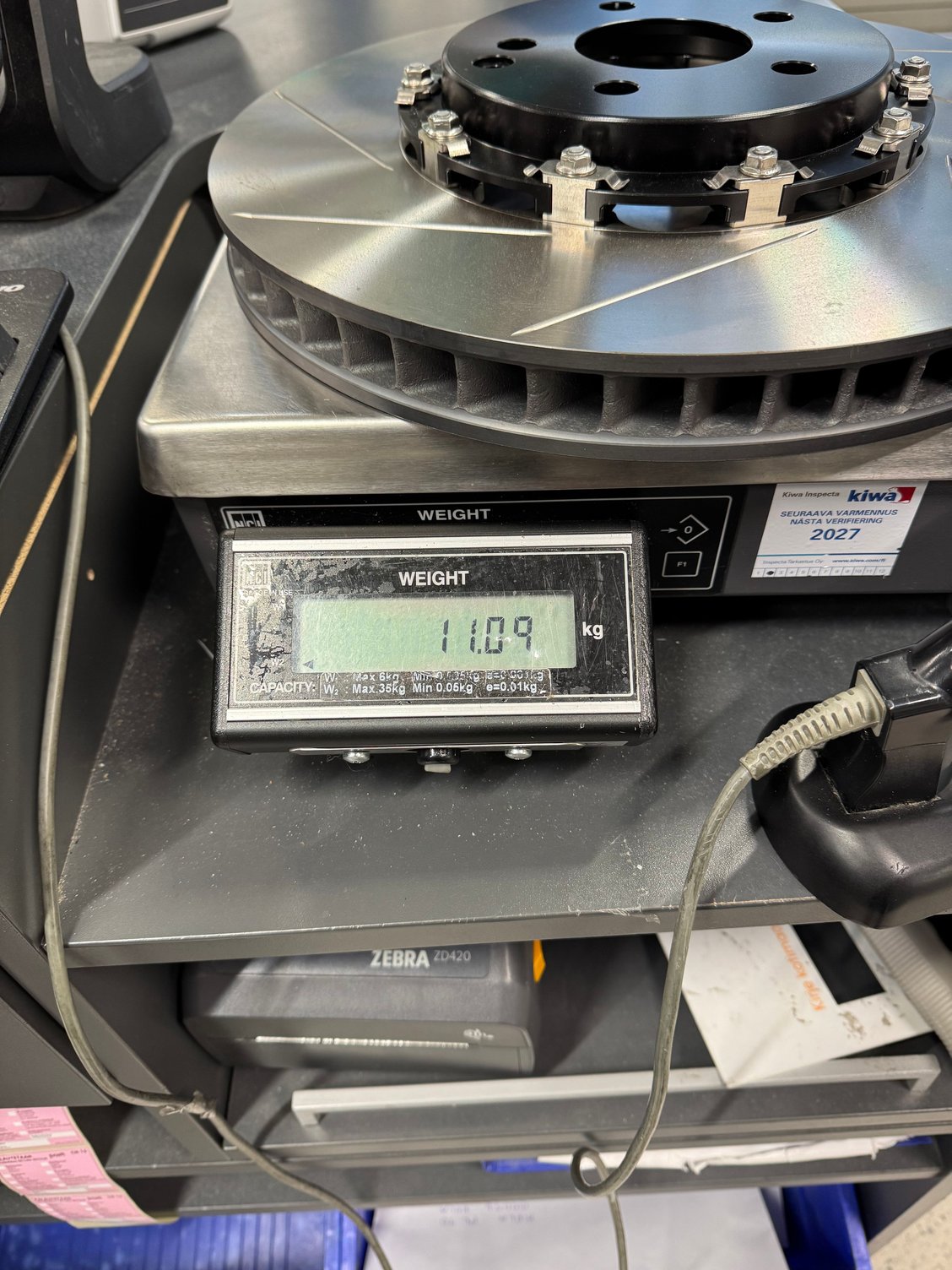

My next to do list are brakes. I have Brembo one piece discs in the front and on the rear are AMG upgrade calibers and AMG Brembo discs. Guess how much those weight? Yes, a lot. Front disc is 15,2kg! and rear is 10,9kg. Here are the pictures. (Ididnt weight the rear disc before install back in the day, but here is the weight from webpage.
Brembo
Brembo OEM rear
Brembo OEM rear

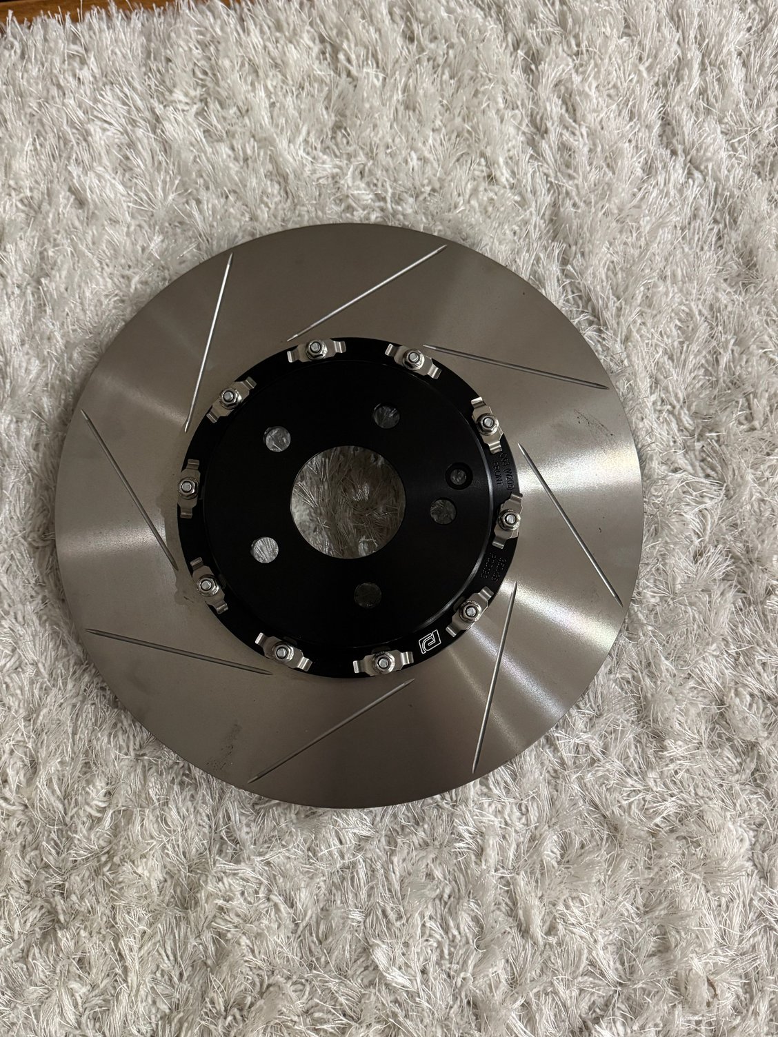

I did bought lighter and better discs from Paragon. Looking to be astounding quality and really light weight! Front disc is 11,1kg and rear is 6,9kg. So its 4kg/8,8lbs weight reduce in one corner. Totally over 16kg/35lbs rotating mass shaved off! Im thinking that braking distance will be much shorter, acceleration will be quicker and suspension will work better after this. I hope we can install these in next week if the winter won't hit here bad!
Paragon front
Paragon front
Paragon front
Paragon rear
Paragon rear
Old Nov 13, 2024 | 09:55 AM
  #225
Siegmann's Avatar
Joined: Sep 2018
Posts: 961
Likes: 103
10-second E550
Brembo
Brembo OEM rear
Brembo OEM rear
Paragon front
Paragon front
Paragon front
Paragon rear
Paragon rear
Those look super nice!
