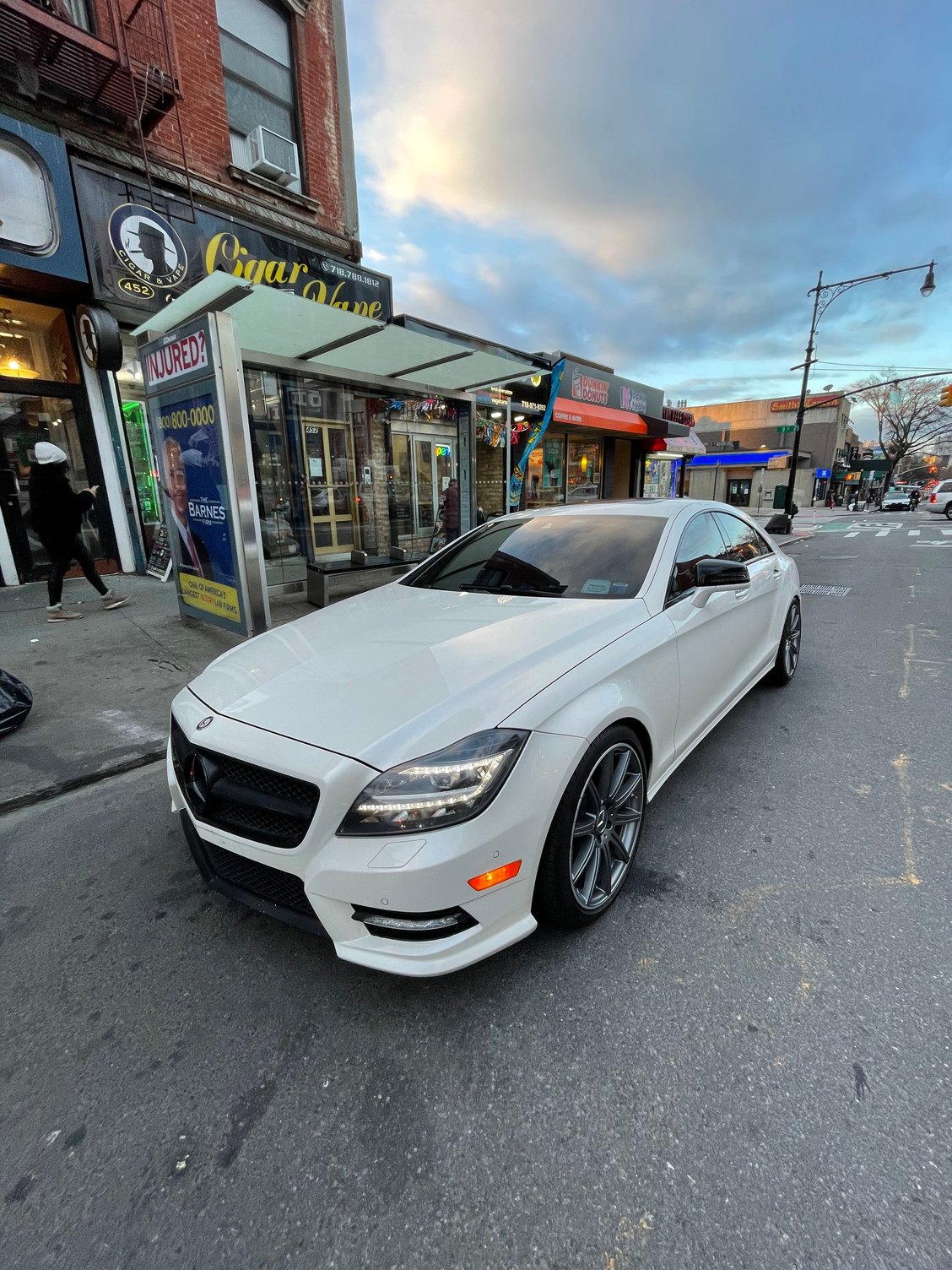

Hello everyone,
just bought some genuine cls 63 wheels for my cls 550. They came off a cls 63 and already balanced . Love the look and everything but when I get on the highway around 45mph and hit a bump or a pot hole my car wobbles, it doesn’t shake at all, steering wheel is straight just the wobble. Any ideas what it could be? Thanks
