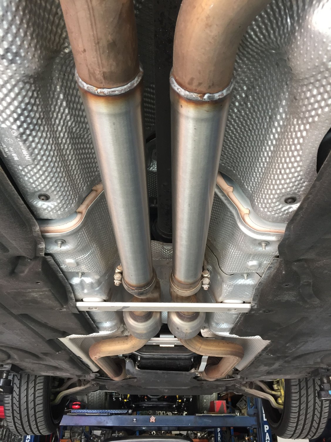

I did a resonator delete like Beer_Bandit (cut the box out and replaced with stainless steel straight pipes) - car sounds awesome without being obnoxious. Low RPM has a little more V8 grumble to it and if you step on it in 2rd or 3rd in Sport mode it sounds exactly like I think a 4.7L V8 should. Even get a little turbo whoosh when slowing down from a rev. I would start with modifying the resonator either to X-pipe or straight pipe and cut out the secondary cats next if you want more sound. Could also do electronic cutouts if you want a straight-pipe feel with the ability to toggle back to regular. I would leave the mufflers alone unless you were to get high-flow ones but that's just my opinion
