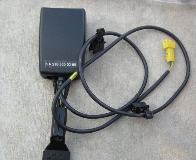

To start check seat belt connections @ belt connector, and yellow connector/pins under seat raise seat to highest position. Attached seat removal instructions if need be.
