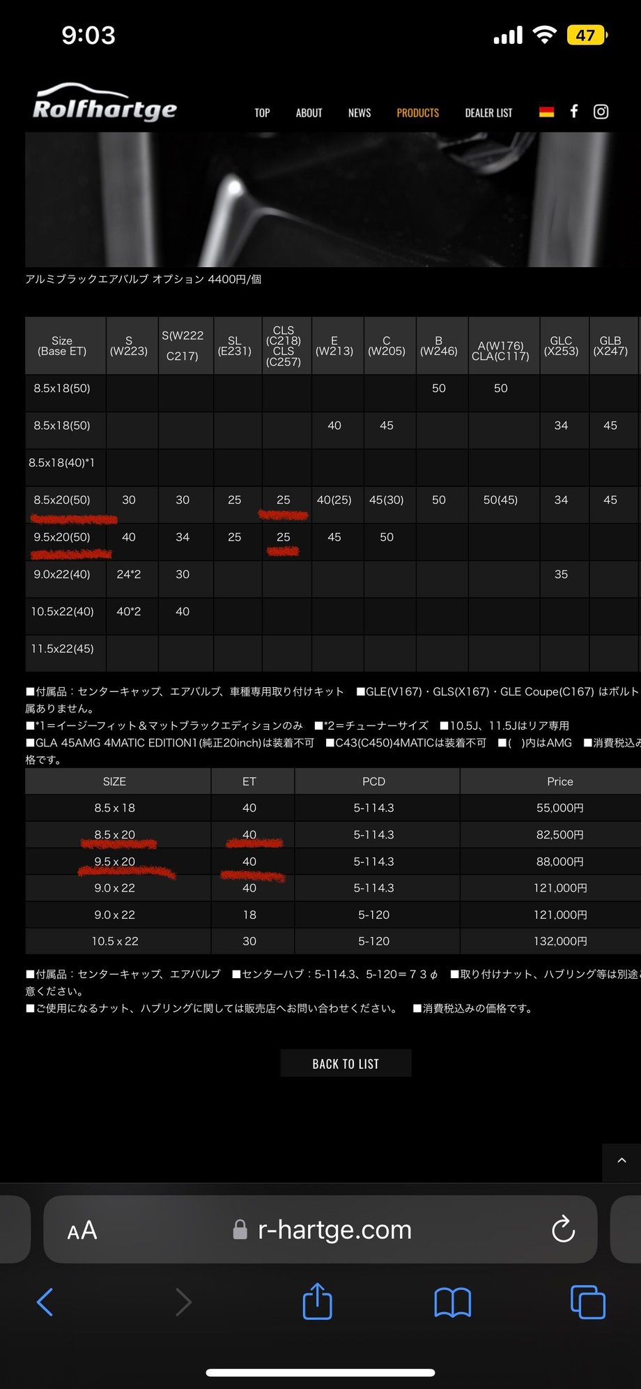

I will also add a pic about the tires information and etc.

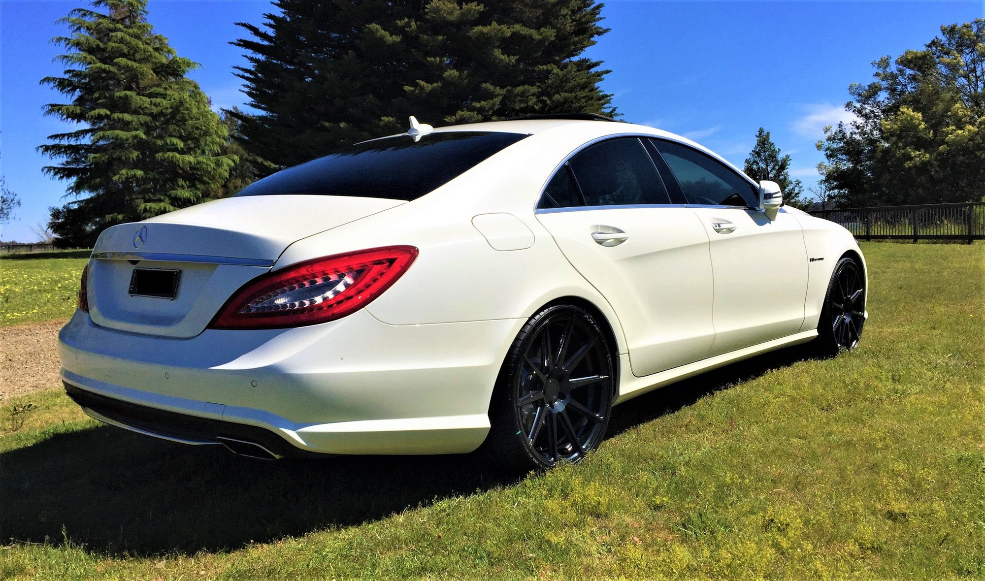

I have:
Rims: (F) 20x9S +28 (R) 20x10C +35
Tyres: (F) 255/30/20 & (R) 295/25/20
No rubbing.

I have:
No rubbing.

well your front wheels are supposed to be 8.5x20 +40? That offset seems way too high. You can see the rest of us are +25 / +28
No, I mean the offsets could be raised up to 40 said by the manufacturer.
The recommended offset for the wheels is 25 on front and 25 on back. You think I should raise the back to 28?
