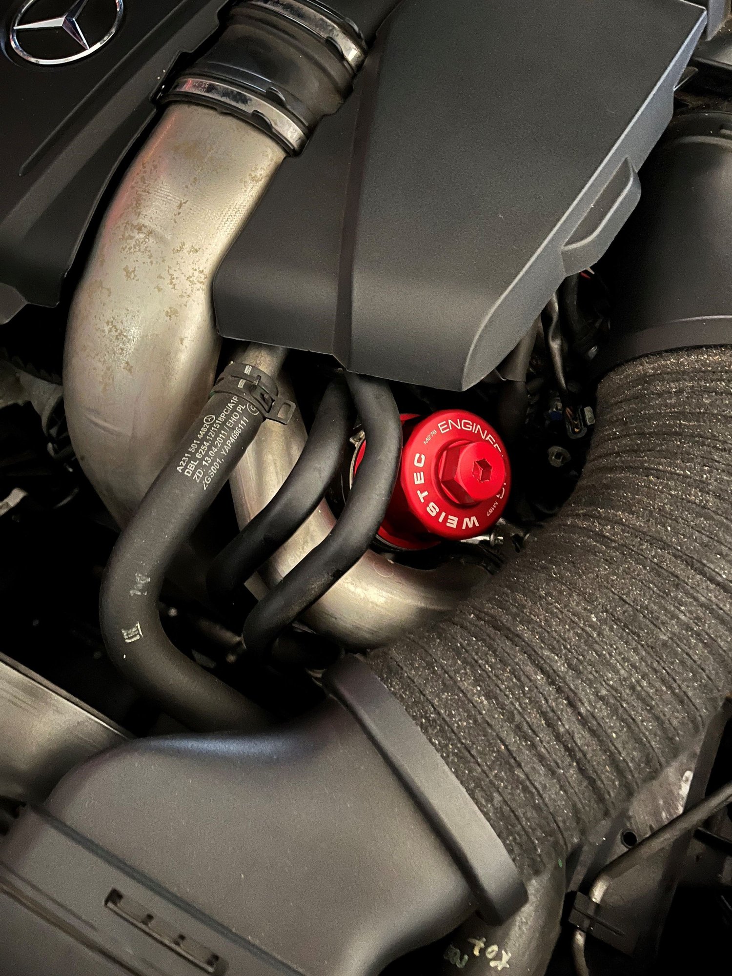

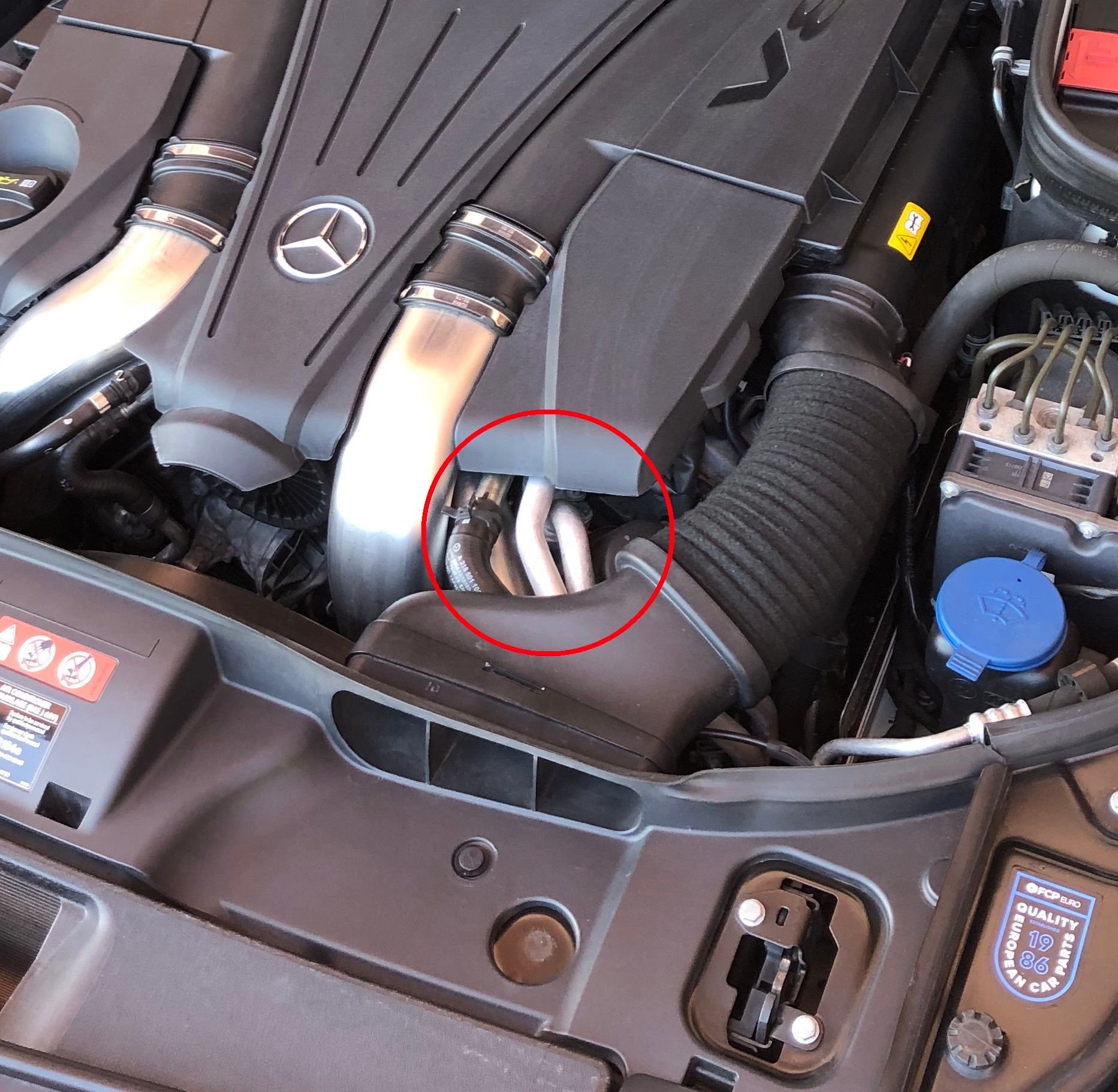

Hi!
I've tried doing research on my own about this topic but haven't been able to find anything definitive, just some people's best guesses. To be brief, I want to know if anyone else has the additional cooling measures (Code 139 on their data card) for the oil cooling? The first picture below is of a standard M278 without the additional cooling, the second pic is of my engine with the 139 cooling code, and the last is the M157 from an AMG. It appears as though the M278s with the additional oil cooling has the same setup as the M157, but I've never seen another M278 with this in place on YouTube, vehicle sale listings, or technical documentation. I have Xentry and no technical documents show this setup on an M278. Anybody else have this on their M278?
To be specific, the differences are the two additional oil lines coming into the top of the filter housing to the left of the oil filter cap. The AMG pic, the last one, has them in a red box.
Standard M278
Standard M278
My M278
My M278
AMG/M157
AMG/M157

I have them.

You're the only other person I've seen that has them! Have you ran your VIN through a VIN decoder to get a vehicle data card? I ran mine through https://www.lastvin.com and have the code 139. I'm curious about the benefits this might have compared to the cars without it.

My 2014 SL550 with the M278 has these lines. They are black aluminum and not the silver colored lines. I do not have the 139 code in my build sheet.

I have run the VIN and have the data card, I DON'T have that code.

I have those two silver lines on mine as well and DO NOT have the code of 139 according to LastVin.

That is so wrong! I couldn't edit it either to fix my wrong info. I've had my car now 3 weeks and been reading a bunch and got a lot of good info from a Mercedes Master Tech. I found out this is the cooling from the M157 from a revised update for more oil flow pressure and cooling the engine also to aid in the cylinder wall scoring issue. I found this out while doing a oil change. The oil filter I bought had a stem on the bottom what K&N said was the right one. The filter in my car was just a cartridge filter no stem this filter had Hengist AMG Mercedes and part # on the bottom. The oil housing cap with the 27mm hex design also has Hengsit on it too. The later M278s have this I was told and that's what those added lines are for the added oil flow. I'm glad we have this on our M278s.

Wow, I have no idea how I'm seeing this over a year later, but that's great info to have! I have a 2012, I'm surprised that that is in place on such an early variant of the M278. Did your master tech happen to say when that started to appear on them? I've only ever seen this present on the M157s, even really good 3rd-party performance shops like VRP have stated that my engine doesn't have the same cooling measures, so it doesn't sound super common?
Again, thank you for that info - really appreciate it. Next time I'm in there I'll have to get my borescope out and see if I have any considerable scoring at 110k miles.
