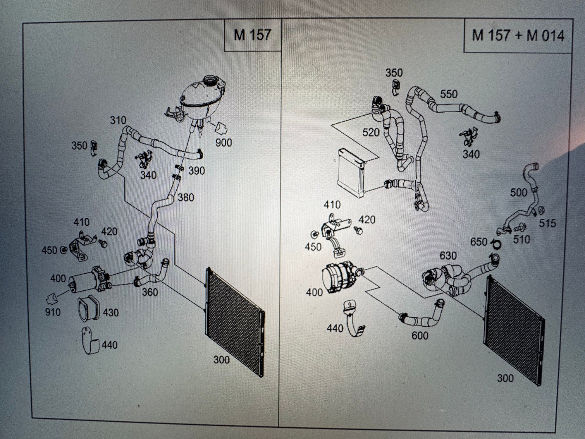

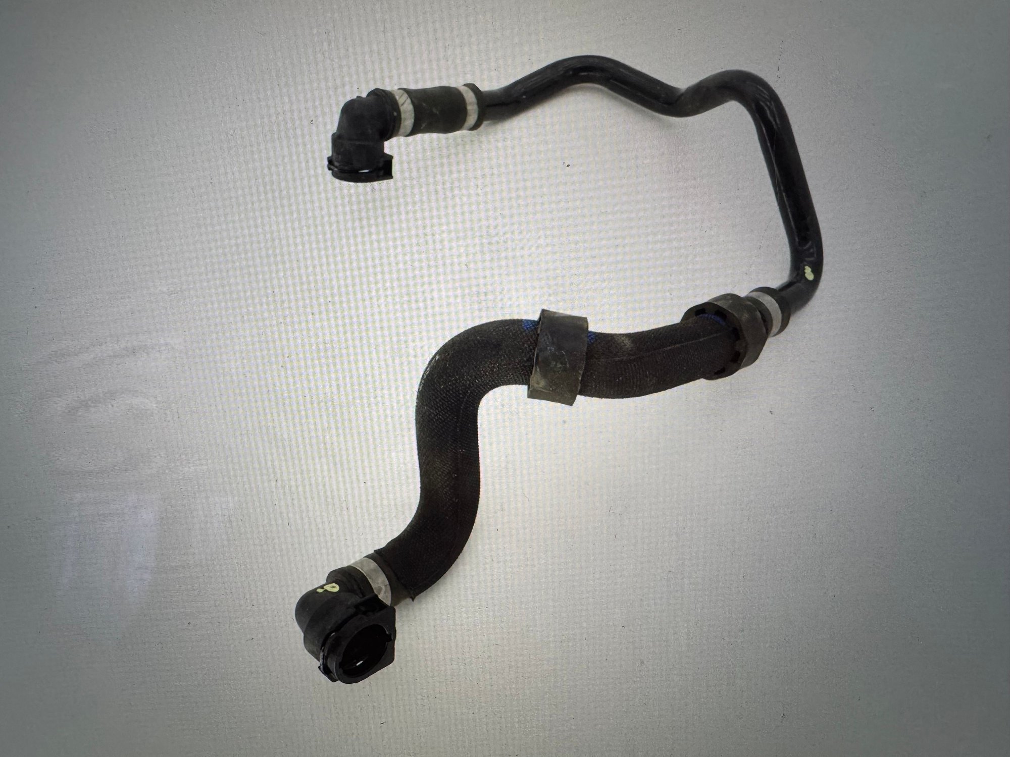

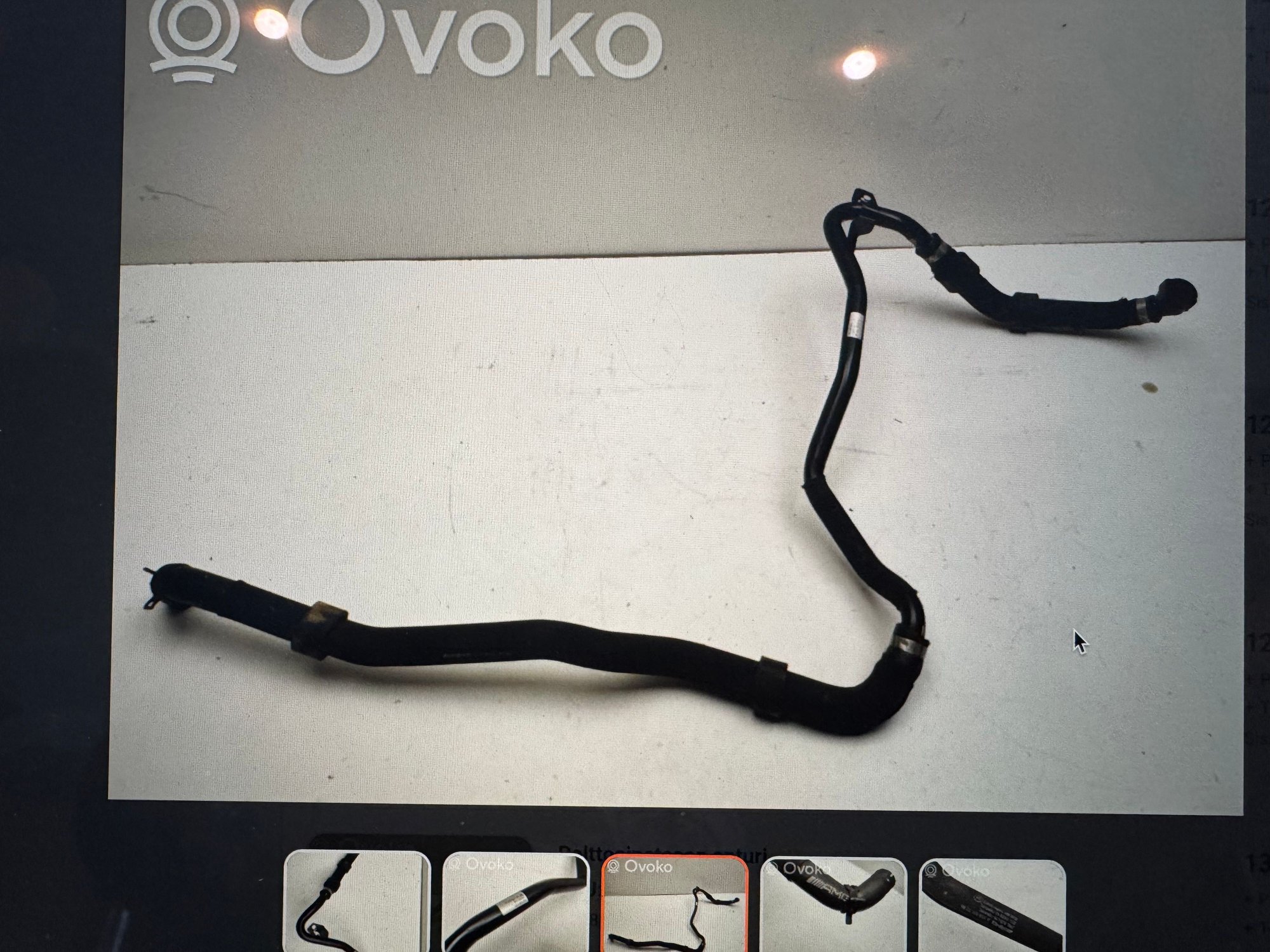

Here are the IC cooling systems side to side. Base M157 vs. M157 S ( M157 + M 014)
Now we can see that the extra (smaller) HE lower hose would go to the intercooler. Looks so.. It's number 550 in the picture. And that hose part number is A2125017284. (Only S models)
I haven't found what part number hose will go from CWA100 to extra HE. Just found a part of the hose. It's number 600 in the picture. Part number is A2125017084. (Only S models)
This confuses me what kind of hose set is that picture 520? is it connected to the 600 somehow? Must be for what I think.
M157 vs M157 S ( M157 + M 014)
In the hose diagram 550. Part number A2125017284.
In hose diagram number 600. Part number A2125017084.

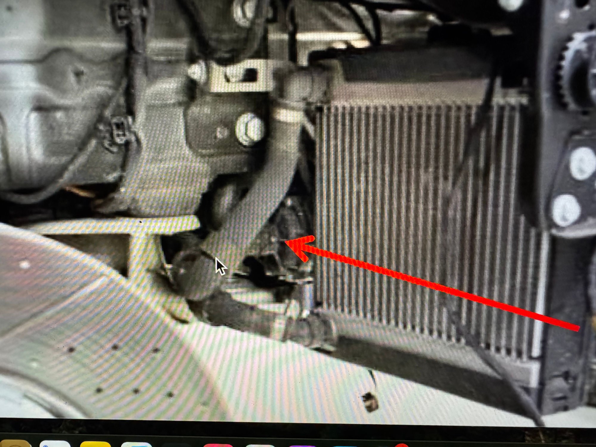

Here is one picture that I found from net. But can't see straight where the IC pump hose is connected to Heat exchanger.. In that M157 + M014 IC system pictures that long hose 550 that I linked picture looks like to be connected to heat exchangers lower connector. Still no clue what is the part number for hose 520 that should go from IC pump to this heat exchanger. All other part numbers are clear.

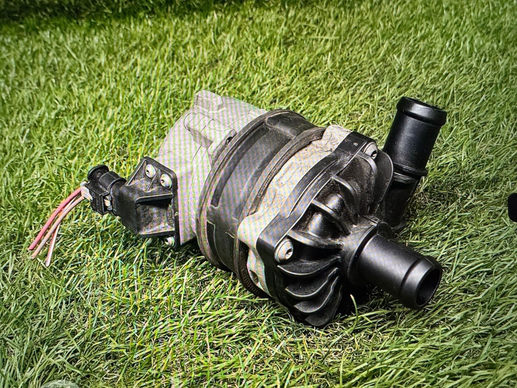

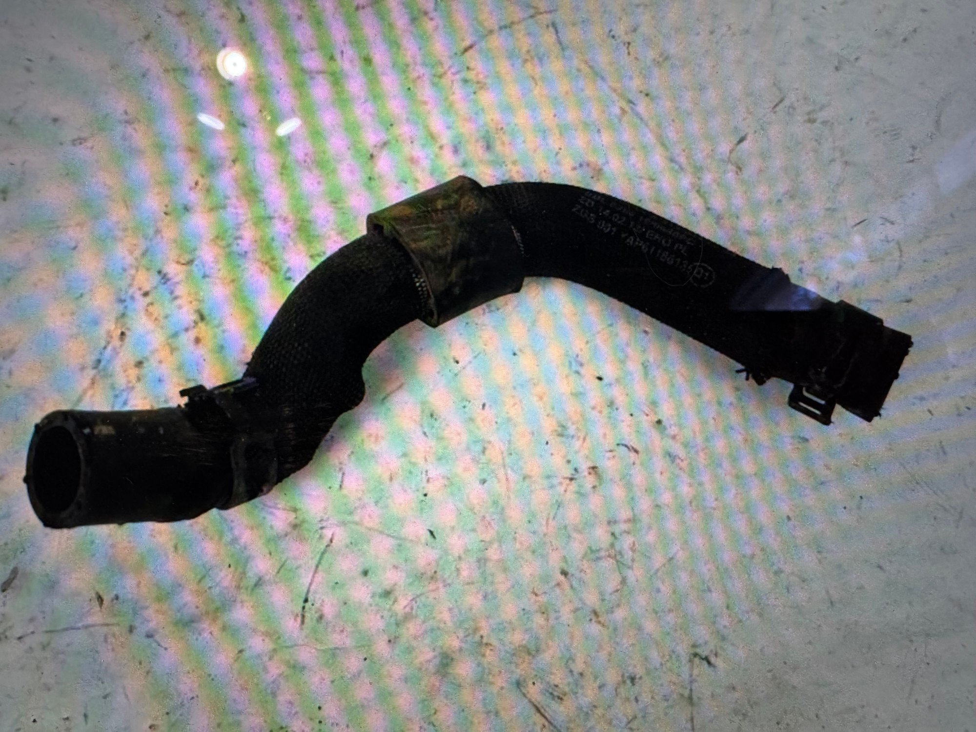

Now I know what hose is that upper HE hose. This is solved now. Here is the part number A2125015484. It have the same connection style to CWA100 like to extra IC HE. Also now we can be sure that hose from CWA100 is connected to extra IC HE upper side and lower connected to main IC. So AI was wrong in this case.
CWA100
CWA100
A2125015484. Upper HE hose.
