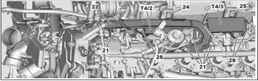

2018 AMG GTR Spark Plug Replacement
RIGHT SIDE
  • Remove Turbo covers
  • Remove Vacuum Hose (1)
  • Move ME-SFI unit out of the way (5)
  • Unclip bleed line (2) and set to the side
  • Remove screws (19) from harness (4)
  • Disconnect (3) and place harness to the side
  • Remove bolts (5) and strut (6)
  • Remove soundproofing (7) to the right of the big pressure fuel pump
  • Relieve fuel pressure from port (5) below - STILL LOOKING FOR PROPER TOOL/HOSE TO DO THIS
  • Unclip harness (4) from fuel line (14) below
  • Remove the bracket of the field line (14) from the cylinder head cover
  • Remove fuel line (14) and seal holes
  • Remove screws (15), remove bleed line (16), seal openings
  • Release electrical connector (17), (23), (28)
  • Remove screws (26), (27)
  • Remove right side coil packs
  • Reassemble in reverse order before going to other side
    • Spark plug to head 22Nm
    • M6x1 9Nm
    • Vent line to cylinder head, Fuel line to engine, ignition coil to head, 9Nm
    • Union nut for fuel line 22Nm
    • Cross member and front reinforcement M8 30Nm
LEFT SIDE
  • Remove seal (34)
  • Unclip wiring harness (8) from sidewall (9)
  • Remove vacuum line (10) from booster and move upward, seal it
  • Remove screws (11)
  • Unscrew nut (12), lift sidewall (9), remove grommet (13), remove sidewall (9) upward
  • Unclip vacuum line and wiring harness (4) from bleed line (22)
  • Release connector (18), move harness (4) to the side
  • Lift soundproofing
  • Remove screw (20) and move harness (4)
  • Unscrew (21) and remove bleed line (22), seal openings
  • Remove screws (2) and place bracket with filter and sensor to one side
  • Release connectors (24,25), unscrew (28,29) and remove both coils
  • Reassemble Left side
    • M6, crank ventilation to head, ignition coil to head, wing harness to head 9Nm
    • Partition wall to body 7Nm
