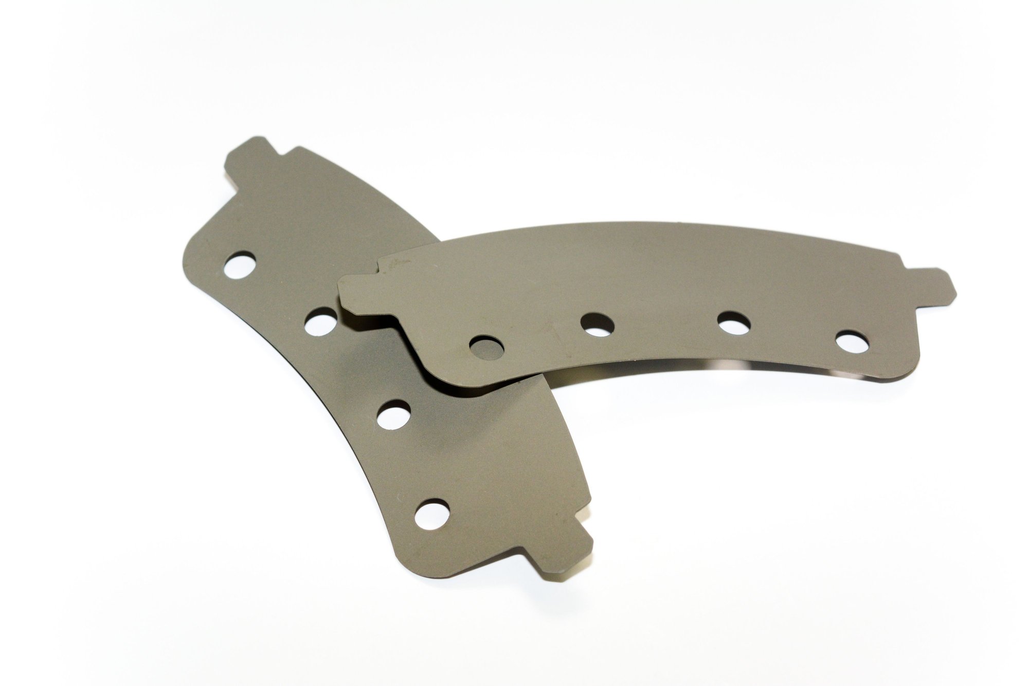

These brake pads shims are cut from 0.5mm Titanium 6Al-4V (Grade 5) which offers the lowest thermal conductivity of any titanium. In addition, they're coated with a ceramic thermal barrier to further prevent heat transfer to the brake caliper, pistons and fluid. The coating used for these shims is the same as what is used on high performance pistons.
The pair shown are for the rear. Great for the guys that like to keep the traction control on to keep the brake temps in check and the fluid from boiling. It's the same fitment for carbon ceramics or iron brakes.
I'm still working on making the rear brake ducts for our cars.

Originally Posted by ronac
These just came in.
Ron,
Price and availability?
Bish

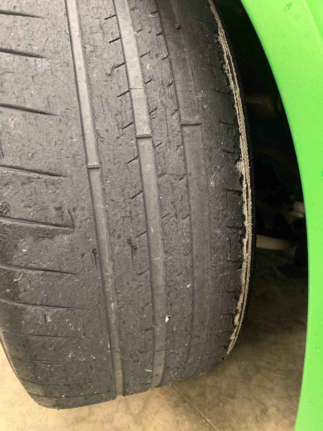

Tires after 2 track days.
Hello all. I bought my AMG GTR w 2,000 miles on the clock. Currently about 5,000 miles. The only track available after Hurricane Maria here in PR is a 1.4 mile track with really abrasive surface. Car was a pleasure to drive and I didn’t even scratch the limits of the car. I did cord the front tires which might be normal given the abrasive surface and the mileage. Could this be from bad alignment or just normal track wear?
Right front tire
Left front tire

Do you know if the previous owner tracked the car and also do you know if that is stock alignment?

That’s an alignment issue for sure; probably the Toe is out and I bet you could use more negative camber also.
Find a a really good race shop; buy a couple of boxes of the OEM shims and have them give you a great street/track alignment.
Good luck
