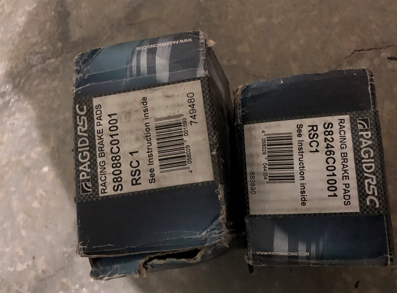

I don't mean to hijack this thread, just thought someone here might need it.
Is anyone interested in some GT R CC track pads and stock pads? I sold my car, don't need them anymore.
I don't know where to get it in the US, so I personally ordered it in Germany and brought it back while I was doing the RING trip last year, put on the car for 200 miles but never got to track it. These pads are very friendly to the rotor and have way better heat resistance comparing to the stock pads.
http://www.pagidracing.com/en/produc...rsc/rsc-1.html
Stock pads are brand new.

Pricing and pix of the RSC1s?
