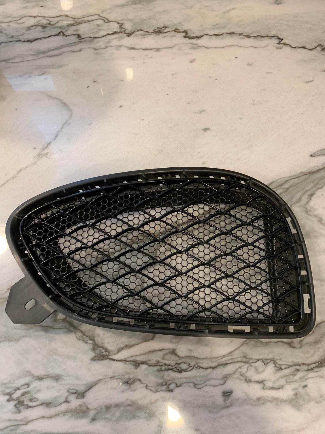

After reading some of the other threads on the topic, and dealing with the amount of road debris we have here in Dallas, I researched and ordered some mesh that fit the style and material I wanted, and it just came in yesterday. Since the weather was garbage for driving, I figured I'd dive into a bumper removal and mesh install, and so far I'm VERY happy with it.

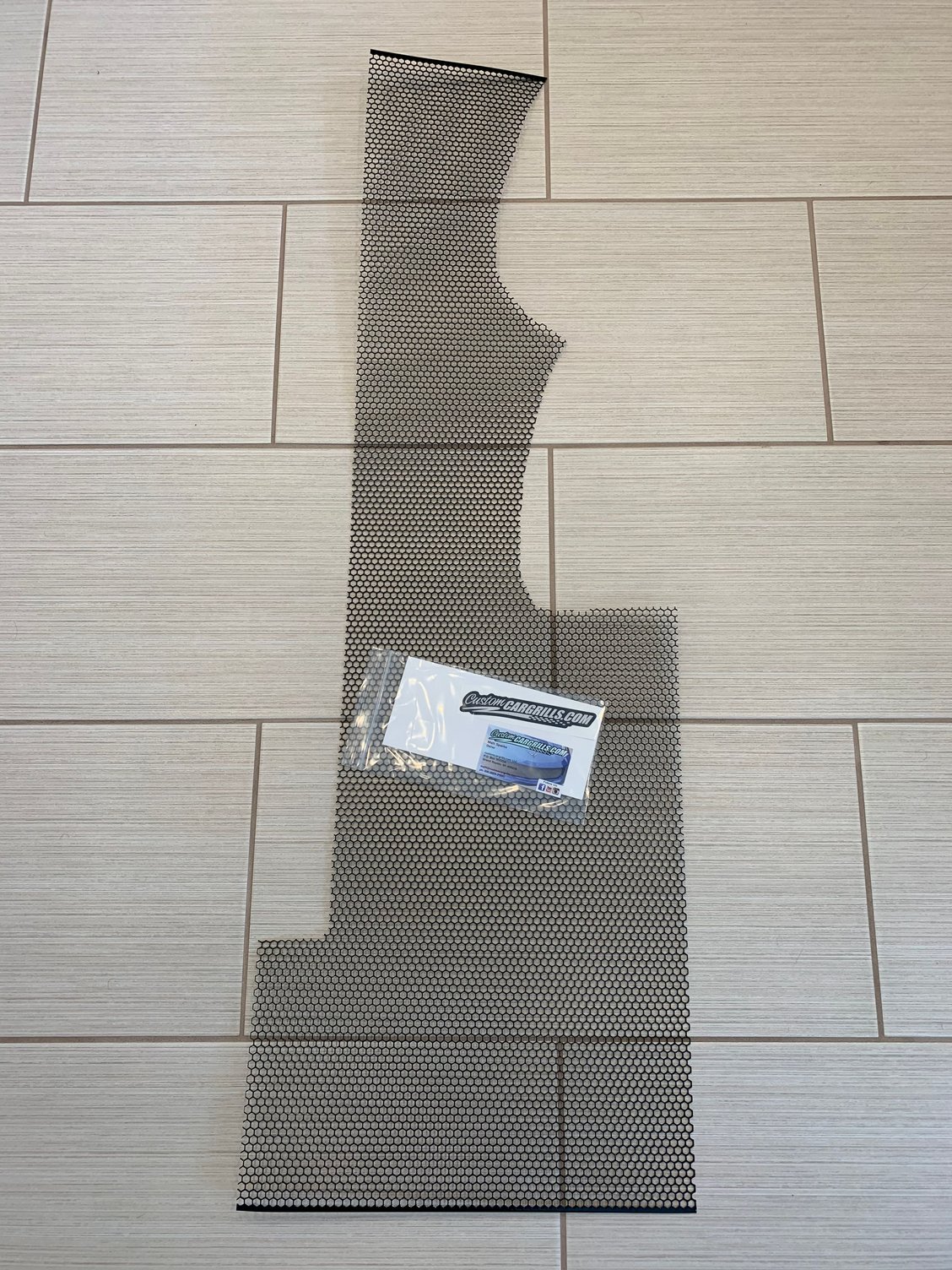

Looks great. I had to do similar on my Evora due to a rock puncturing my condenser. Mind sharing where you got the mesh from?

What did you use to affix new screen to screen ?

I ended up going with this particular setup:
https://www.customcargrills.com/prod...d=Perf_Hex_B16

I just sandwiched it between the original mesh and the air dam. As long as it's trimmed tightly, you can reattach it all without too much issue, and it's not going anywhere.
Unfortunately this wasn't an option for the middle lower section, so I used 5x mini, black, zip ties in inconspicuous locations to affix it.

Anyone need radiator protection material? I purchased and completed the job. It came out great. There is still enough to get what I did which is the 2 outside inter cooler grills and the lower middle section. I paid $100 for the sheet. $40 I’ll cover shipping and it’s out the door next day.

Item has sold! I will mention CustomCarGrills.com were easy to deal with. They shipped same day. Here’s a link to original purchase.
