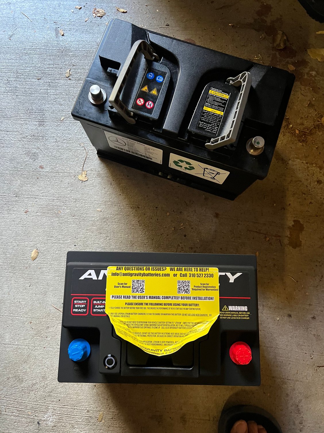

im having the same issues. Just ordered a 60Ah antigravity battery to replace the OEM one. Will let you guys know how it goes.

happy to report back that I just changed out the OEM battery with the antigravity 60Ah lithium battery. Car started right up and went for a nice drive with no problem.
The bolt holding down the battery is a bit tricky to get to, but with a wrench socket extender makes it pretty easy.
hope this helps for anyone with same issues.

Would you please share with everyone the exact brand, type, and model number battery you used. Also did you have to get anything recoded in your car by Mercedes tech or were you able to just do the swap on your own? We all thank you for your help!

sorry for taking so long to reply. I’ve been on a few trips and totally forgot about this thread.
see the link below.
the 60Ah one works just fine and has enough power to start the car. I just left the extra connector off no issues or fault codes. Probably put 200 miles on the car since the battery change
https://antigravitybatteries.com/pro...tive/ag-h6-rs/

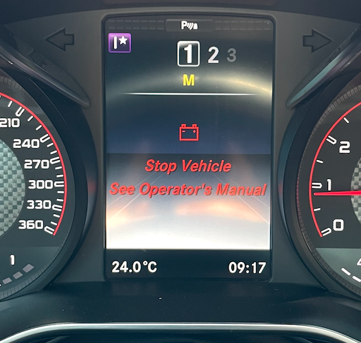

Thanks for sharing the update on the Antigravity battery @2016AMG-GTS84 - great know its pretty much a plug and play!
I've had an AGM battery in my 2017 GT-S for just over a year, but the car was throwing error codes which lead to the annoying error message attached below.
I worked with @BenzNinja to code out the car looking for the OEM Lithium-ion battery and after many long and spirited drives I can also vouch for that also being a viable option!
Now that I know the Antigravity works, I'll consider that as a "nice-to-have" upgrade for the future 😏
Error message due to the car looking for the OEM Lithium-ion battery
Thank you!
