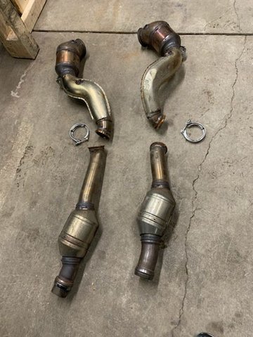

And as you can see, why I always harp on downpipes, by going aftermarket, you eliminate that tight bend restrictive catalyst off the back side of turbo housing, which is something you only accomplish by doing aftermarket downpipes.
Factory converted to 2pc
Aftermarket

BUT, if you have, or know someone that has a LITTLE bit of welding and fab skill, this is the easiest, here’s an example of what someone did when helping a fellow GT owner in your same situation. Since aftermarket downpipes are 2-pc. super easy install, we created the stock downpipes in this same 2-pc super easy install situation so it is super easy to put in and out of the car. Best part is you do NOT have to drop or remove anything of any consequence like the driveshaft when doing it this way.....so minimal labor involved.

Originally Posted by Orcbolg
Um yes.....this is not the what set you off terminology “half a$$” cut out secondary cats for sound increase.
This is converting your factory downpipes to 2-pieces and leaving them operate as normal with the added benefit of you having the same set up as aftermarket downpipes for quick and COMPLETE removal and installation. THIS IS NOT a performance enhancement, it’s an ease of back and forth modification for those, ready to be upset.....that want to do it right FROM A PERFORMANCE perspective and eliminate as much back pressure and restriction as possible....go
aftermarket downpipes.....with quick ability to change back and forth without dropping g drive shaft.

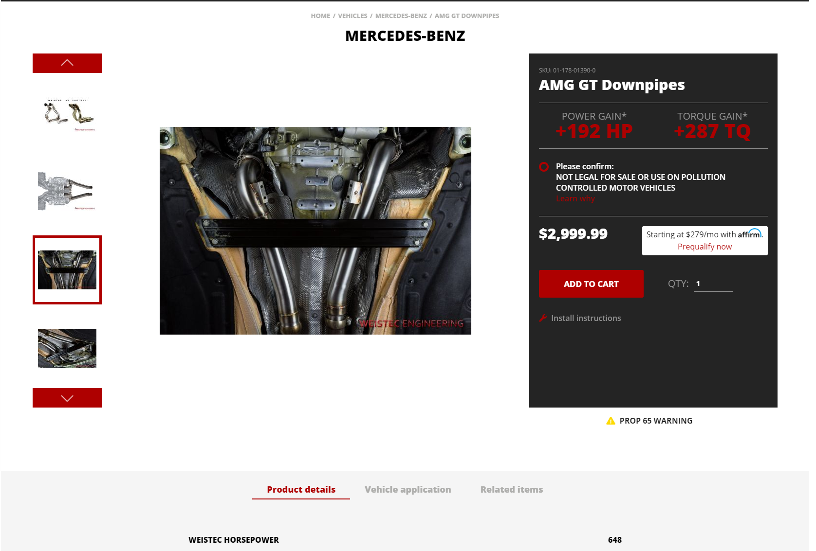

Good info, but I'd need to see some independent/customer dyno sheets to believe the 15whp claim from just DP. Especially when Weistec claims +192hp/+287tq at the crank, from just their DPs.
https://www.weistec.com/amg-gt-downpipes.html
They goofed when they redesigned their web page. The two dynos I posted are from their original test car in 2016. They used to advertise the first one as W1 package (just tune). Second one as W2 package (tune and DPs).
