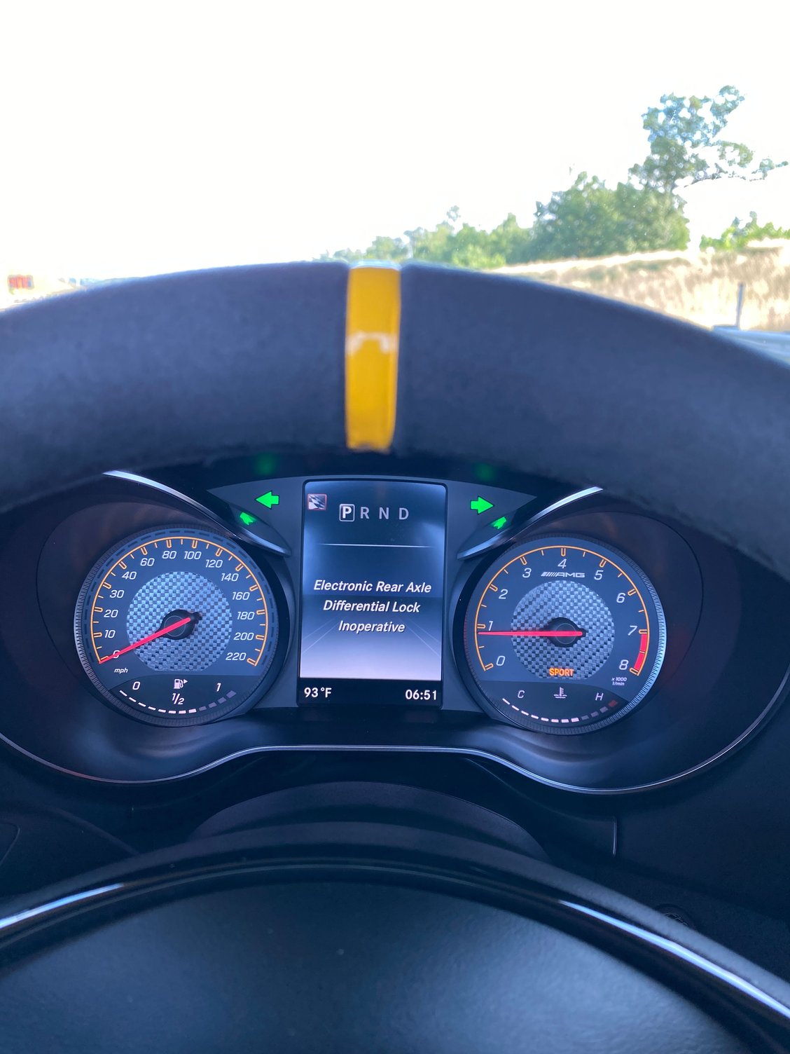

I had this error popup 2x while on a 30-40 mile cruise on backroads and highways. It always happens on highways roughly around 70-85 mph. The AMG service center "fixed it" last time I brought it in for this error 3 weeks ago. Once the sign shows up, the car goes into Neutral and then won't shift to drive (as I'm traveling at 70-85mph). It is incredibly dangerous as I lose all power and have to pull to the side of the road and hope no one will rear end me.
Last time I took it in to the service center, the advisor was pretty confused as he never heard of this issue on the 2018s. They ended up changing the gear shift assembly as they found - what I suspect to be an unrelated second issue - about the car not shifting into Park. (Which I posted about here several months ago, but the problem never came back).
Anyone see this issue on the 2018s+ GT/S/C/Rs?

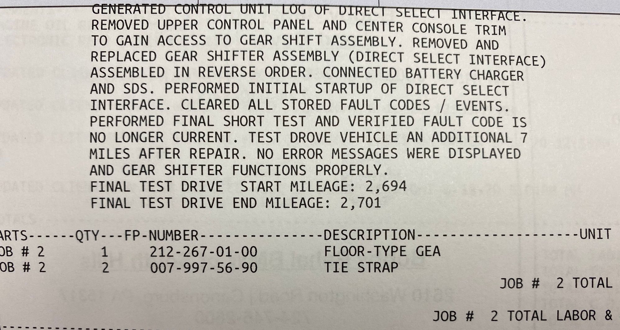

Here is the error and the last service record (I dont know why the secretary wrote Distronic last time, but the Advisor called and had the right error looked into)
Error
Last repair record Pg 1/2
Last repair record Pg 2/2

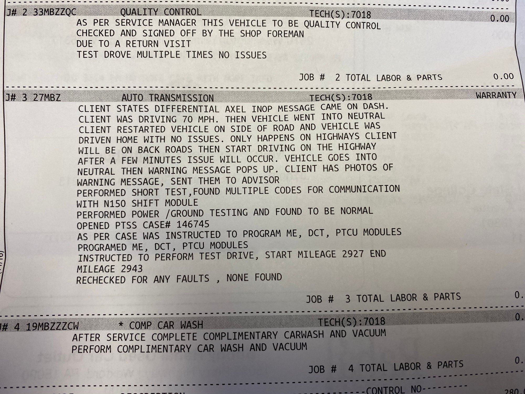

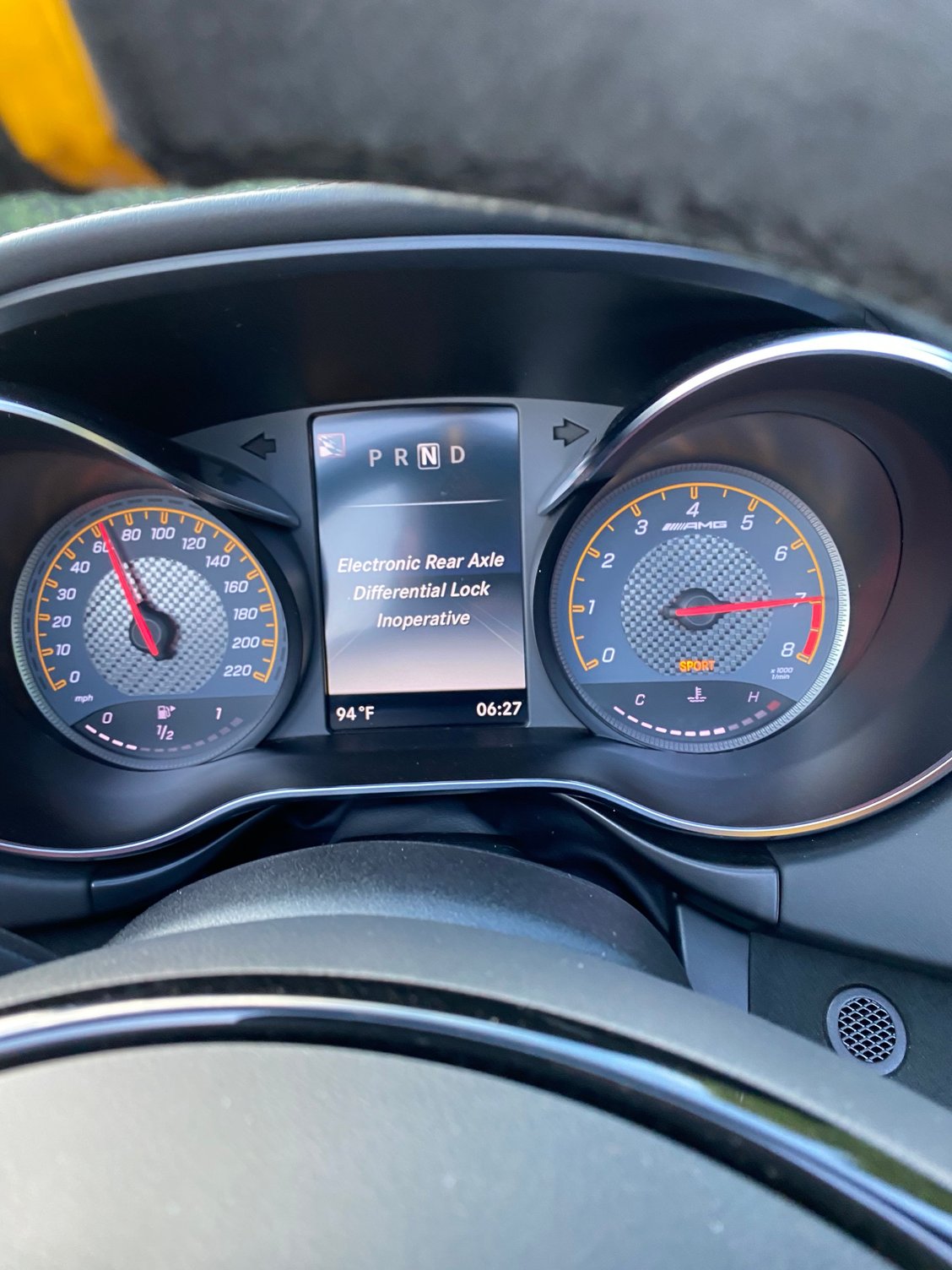

Got the car back after over a week in the shop on Monday. Drove it home fine. Started it up on Wednesday. 5 miles later I get the same issue again.
Car is going to the shop for the 3rd time. The issue has gotten worse, now it can come up after minimal driving. Before, I figured I could go 20-40 miles without it. Absolutely unacceptable.
Here is the error once again. And the service report. Seriously its time for Mercedes to step it up and treat this as a hazard. We have been full Mercedes customers for over a decade with exclusively buying their cars. This whole incident being treated like a minor problem has made us doubt our decision to stay with the brand...

They are going to call today with updates. Im expecting the usual, "no information until we talk to our techs in Germany" - which will most likely go on for another week.
Originally Posted by AMG 17GT
Did they change out E harness going to differential. ?
They have not, unless if that is the drivetrain CAN line mentioned above. They checked the drivetrain CAN line only after I insisted they look into it. They did not find anything.
The car was kept at their shop for over a week during the last visit where they ended up doing various software updates/resets. I also have the impression they are well out of their league on anything past minor repairs on AMG GTs; hence, their hesitation for taking an aggressive approach to this rather serious issue.

The first problem is your dealer replaced the wrong part. Why on earth would they replace the gear shift?! The problem is with the e-Diff. That seems quite clear, given the message on the dash.
Find a new dealer. Ask who their most senior AMG certified tech is. Work only with him/her.
I dont have the luxury to change dealerships, but at this point - I am satisfied the issue has gotten proper attention from the German team.
The SA told me that because this car fits between a "racecar and a traditional AMG" - they like to be extremely cautions for any suspected major repair, so thats why they have been hesitant to do anything drastic.
The gear shift part actually bothered me when I saw that was replaced, but I figured they were 100% sure that was the issue. Turned out it was a separate issue for the car.
