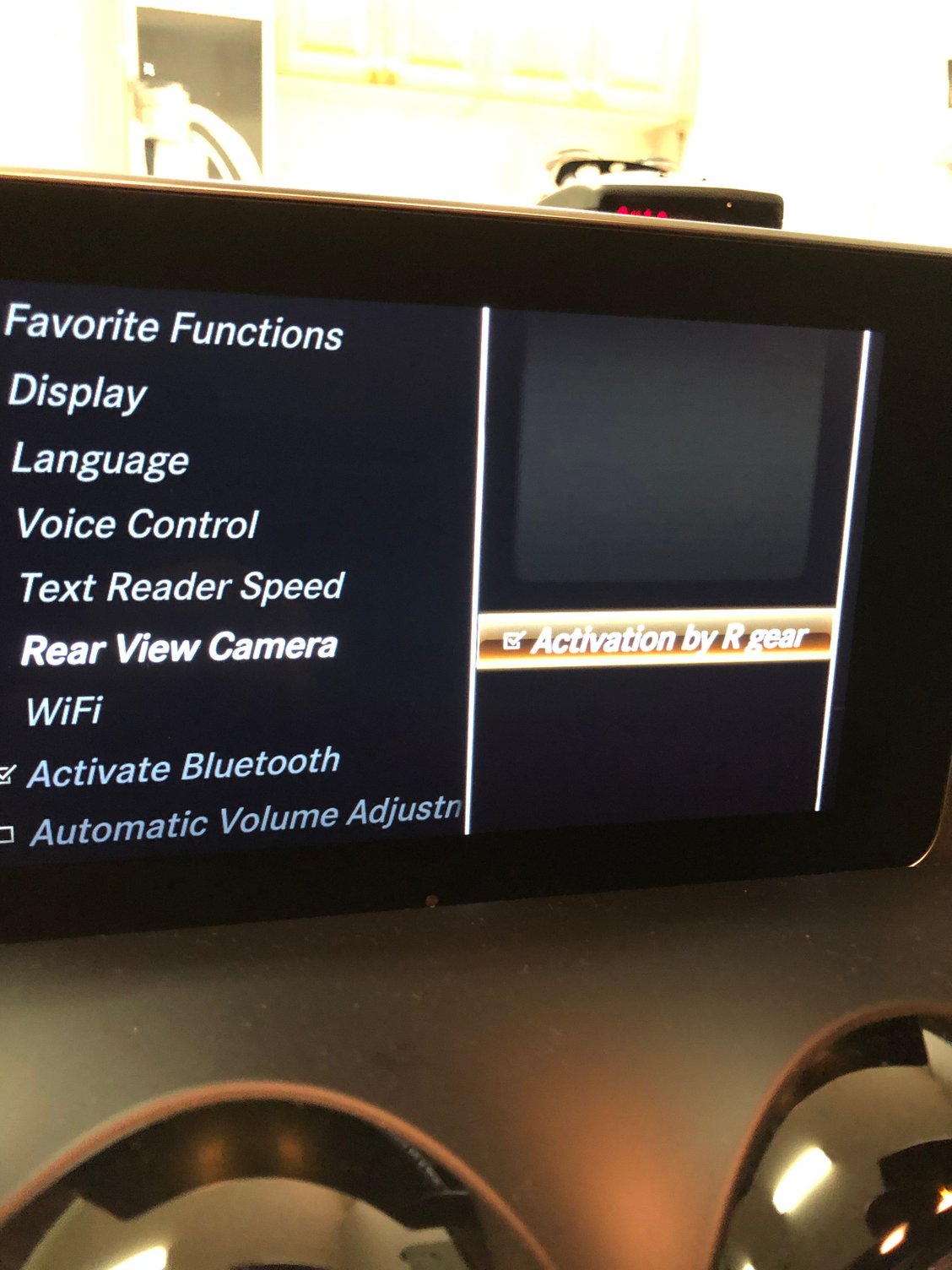

Even though the Mercedes tech says its the camera that is defective, I'm personally not 100% convinced as the Systems Settings in the COMAND module does not show a setting for the Rearview Camera (on/off) which is documented in the COMAND owners manual.
Does any one else see a setting for turning on/off the Rearview Camera in the Vehicle Systems Settings on the COMAND screen??
I do

Just to be sure, if it's missing it may be because it isn't detecting a working camera. It depends on how the Command SW is coded to treat the R camera function.
