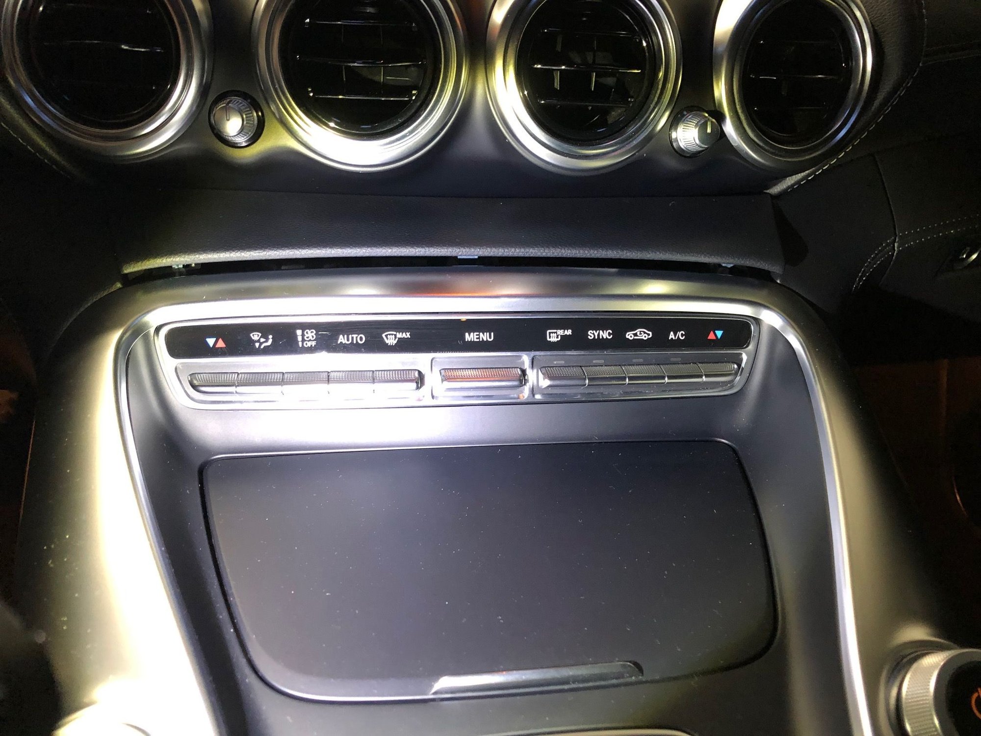

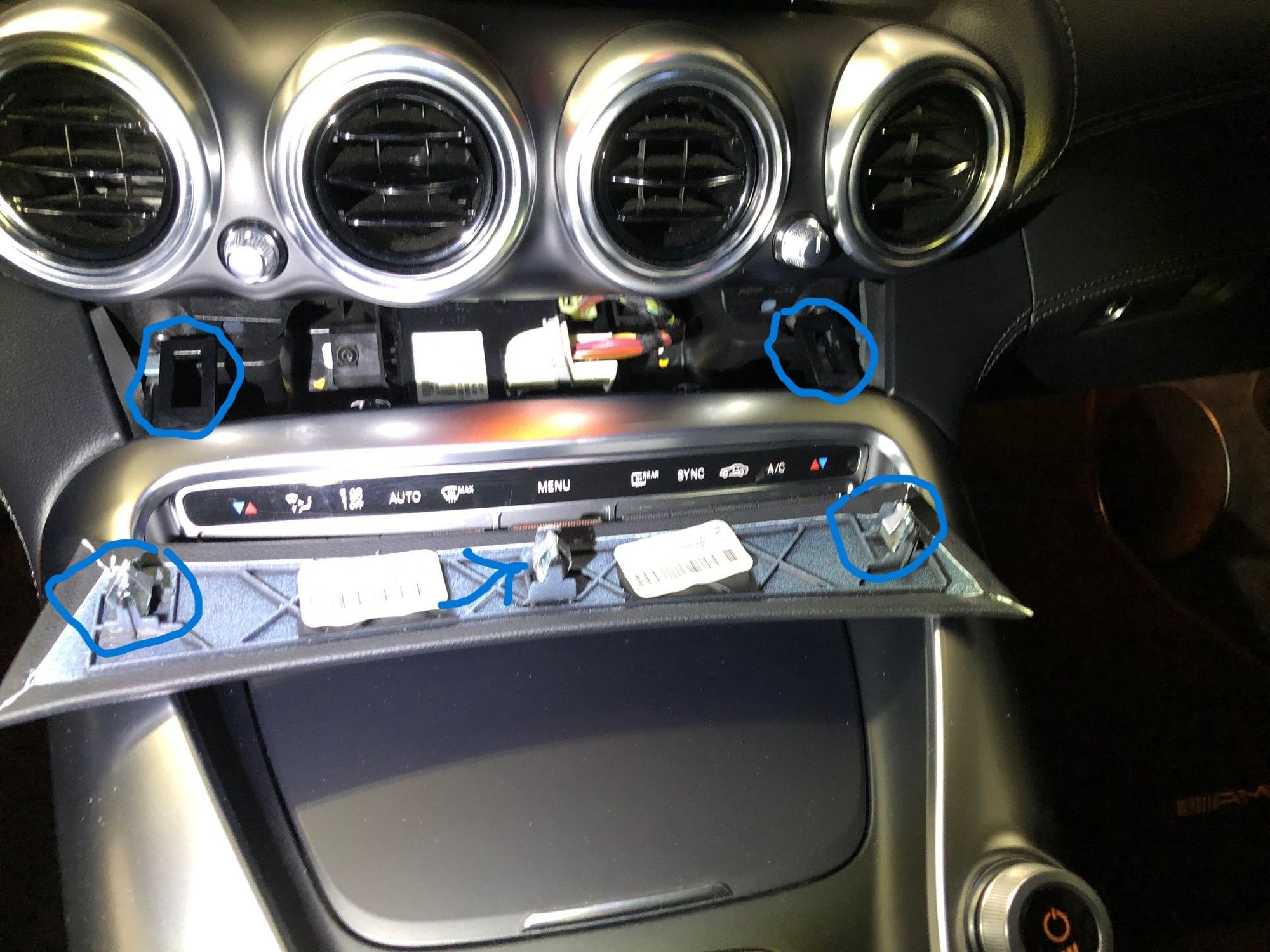

The panel you're pushing on is pretty normal movement. This panel just clips on with two wedge spring clips. Interestingly, there is a third, center clip that doesn't have a mating part to lock and it makes the center of this panel feel like it can be pushed in, then it gets more solid as you press towards either edge.
The panel comes out quite easily. Just use a plastic interior trim tool, pry one of the long edges first, then pop the other side. Here are two pics, one with the panel in place but popped out. The other with the panel upside down laying on the console. The two circled wedge clips are holding the panel in place in the circled slots. The third clip with the arrow does nothing. Looks like a design ooops....
I doubt this is your rattle, but if you do simply pop it out completely and take a drive. One pretty common rattle that sounds like it is somewhere in the cabin but the sound travels to different places is the interior door pull. It is very easy to isolate. As you're driving and hear the rattle, just put your finger behind the pull and lift very slightly. If the sound goes away...that's it. Could also be the pull on the passenger's side.
