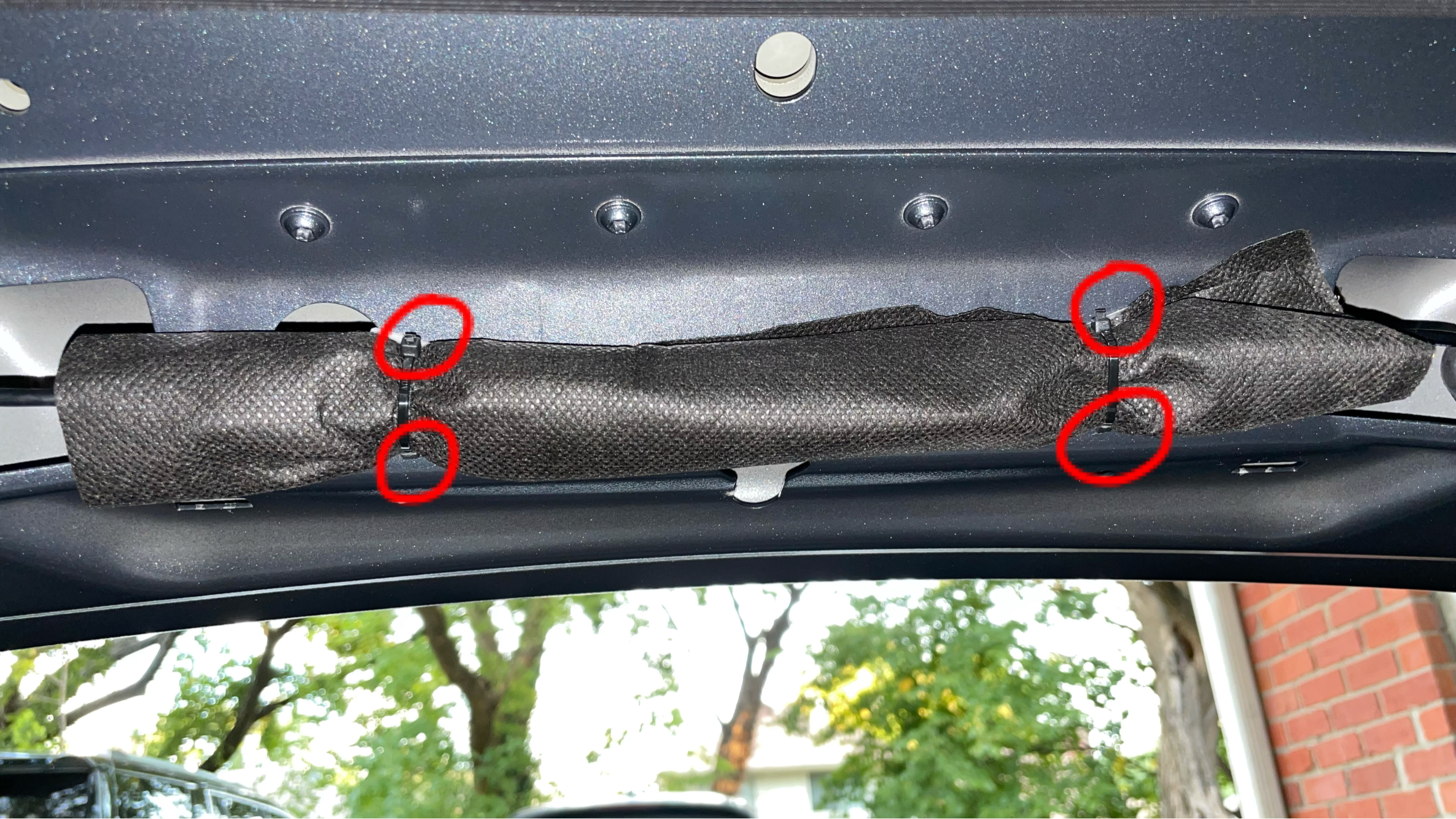

So for starters, when I wired my dash cam, I had an excessive amount of wire to bundle up.

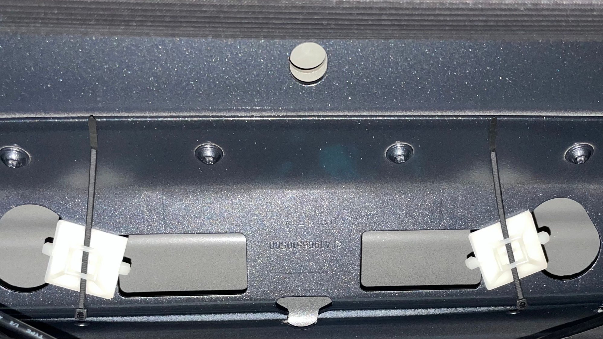

I used plastic zip tie tie down pads with adhesive and strapped them to the metal roof panel with the adhesive and white zip ties as shown.
I then wrapped the wire with black cloth (landscaping cloth from garage) and then zip tied it to the tie downs making sure to leave the locking side of the zip ties towards the back of the wire bundle away from being able to touch and rattle on any metal or plastic

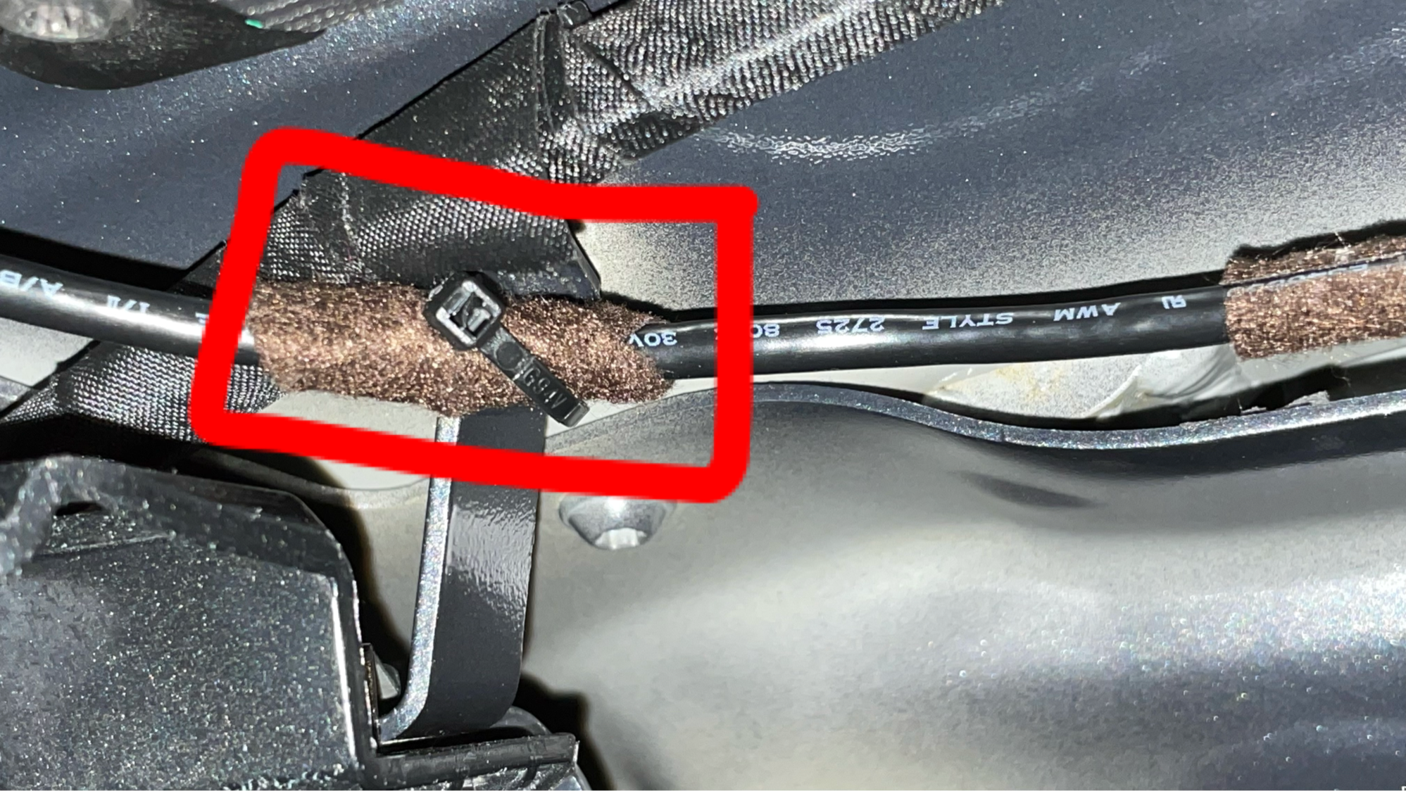

For the rest of the wire, I wrapped it in 2mm felt tape and gently zip tied to metal roof panel. Made sure that zip ties are snug but not too tight to compress or damage the wire

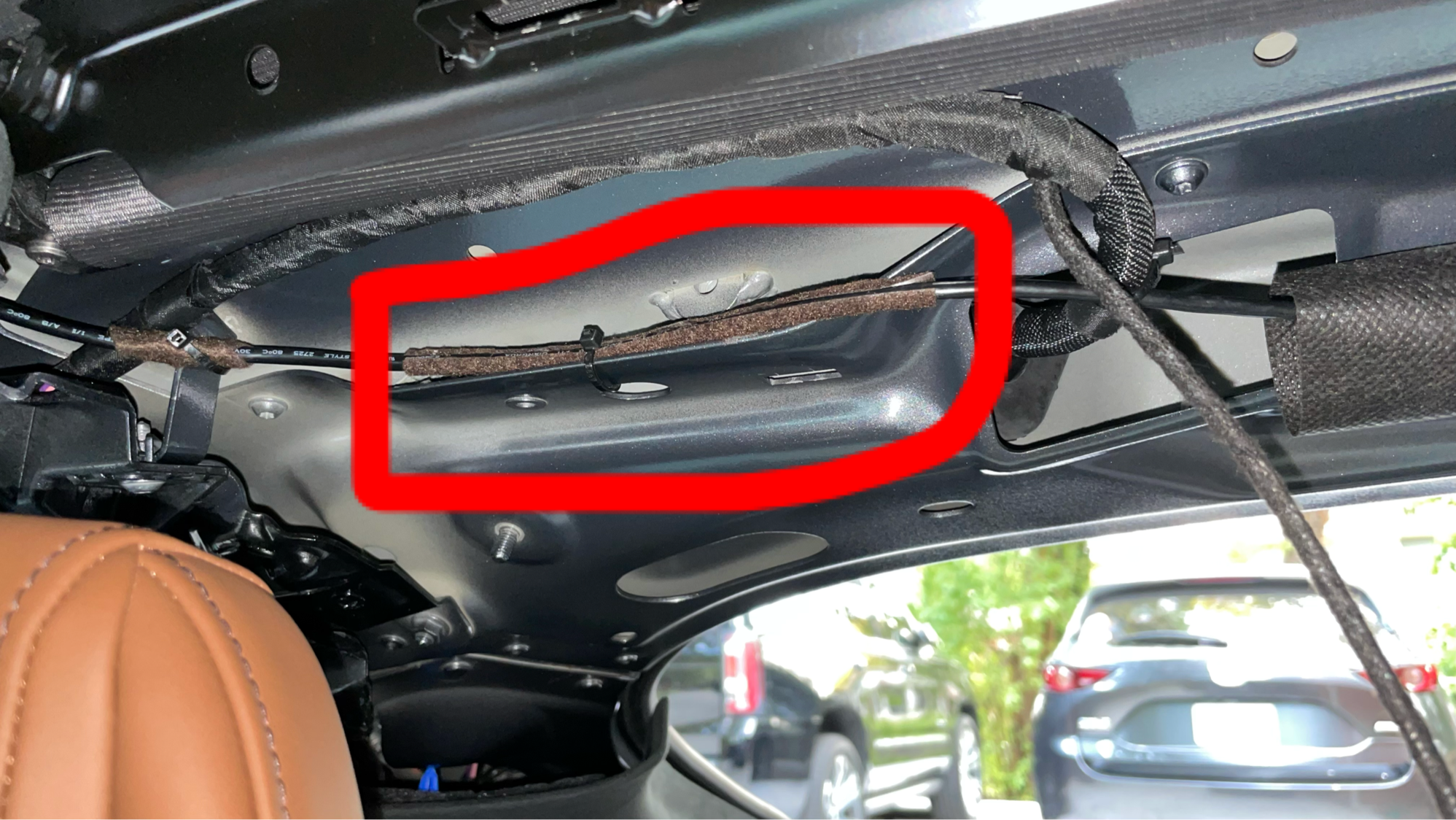

Same here, wrapped in felt tape, gently zip tied to metal roof panel. Again zip tie is snug but not tight so the wire is not damaged.

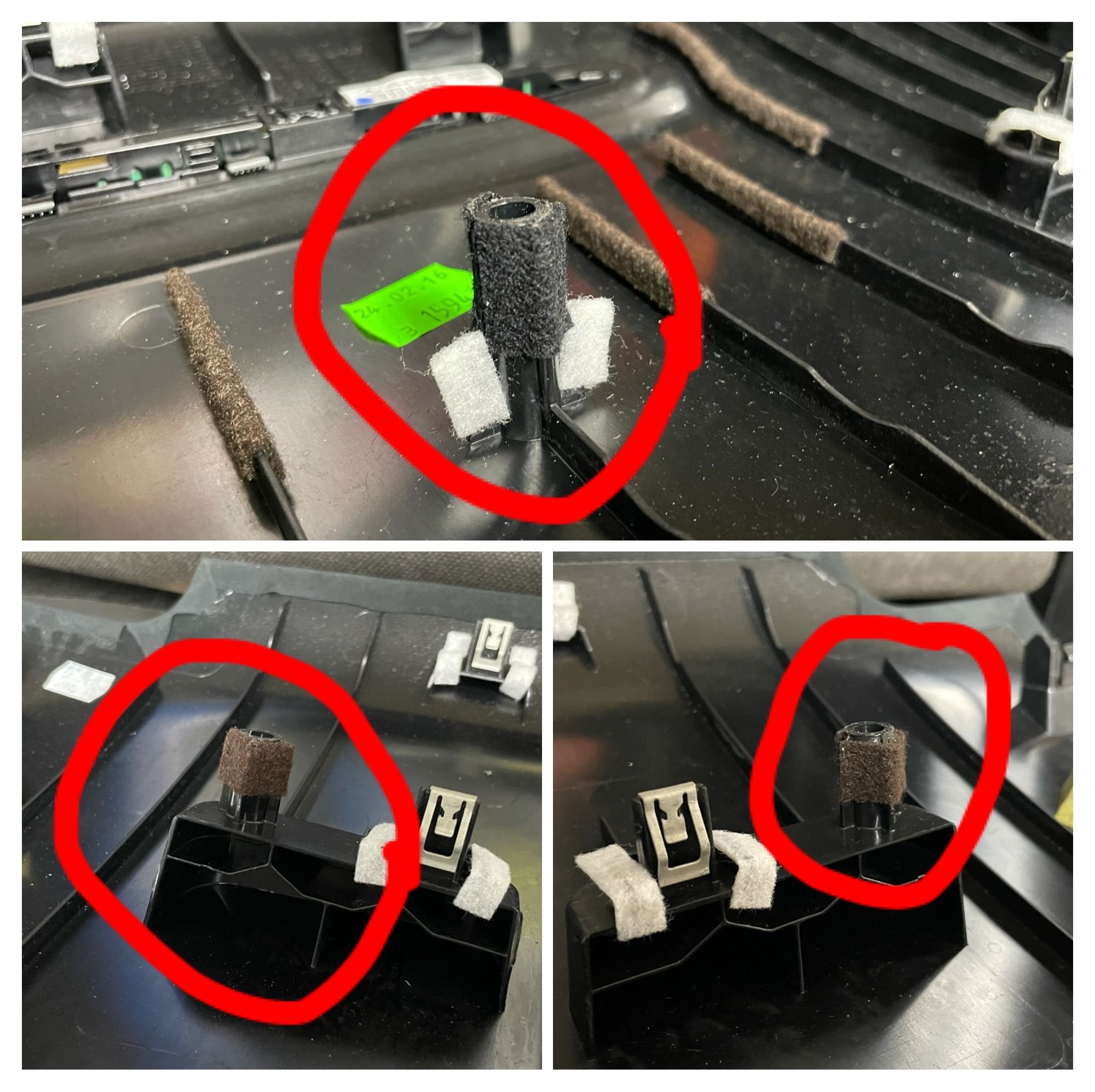

While looking at the roof panel itself, I noticed that factory they wrapped the center peg in felt tape, but not the left or right pegs?? So I wrapped them to match to ensure no chance of rattling.
Also I noticed that the factory 1mm felt tape has been pressed so tight that it is essentially plastic against the metal roof panel potentially causing rattles.
So to fix this, I placed 2mm felt tape pieces on top of all factory tape spots as they were all pressed similar showing the plastic coming through. Also I taped along the light sensor to ensure it stays in place without movement or rattling.
