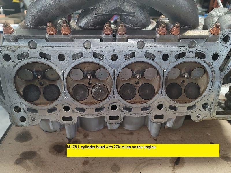

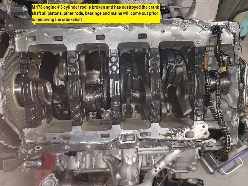

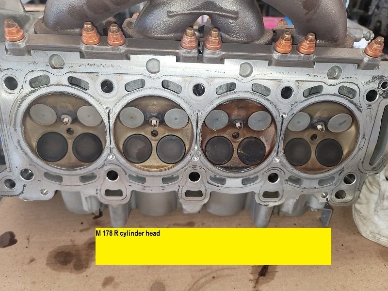

In January 2021 I bought my 2017 GTS (27K miles) with a seized motor in it. I had a 13 k miles donor motor on hand and by the end of May 2021 I completed the installation of it together with the upgraded drive shaft since everything was out of the car. I have enjoyed driving it a lot since that time (now at 32k miles)
By participating on this forum I have had the pleasure to exchange information with several (new to me) nice friends here on this forum. As I have had some other ongoing projects (a SL63 engine out head bolts rebuild) I did not have the time until now to pull the original motor apart to see what went wrong with it. The story I got from the PO was that a road hazard (spike) damaged the oil supply tube to the oil reservoir and they (however was driving he/she, he did not say) heard a loud sound but did not see any external body damage to the car.
This week I finally got around to pull the original motor apart and hereby some pictures of my initial findings. I have decided to share these here to warn/alert others how to be careful and keep an eye out for any objects on the road that can harm these low to ground cars.
Best H

Old Nov 16, 2021 | 11:41 AM
Gribouilly's Avatar
Joined: Nov 2021
Posts: 23
Likes: 12
From: France - 95, near Paris
AMG GTS EDITON1
Incredible crankshaft breaking ...
Do you know why it broken like this ?
Extra turbo pressure after a remapping ?
Or direct intake filter and engine has kept some water ?
Good luke in future if you can rebuild it ...

Hi Hendrik,
I only answer very briefly. I'm tired and it's already after 3:00 am.
Your engine ran dry for a long time. That would not have happened with oil pressure monitoring and a less pain-free driver.
You have not set a picture of the cylinders, but I can imagine with a cracked connecting rod.
Damage over 0.05mm and overhauling will not be possible.
The blocks are no longer made for this and it is no longer intended. There are also no oversized pistons.
(Was already like this with the M112 / 113. Also had no more sleeves inserted)
The cylinder blocks were no longer made to be bored out.
All new MB engine blocks (M156 was the first) only have a very thin (approx. 0.1 mm) coating of iron-carbon, this is "sprayed on" in an arc process.
If you are interested, google it: Nanoslide
There are no oversized pistons. Could you work with repair sleeves?
Little material between the cylinders (90mm cylinder distance with 83mm bore)
And the engines develop a very high working pressure.
Maybe there is a shop that can "Nanoslide". I don´t know.
I "overhauled" M112 supercharged engines. (Rare and expensive) Change allways the block if there is even a slight damage.
With a used one. The naturally aspirated engine block fits, and there are plenty of them. (Indestructible and were built into every MB)
They have a different method of surface treatment (cast-in Silitec sleeves, these are "etched")
Even after 100,000 mls, no measurable wear. Look like new. Mileage of 200,000mls, normal. 300000mls no exception.
I think the Nanoslide coating is even better. With good care, the parts are indestructible. At least as far as the cylinder and block are concerned.
Unless, as in your case, they are murdered.
I would keep it as a spare parts carrier. Then you have all the spare parts. All the little, expensive things
In the long term, it should help you more, than a hole replacement engine. (with time and money in it)
I apologize for mistakes. i am tired.
Best regards
Stenzel

The fact is that I found an extra bolt, however I have no proof that it was the engine builder who dropped it in there, as AMG states "one man one engine" it would be an assumption on my part or others that it was the builder who made the mistake.
As for me it remains an assumption and I have nothing else to say about it!
Best H
