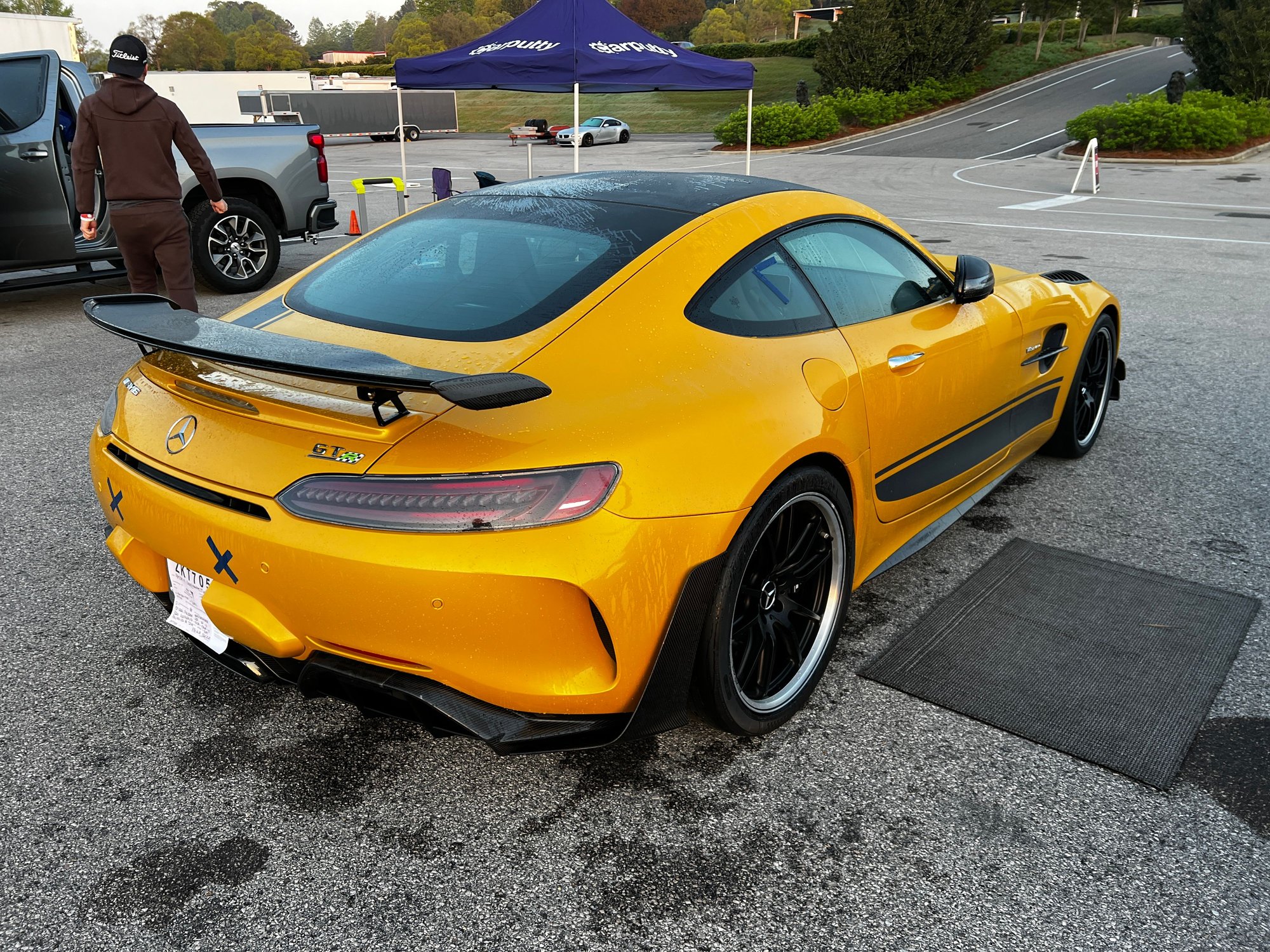

Now on to some new mods for this year, we’re now running Pure 900 turbos as well as some added bracing to the chassis under the rear hatch to support the wing! Along with that, over the next month or so we have some big aero updates coming to the car with help from AMB Aero to help optimize our current setup as well as add some new key components. Fuelab is also developing a new low pressure fuel pump for the car which will be over double the rate of the stock pump in order to go for even more power!

The Pro has a different factory wing mounting system than the standard GTR. This wing won’t fit a GTR unless you’ve swapped the GTR base for the GTR Pro base.
The wing shown on the car in the original photo above (OP) has a universal mount and is mounted on the rear hatch, positioned between the standard wing mount and the rear window.
That setup matches the AMG GT GTC500 71" Carbon Fiber Adjustable Wing (2015–2021)., https://shop.aprperformance.com/prod...e-wing-2015-up
I don’t have hands-on experience with this specific wing setup, but it’s worth noting that at an 18° angle of attack it can generate roughly 1,000 lbf of rear downforce.
But as you correctly indicated, I suspect some level of structural support would be necessary.
