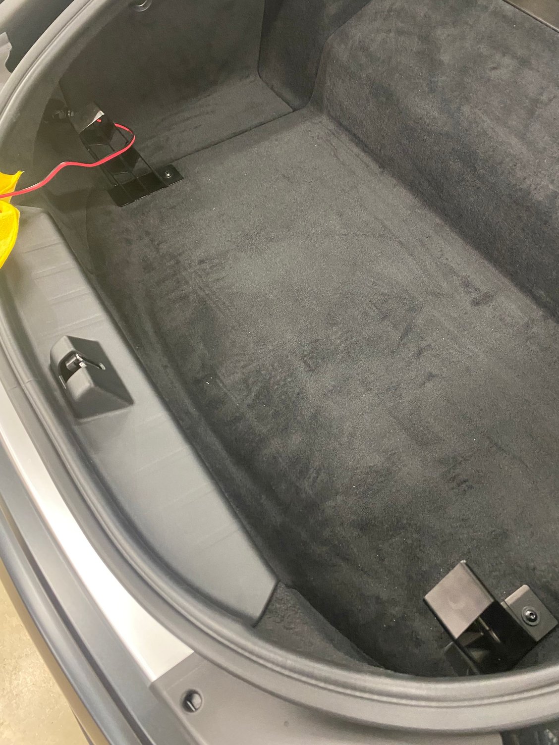

Originally Posted by Flgt
I looked in the rear trunk and didn't see a charger port, unless I missed it...
This is from a GT S I think, but should be in the same spot.

Likes: 12
Mb
Will check in the AM with a flashlight. Thanks. Any Black series owners able to confirm?

Lightbulb
You missed it.

Found it. Thanks!
