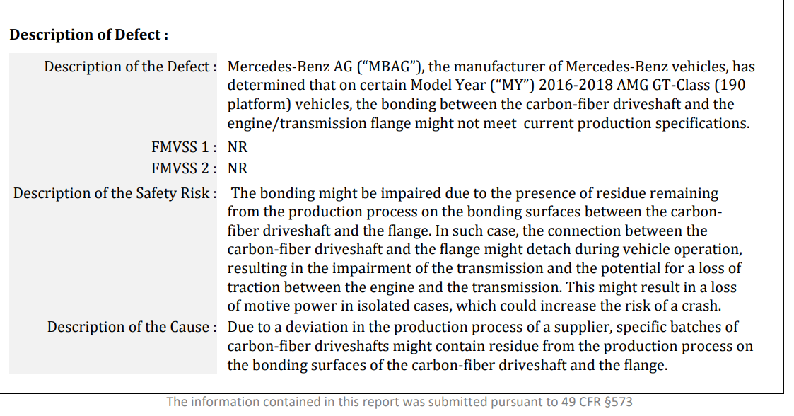

The driveshaft recall started with 2016 MYs, but was then expanded to 2017 and some 2018s and it became quite complex and convoluted.
Originally, the recall only impacted 2016 MYs and then only a certain batch of driveshafts. The first problem was, MB didn't seem to have a good record of where the suspect bad batch of Driveshafts ended up, so the TSB for that first round became an inspection with a replace of only the bad ones. Here is an excerpt of that first TSB with a "GO/NO GO" inspection:
Subsequently, more bad batches of driveshafts apparently ended up in 2017 and some 2018 models so the recall was expanded:
Here again, more bad batches of driveshafts ended up in more cars, but NOT ALL OF THEM. MB expanded the recall notice, again looking for the bad ones via inspections. They appeared to get a little better and with this go around, MB was (will) send a personal notice to owners of the affected VINS.

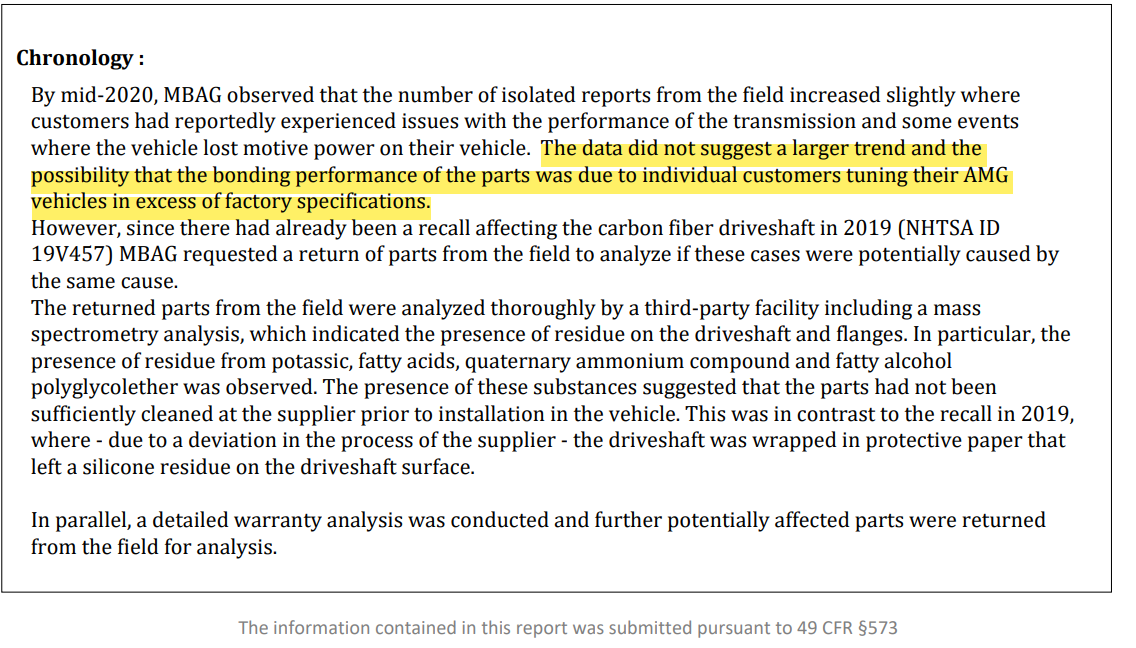

Now, to make it convoluted, MB discovered that some driveshafts were failing in the field but some of those cars were AFTERMARKET TUNED so the driveshaft was being impacted by torque that exceeded the original design and they had a further challenge trying to sort those out.
THEN Covid hit - This caused a severe disruption in replacement parts which is still impacting the recall campaign. In fact, without a letter from MB that the owner has, the dealer is not supposed to try the recall as they wouldn't have the replacement driveshaft. MB doesn't send the letter to owners in a given region until/unless they already have parts available there. This mess is STILL going on as I'm expecting a MB letter on my 2017, and it was anticipated it would be completed in March 2022, but parts are not available.
Here is a second excerpt from the broader recall impacted by tunes/mods.
So, it's entirely possible you get a letter, take your car in, they first do an inspection then determine the driveshaft you have is OK. It doesn't mean they wouldn't do the replacement, it just means your DS didn't fall into the replacement SNs.
Hope this helps.
