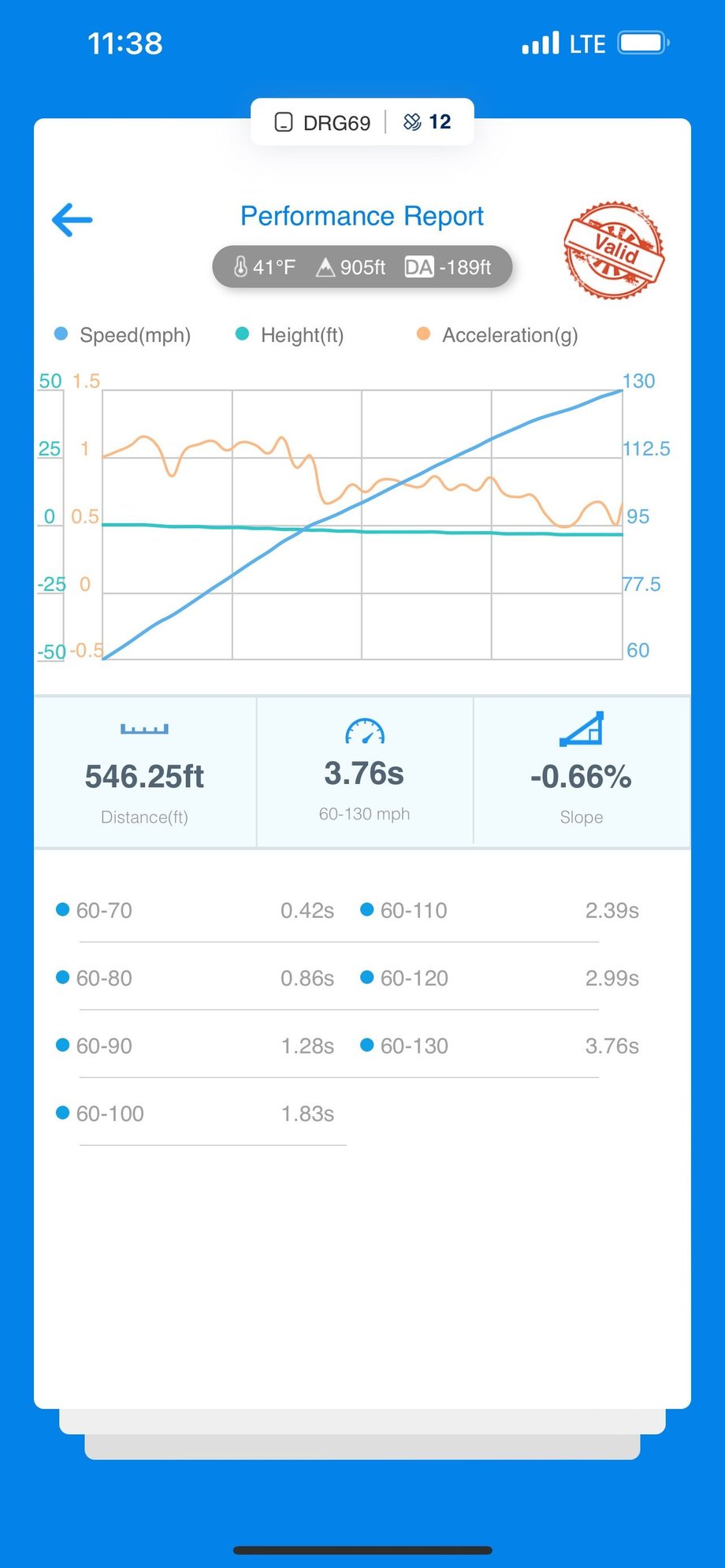

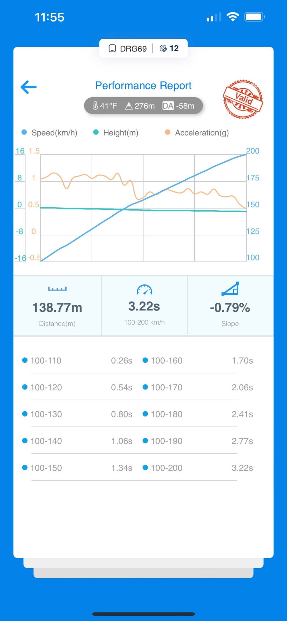

Title says it all. We are proud to push this platform as far as we have.
3.76 60-130mph
3.22 100-200km/h

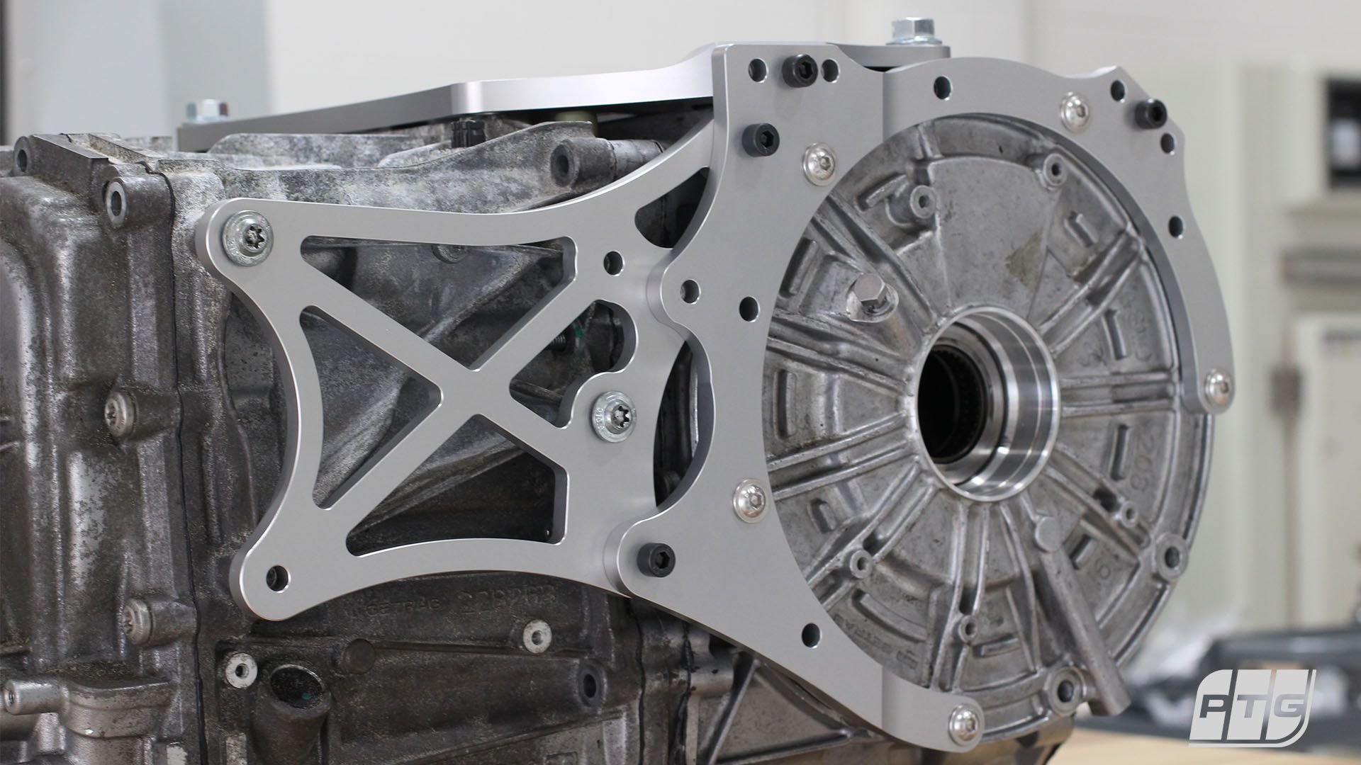

With all that extra power, what powertrain issues have you encountered?

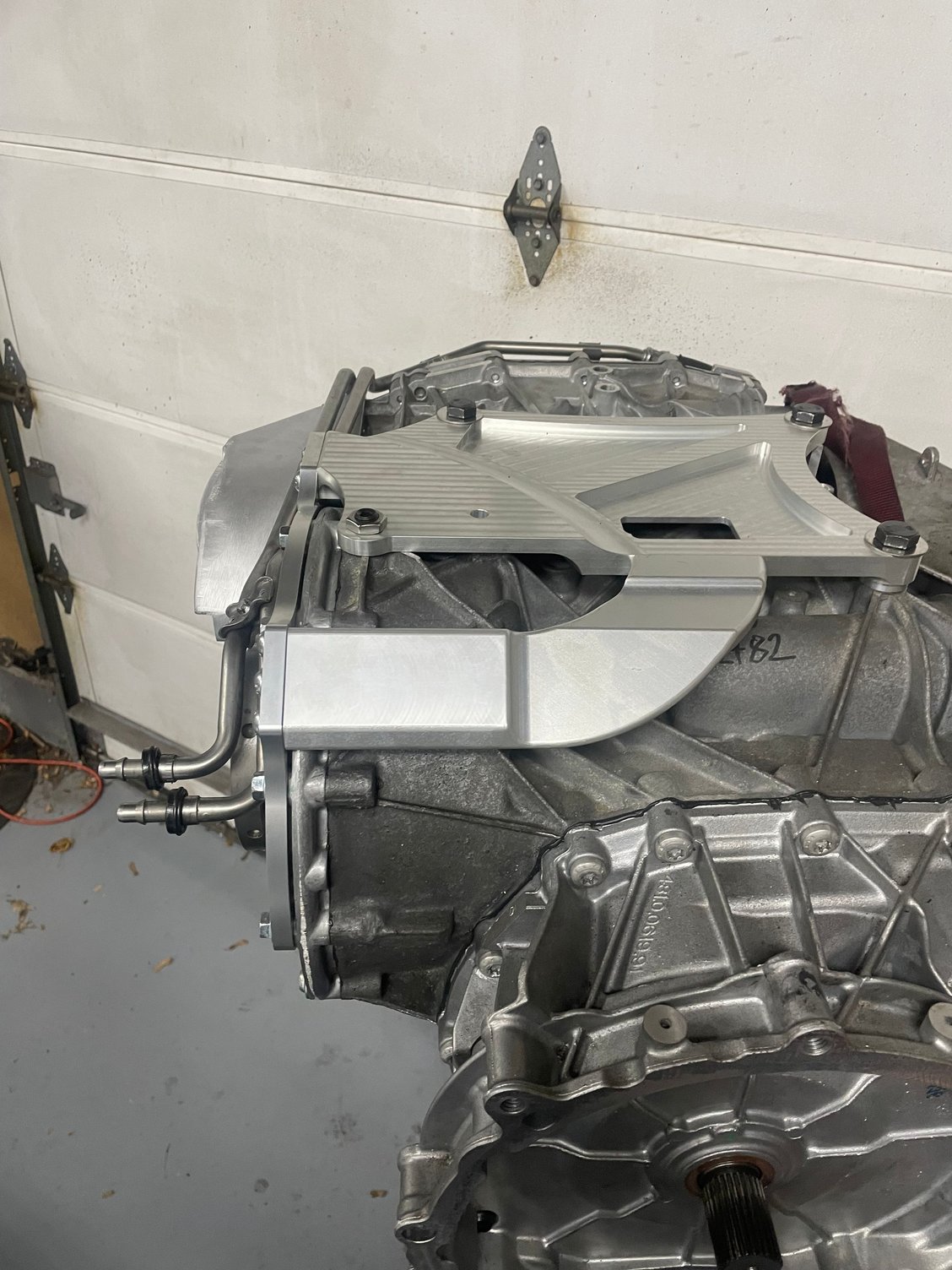

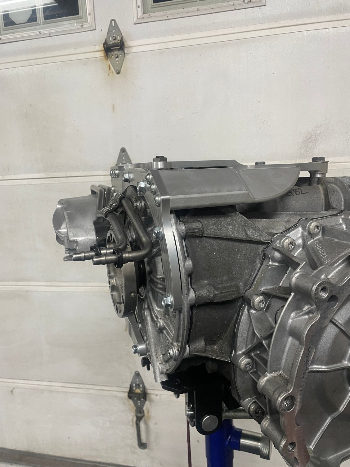

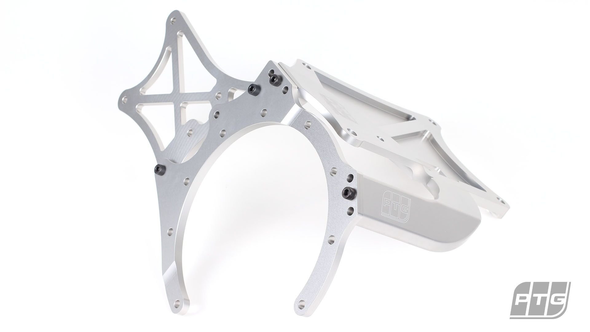

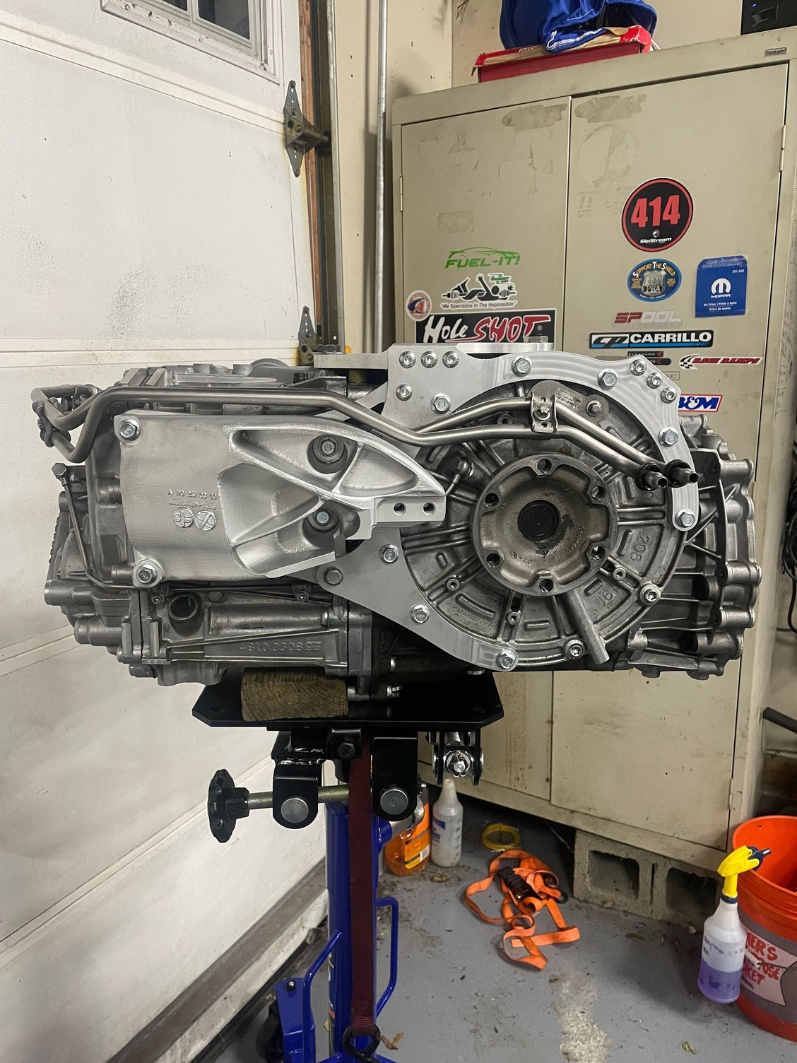

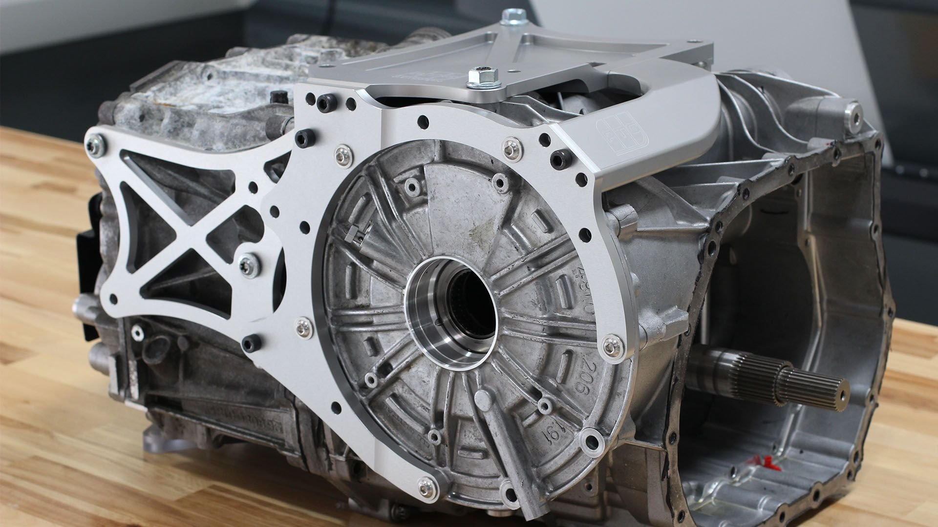

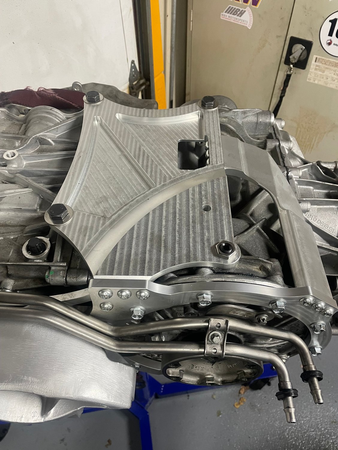

Quote: With all that extra power, what powertrain issues have you encountered?
Clutch and transmission case were an issue. These have been known issues with far less power however. We solved these problems via an exclusive clutch system codeveloped with Dodson and we also made a full transmission brace to help hold the case together. Photos below.
We have more parts being developed as well as we continue to push the platform further.

In what way does it help the car?

Quote: In what way does it help the car?
It helps in protecting he transmission case from cracking under the forces of the additional power levels.

At what HP is this necessary?
