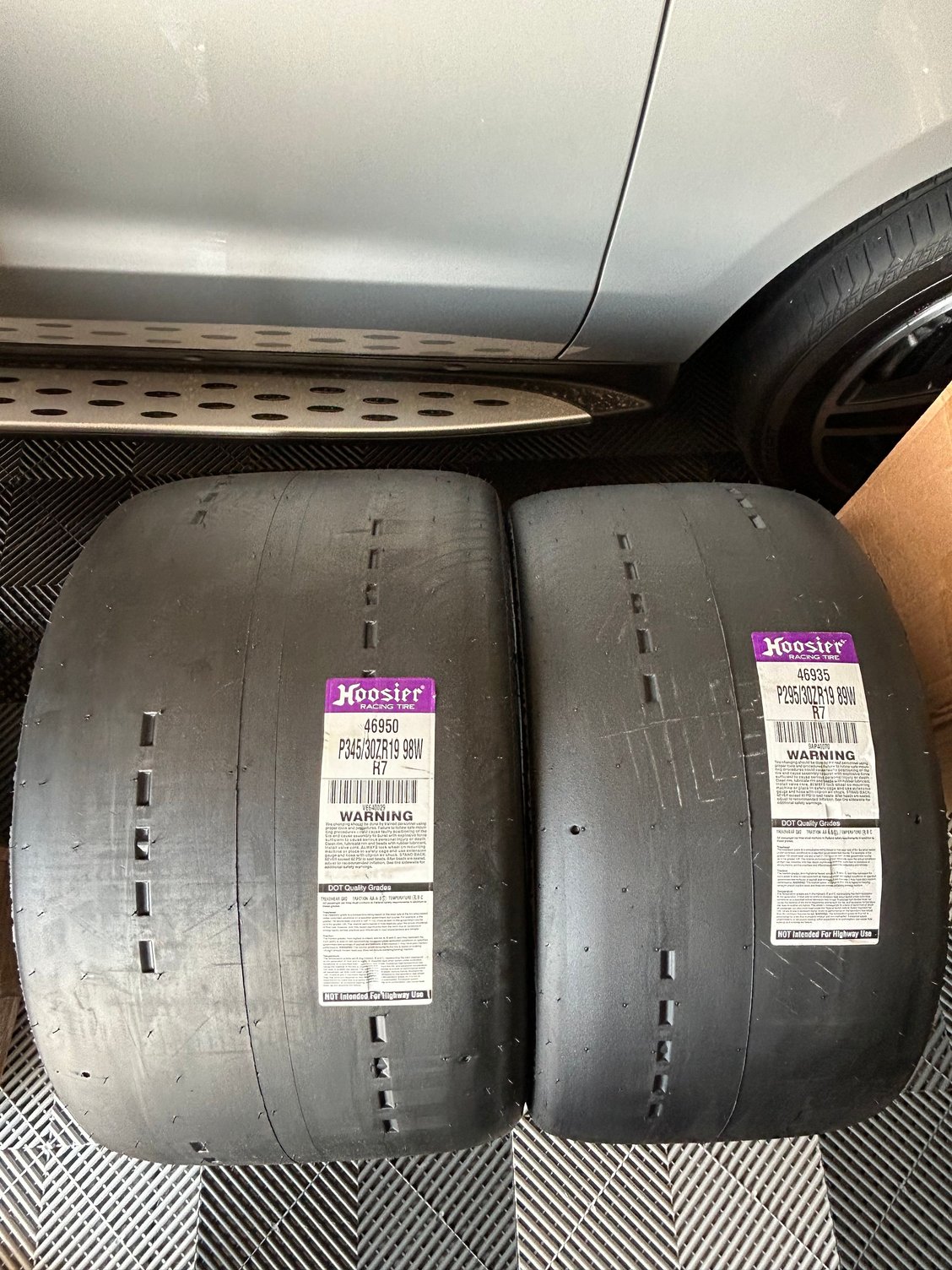

Not to de-rail the thread, one day I’ll start one about all this stuff, here’s the ideal Hoosier 19/19 set up if wanting 19’s all around so you have a true slick option as well:
295/30-19 fronts
345/30-19 rears
