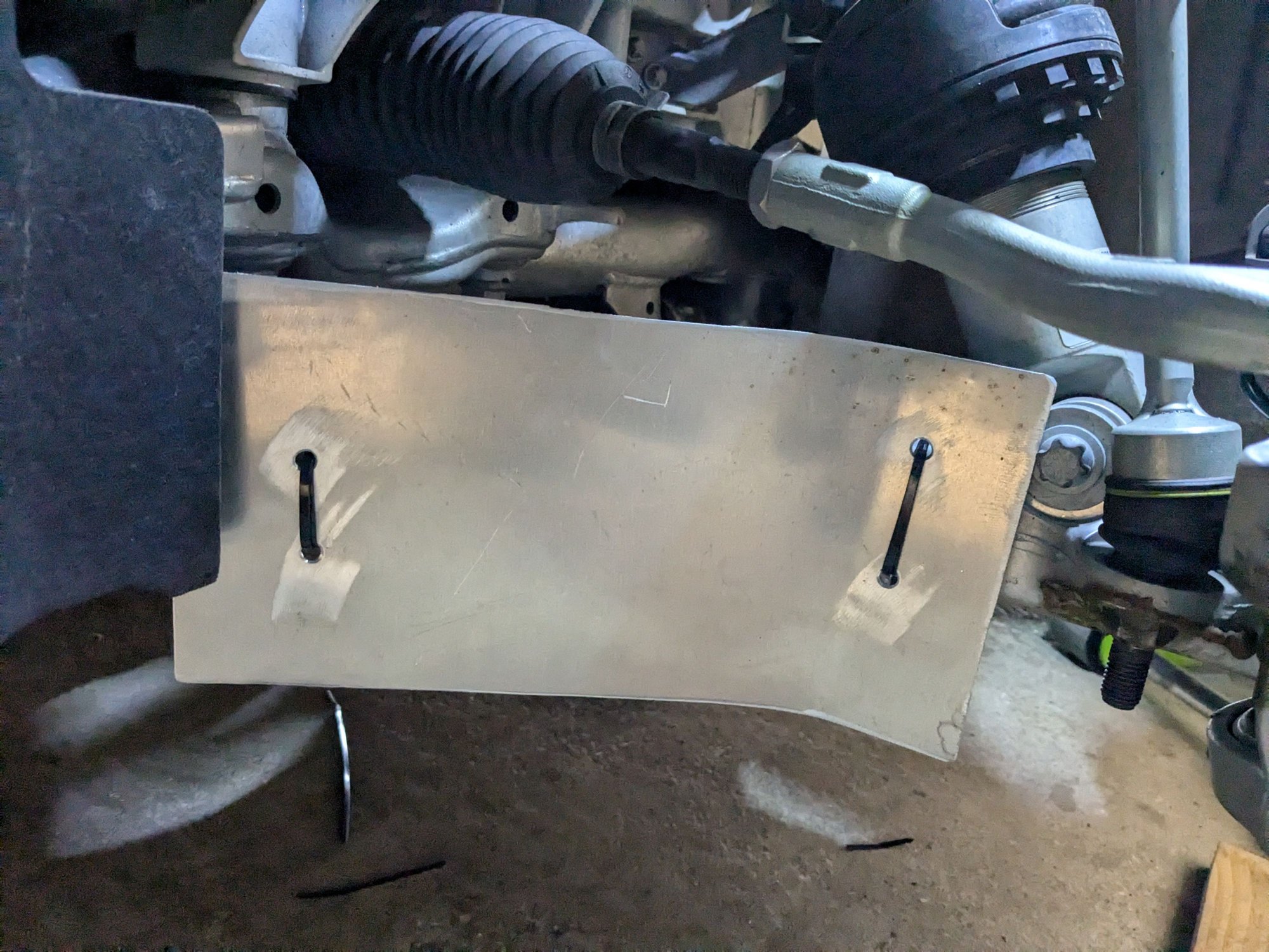

I built a very basic scoop with 1mm aluminium

I don't see a scoop. I see a deflector that doesn't seem to be guiding the air in any particular direction.

Yes it's a deflector, something simple, who works better than the Tick

I bought the Tikt because it was more efficient than nothing, it's true.
After only 1 session I completely lost my break, something who never happened with my GT3.
I checked a GT3 deflector and decided to try to make something simple.
I cut out a piece of cardboard to make the largest possible piece, which I then cut out of aluminum.
I then drove on the ctrack with the Tikt on one side and my aluminum scoop on the other side. The result was clear, the side with the Tikt was much hotter.
I sold my tikt and duplicate my aluminium deflector.
I didn't create my topic to talk to you about tikt or aluminum, but to give my opinion between McLaren, Porsche and AMG.
What is certain is that the wind-catching surface under the car is much larger with my deflector and that the disc is not enclosed.
This is a picture from my Porsche OEM deflector.

My point here isn't to argue whether the aluminum deflector is better or worse than the Tikt ducts. The Tikt ducts have two key design functions:
  1. They direct all scooped air to the center of the rotor, allowing the air to flow between the rotor plates and cool both sides evenly. This prevents heat buildup in the rotor core, resulting in faster heat dissipation. If you don’t cool from the center, the heat stored there will radiate back toward the outer surface (and the pads), making cooling less effective. A deflector-type system, on the other hand, seems to cool only one side of the rotor.
  2. The Tikt duct doesn’t add drag. The rotor vanes act like a powerful pump, pulling all the air that enters the large Tikt opening. It seems that over 90% on the air entered exits via the rotor's vanes.
While it's surprising that the Tikt ducts might seem less effective compared to some other scoops/deflectors for the GT, if your experience shows otherwise, that's perfectly fine.
