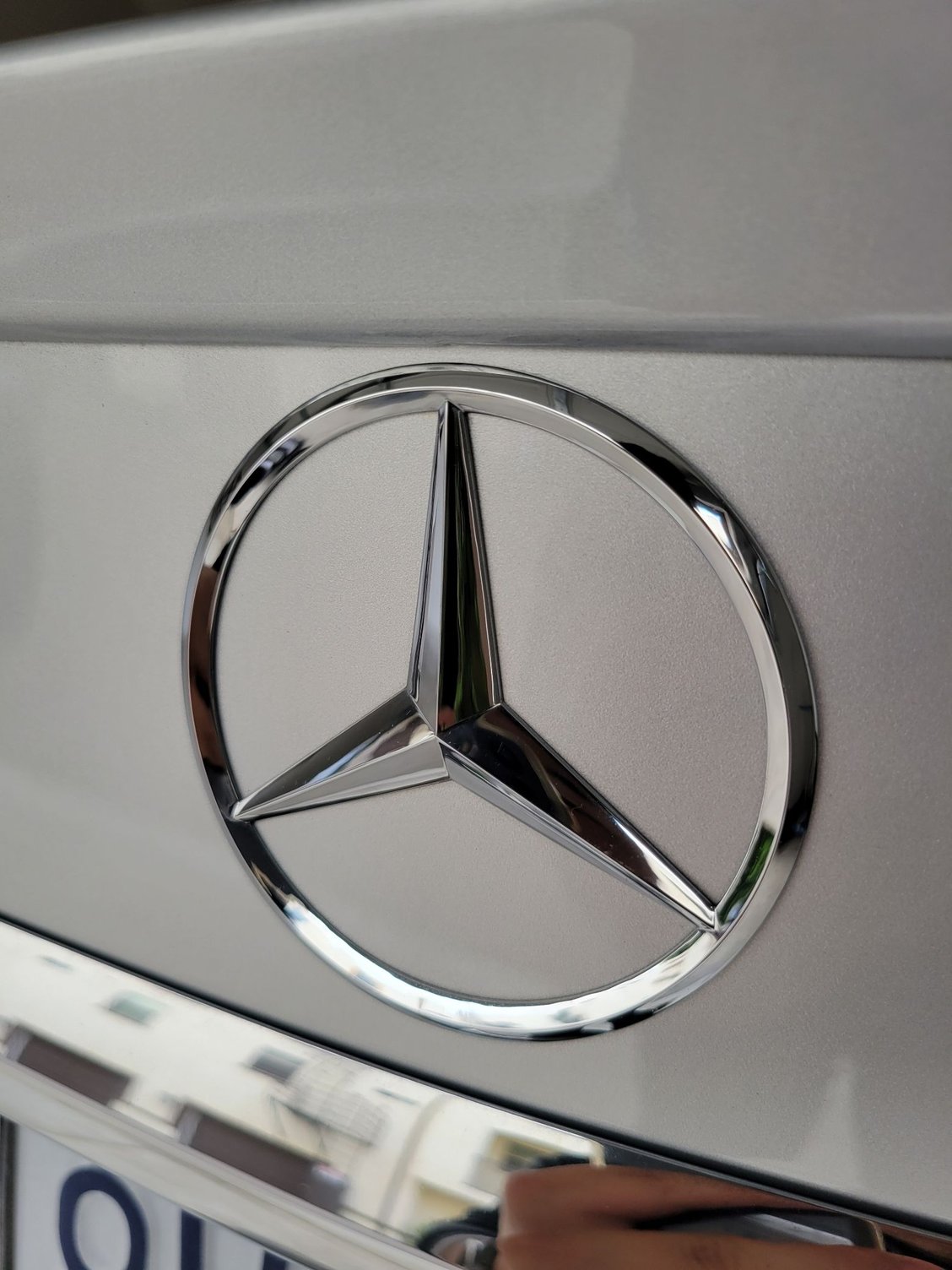

UPDATE: The Meguiar's Cleaner Wax worked!
I tested a small area on the chrome grill with a cotton swab + cleaner wax. It seemed to work in the test area, so I went ahead and applied a small amount and spread it across the grill part with a microfiber. The discoloring/corrosion came right off with a little bit of elbow grease. I wiped it off again with a clean area, per the directions on the bottle. I made sure to rub very lightly and avoid any of the other plastic parts. The results were excellent, looks almost brand new except for the rock chips.
I ended up polishing the Mercedes start on the front and on the trunk while I was at it and I am very happy with the results.
Unfortunately, the white mark on the chrome door trim doesn't seem to respond to cleaner wax. I'm open to any suggestions, but I might let it go since its a small area. Gotta take the victories as they come.
