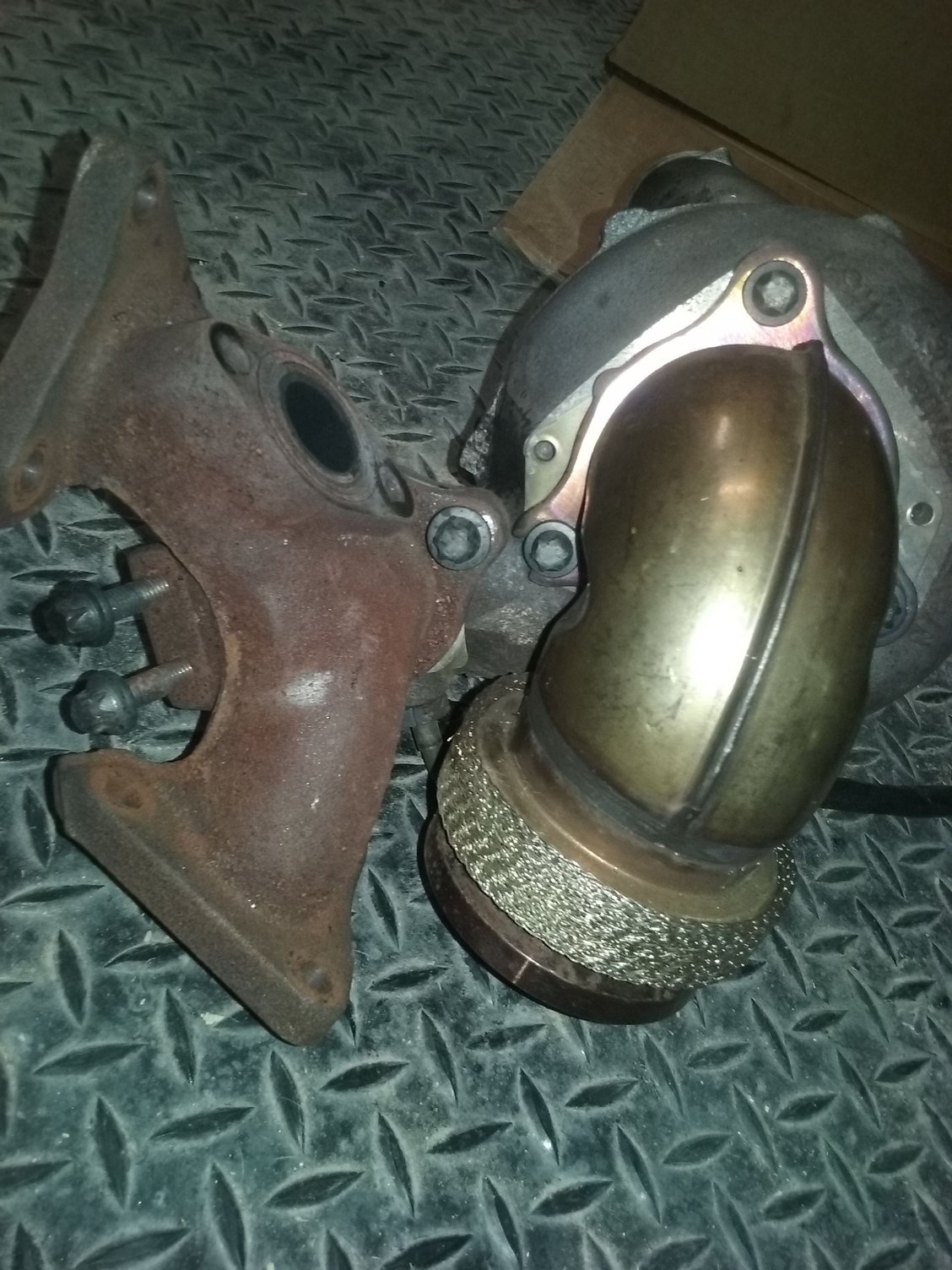

Couple more pictures of turbo showing the mounts. Would be interested to see how mechanics remove turbo from the car, as I - having engine out still had hard time to figure out the puzzle.
So here is how I finally removed the turbo with attached V-pipe from the engine. You can't detach the V-pipe from the turbo before you come to this stage, as the connection has bolts coming from both sides.
Hope somebody can use it in case they go for oil cooler replacement.
