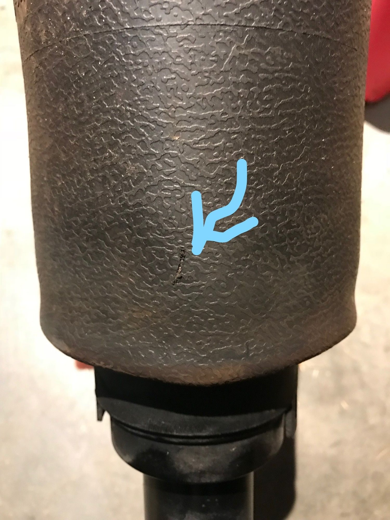

So I'm back!! Back in 2/18 I replaced both front Air shocks with Aronott new replacement. Well on 6/9/18 after a round trip to Fredrick MD, I pull in the driveway turn off truck and I hear air sound from passenger side of car and the shock completely deflates. So I turn car back on, passenger side inflates to drive height, but I still hear air sound. Turn off truck and the passenger side completely deflates. So I have an email into Aronott to get the replacement process. I will update when I hear back. Hoping Doug Doug@arnottinc.com will make quick work of this.

OK. called Aronott today and found that I have to buy the replacement FIRST (468.00). So it's on order and should be here in few day. Should only take about 1.5-2hrs to replace this time. Then I ship the old one back and I get a FULL refund in a few days after they receive the old one. So more updates to follow. The attached video is what I hear after I start the truck let it run for 30/40 sec then turn it off.

Ok, now for the update, I installed the replacement and sent the old one back to Arnott. So far so good.
