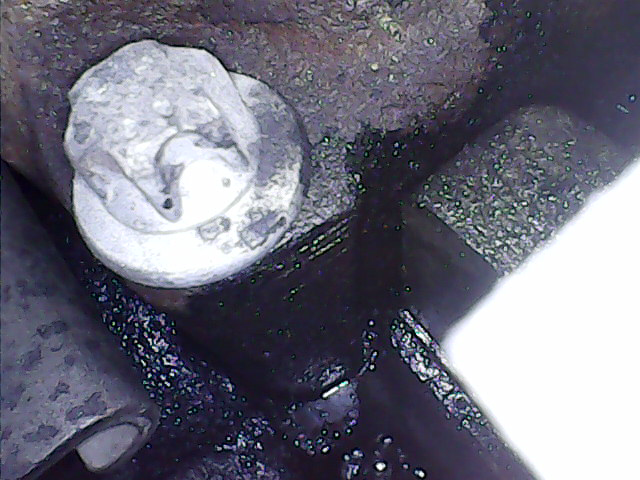

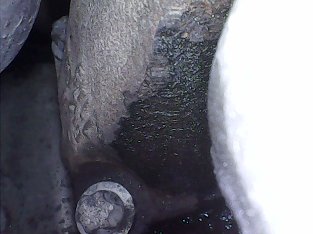

I used an android endoscope camera but could only notice that there is no oil around the front part of the oil cooler (front of engine).....could not see if the rear end of oil cooler had any spilled oil.
I guess I will not advance unless I start removing parts standing in the way....but I'm too lazy for that.
As I see it, oil is still leaking through the new viton oil cooler seals or the turbo pedestal oil seal....can not think of any other cause.

So, did you look down by the torx and look at the pedestal?
